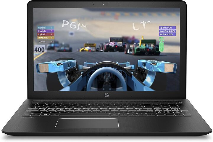

Oh, also I forgot to ask if this would also work on a single display, I figured if that were the case I could use this type of hardware passthrough on a laptop with an iGPU and dGPU..
Mobile CPUs typically don’t have the necessary Virtualisation extensions. Check that first because chances are that will end your endeavour prematurely.
But yes it should work on a single display as far as I understood from the previous videos.
Looks like it does:
I was considering going for this laptop in particular:
Yeah the CPU seems to support it as it seems. Question is then if it can be enabled in the UEFI, if it is then you’re good to go.
That’s a good question, I have no idea myself as far as this laptop goes.
Lets get that NPT bug bounty fund raiser started! :grinning:
