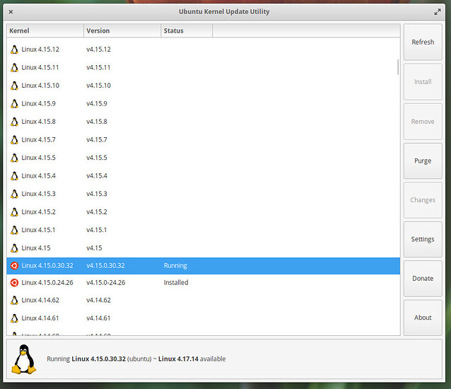

Install UKUU - Ubuntu Kernel Update Utility
sudo apt-add-repository -y ppa:teejee2008/ppa
sudo apt-get update
sudo apt-get install ukuu

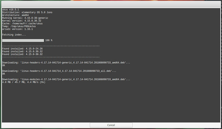

Then start it (should be in your list of installed apps). After it fetches updates you will be given nice window showing all available kernels and also the one you’re running. My installation was on 4.15.30.32
so i decided to YOLO it and install the latest one.
If you won’t be able to boot or will have issues with latest one, you can always boot into older kernel version from GRUB screen or downgrade using UKUU
Select kernell you want to install and press “install”. Gray window should pop out:
After update is complete, text saying Close window to exit will pop up.
REBOOT
after reboot you can open UKUU to make sure you’re running kernel you selected

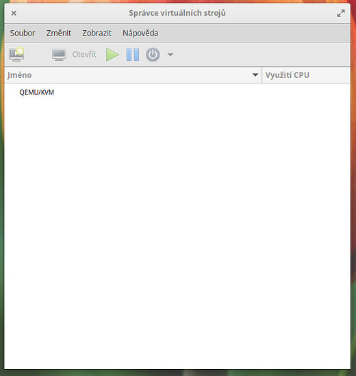

After you rebooted, open virt manager (should be in list of your installed apps). It should start without any error giving you nice tiny window.
If you encounter some errors, just google your way out of it, may be missing some packages or having wrong user rights
(excuse czech language on the screen :D)
you can close it again now, or if you’re bored, you can try running a VM to see if it works without GPU passed to it.

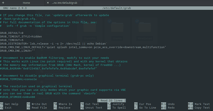

Enable IOMMU in GRUB
Most Linux distros do not enable IOMMU by default.
You will need to update your grub bootloader config to support IOMMU.
sudo nano /etc/default/grub
and add following to the GRUB_CMDLINE_LINUX_DEFAULT line:
A) for Intel CPU:
iommu=pt iommu=1 intel_iommu=on
B) for AMD CPU:
iommu=pt iommu=1 amd_iommu=on
so it looks like this: (in my case, i put amd_iommu, cuz i am on AMD platform)
GRUB_CMDLINE_LINUX_DEFAULT="quiet splash iommu=pt iommu=1 amd_iommu=on"
result:
save file (ctrl + x, y, ENTER) and run:

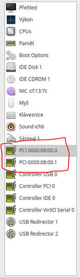

Select PCI Host Device and add your GPU.
Repeat this step to add you’r GPUs AUDIO interface as well
They should be both in your list like so:

Once the kernel is installed, you will now need to edit the grup to use the acs override. In the terminal type the following
pcie_acs_override=downstream,multifunction
sudo update-grub
Reboot and confirm you have your devices are in separate IOMMU groups as described in the section of this guide titled “Check if IOMMU is Working”
Just as a heads up:
The downstream call enables the asc override, and multifunction call forces all components or functions of a PCI device to be assigned to separate IOMMU. The multifunction call is needed if you are passing an Nvida GPU through to your VM. AMD GPUs tend to separate the VGA, Audio and other components of the GPU into separate IOMMU groups by default but with Nvidia they tend to be bunched together. For Pascal (i.e. GTX 10##) and older Nvidia cards this is not an issue for the VM, however with the Turing (i.e. RTX) GPUs the VGA, Audio, USB-C, and USB controller will all be under the same group if the “multifunction” call is not included in your grub default. As a precaution to prevent issues in or booting the VM, I would assign all 4 functions/device IDs of the RTX cards to the VFIO-PCI driver. The USB controller may still say it is using the xhci_hcd driver but it should pass straight though to the VM as a host PCI device.
