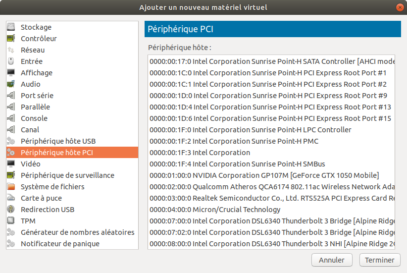

Hello there, very interesting topic.
I arrived here because I thought I had a similar problem in my vfio setup.
I’m using a Dell 9560 with an attached TB3 Akitio Node having inside a recent Nvidia RTX 2060.

The problem is in virt-manager, when I try to “Add hardware” then PCI device, my “0b:00.” does not appear on the PCI hardware list. But the TB3 node is displayed correctly.
The only reason for now I supposed is my graphic card is new, and needs at least WHQL 417.71 driver normally to have the RTX 2060 card details.
If someone with more experience can give an advice here?

You could try editing the libvirt XML to manually add the host devices you want.
virsh edit NameOfVm, go down to the bottom of the devices section, then add in entries as needed. See this page for libvirt xml syntax-
https://libvirt.org/formatdomain.html#elementsHostDevSubsys
You also should use vfio-pci for the 2060 usb and serial controllers(0b:00.2 and 0b:00.3).
