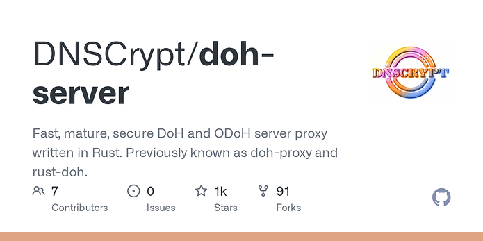

We are going to use the DoH-Proxy software written in rust. Its well supported, fast, mature and secure. I built it from source because I do not like cargo as a solution. You can use the rust compiler to do this. It should all compile nicely on most systems. Or you can use their preferred instructions
chmod +x the executable file wherever you compiled it to make sure it is executable and made a systemd process to start it. Lets make this service run as a user service. There is no reason for it to realistically have root and your systemd process shoud look like:
[Unit]
Description=Rust based DoH-Proxy userland service which starts at boot
After=network.target
[Service]
Type=simple
ExecStart=bash -xc '/home/(username)/<path>/doh-proxy -O -c 20000000 -C 20000000 -l 127.0.0.1:36443 -u 127.0.0.1:13753'
Restart=always
RuntimeMaxSec=5m
[Install]
WantedBy=default.target
