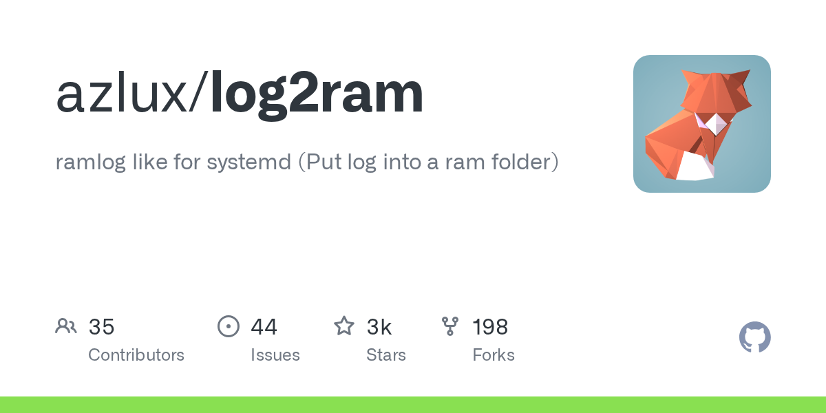

To extend the life of the pi’s, I would suggest moving the logs to Ram:
which reduces the strain on the OS stick.

You might have a look at the link for more ideas:
