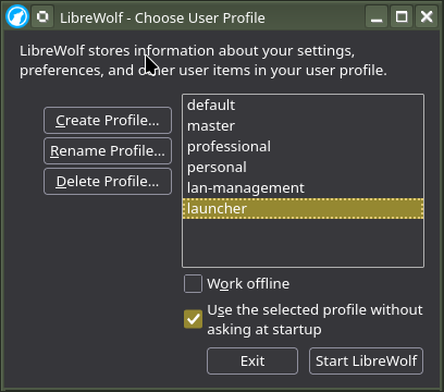

grouping librewolf windows by profile
I have multiple librewolf profiles to allow me to have separate browsing profiles for research and hobbies.
By default, wayland and kde’s window grouping will merge all librewolf windows together.
separating the profiles
If you want to see the config, it is here
I started by asking chatgpt how to add multiple librewolf profiles to launch specific profiles. It suggested I create a profile then apply these home manager configs.
The config worked in setting up new shortcuts from the start menu. After realizing the xdg configs, I decided it would be a good idea to consolidate all my xdg configs into a single place. You can find the file here
Once I got it all consolidated into the xdg file, I then wanted to fix the taskbar to also be separated. Chatgpt suggested I use xwayland, but I wanted to set it up for the long term
While checking the two options, I kept getting a bug where launching the individual profile would always start the choose profile
the solution chatgpt suggested was
This got it working

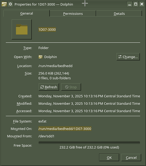

f3 - Fight Flash Fraud
I wanted a linux equivalent of H2testw from windows
based on the suggestions from reddit and ask ubuntu channel
F3 was suggested
Since I didn’t feel like adding it to my config, I ran it in a nix shell
nix-shell -p f3
I then looked for sd card using the volume using the properties to find where it is mounted
After finding the path, I then ran
f3write /run/media/bedhedd/1D07-3000/

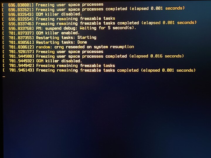

for s in freezer devices platform processors
    echo $s | sudo tee /sys/power/pm_test
    echo mem | sudo tee /sys/power/state
end
echo none | sudo tee /sys/power/pm_test
When I ran the fish version this was the log.
I passed it to chatgpt, and it interpreted it as the first stage working
I rebooted and let it know it had a blinking cursor.
Chatgpt suggested running the following
# Test "platform" only (ACPI/PCIe/GPU handoff)
echo platform | sudo tee /sys/power/pm_test
running sudo tee /sys/power/state caused the system to hang. I decided to hard reboot and get it the output of journalctl -k -b -1 -o short-iso | tail -n 200
I passed this in
chatgpt identified the error as a amd issue

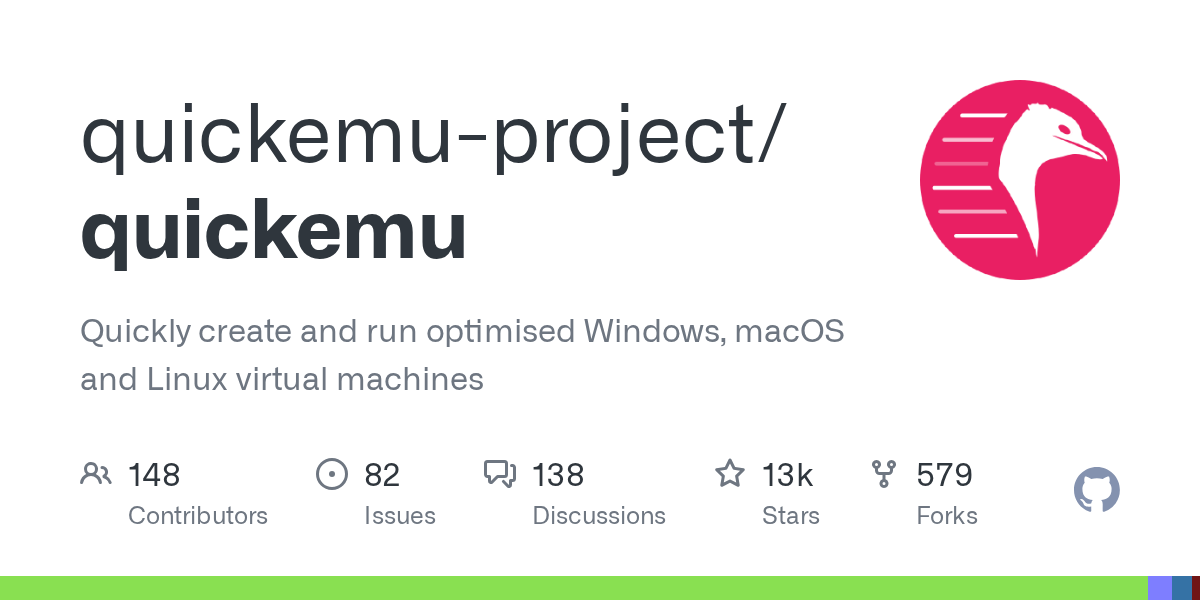

At this point I decided it was more effort to setup virtualbox, so I pivoted to qemu. While reading the the nixos wiki page, I came across the section on quickemu
The wiki setup looked pretty straightforward, so I went ahead and followed the instructions
https://github.com/quickemu-project/quickemu/wiki/01-Installation#nix--nixos
The defaults worked for windows 10, but my xbox controller didn’t show up in the xbox accessories app in windows 10.

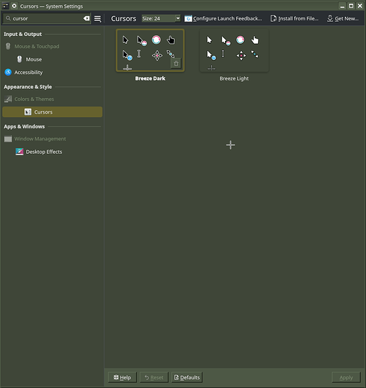

adding custom cursors
I wanted to set a custom cursor so that it is easier to see. Ideally I could just recolor the standard breeze dark cursors. Ultimately I picked teal because when my blue light filter is active, it will look green and be easily visilble on light and dark backgrounds
If you want to skip to the outputs, the following links will lead you to it.
adding the cursors to my config repository
I generated the cursor using these scripts
This commit contains the kde home manager config to apply the cursor
If you are interested in how I got these, I’ll continue
recoloring the cursor
copying the breeze dark dark directory
I started by asking chatgpt where kde cursors are stored. It suggested /usr/share/icons
I checked online and it seems that it lines up
For my case with nix, it is found in /run/current-system/sw/share/icons
ls /run/current-system/sw/share/icons
breeze@  breeze_cursors@  breeze-dark@  Breeze_Light@  default@  hicolor/
To copy it without the permissions to a folder called 00-cursors/breeze-dark
cp -rL --no-preserve=mode,ownership /run/current-system/sw/share/icons/breeze_cursors 00-cursors/breeze-dark
Chatgpt helped in adding the flag --no-preserve=mode,ownership as when I tried cp -rL, I couldn’t delete any files without sudo.

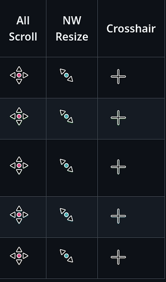

actually recoloring the svgs
After copying the breeze dark directory, I made a copy called breeze-green and had chatgpt write some code to recolor the cursors. Chatgpt gave 2 suggestions: modify the cursor pngs or the svg. With my past experience working with imagemagick for librewolf icons, I decided it would be easier with svgs
I dug around the breeze dark folder and found the svgs within cursors_scalable
It ran but didn’t change the svg file, so I uploaded a sample file
This worked, so to scale it out, I passed the directory as a tree to chatgpt

chatgpt suggested this code
I then had it make the fish version
it worked for a couple, but didn’t work for openhand, so I uploaded the file. Chatgpt realized that there were off colored black, so it modified it. I went through this a couple more cycles until it successfully recolored the most of the cursors
With most of the cursors recolored, I asked chatgpt how to package my files, it suggested using kcursorgen and xcursorgen. I ran the following command in nix shell while in the breeze-green directory
nix-shell -p kdePackages.breeze xcursorgen
kcursorgen --svg-theme-to-xcursor \
  --svg-dir=cursors_scalable \
  --xcursor-dir=cursors \
  --sizes=24,32 \
  --scales=1,1.5,2
it worked so the next step was to package it up so that I could import it into the gui
chatgpt suggested I go up to the root and run the following command
tar -czf Breeze-Green.tar.gz Breeze-Green
With that working, I had chatgpt wrap it up as as python script. I also had it make a cli prompt for a user to run.
To expand the colors for all scroll resize, and cross hair. I uploaded the svgs and had chatgpt find out why they weren’t getting recolored
turns out they used a different color so it was a matter of updating the colors list and recoloring gradients
This is the final script
making a better preview

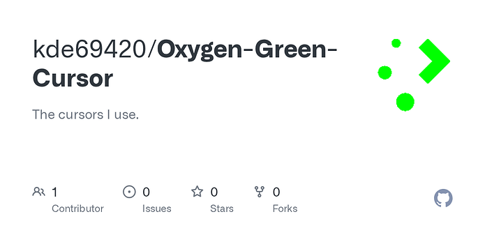

While browsing other cursors, I realized I should have a preview table
As the oxygen repo didn’t have one and made you open the kde store to look at them
I looked at the preview and found the equivalent svg files
/breeze-dark/cursors_scalable/default/default.svg
/breeze-dark/cursors_scalable/progress/progress-01.svg
/breeze-dark/cursors_scalable/wait/wait-01.svg
/breeze-dark/cursors_scalable/hand1/pointer.svg
/breeze-dark/cursors_scalable/5c6cd98b3f3ebcb1f9c7f1c204630408/help.svg
/breeze-dark/cursors_scalable/ibeam/text.svg
/breeze-dark/cursors_scalable/all-scroll/all-scroll.svg
/breeze-dark/cursors_scalable/nw-resize/size_fdiag.svg
/breeze-dark/cursors_scalable/cross/crosshair.sv
I had chatgpt code up a script to crawl through 00-cursors directory and generate a markdown table that has the name, the hex color used, and a preview of the svgs
