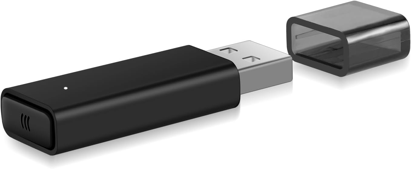

I got some xbox controllers and a dongle recently as I noticed that I was hitting the max pairing limit on bluetooth on my steam deck.
I bought this dongle because it was small and supported by Microsoft
With the Xbox Wireless Adapter for PC, experience the advanced precision and comfort of your Xbox Wireless Controller on Windows 10 PCs, laptops, and tablets. Use it with PC games, and Xbox One games streamed to Windows 10, to elevate your game...
$17.99
In terms of setup, this guide + script was super straight forward and helpful getting it setup. It also should work with arch distros too
