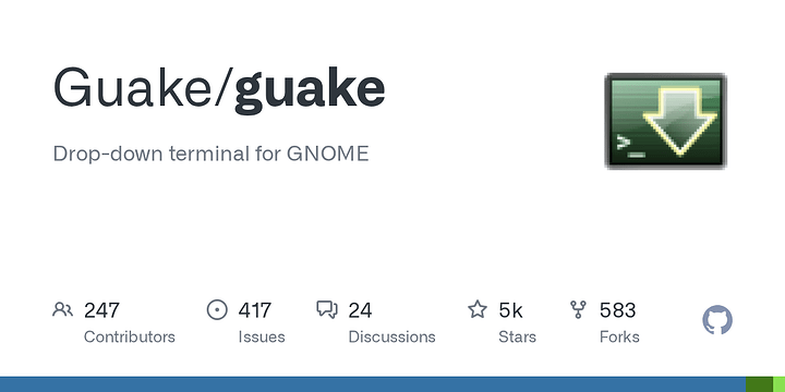

Controversy aside, I also had a issue with guake not working properly on fedora with wayland. The window would be out of place.

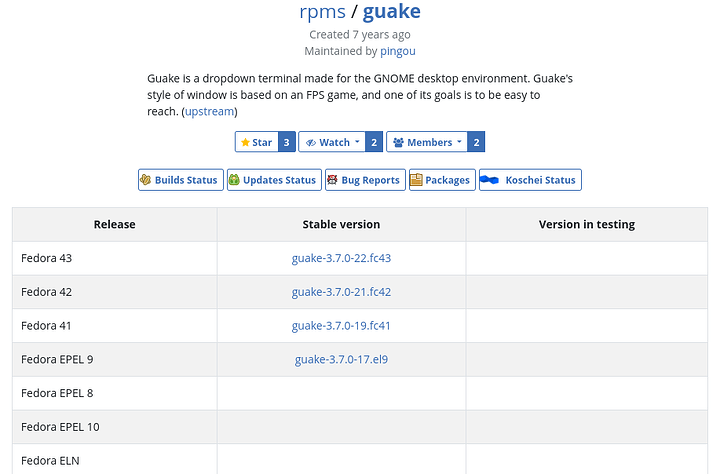

Turns out my issue was solved in a newer version that fedora did not update in the package repo
the rpm is still on version 3.7.0
https://src.fedoraproject.org/rpms/guake

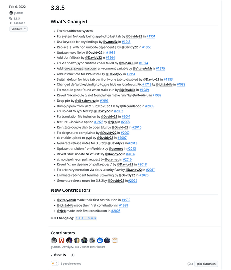

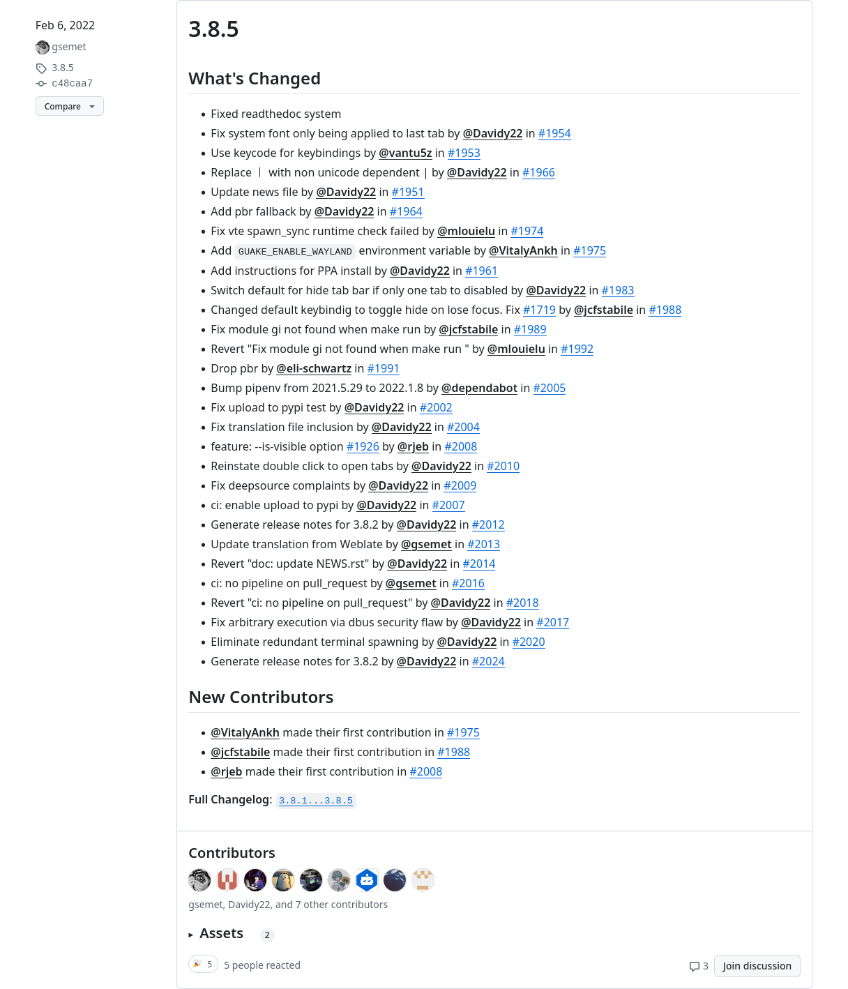

if we look at the github releases, 3.8.5 has wayland fixes and the latest is 3.10.0

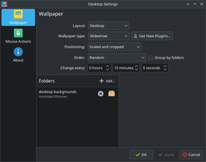

automount my mass storage drive and symlink with home
I asked chatgpt to help me create a entry for automounting my drive. It started by telling me to run
lsblk -f
NAME        FSTYPE FSVER LABEL       UUID                                 FSAVAIL FSUSE% MOUNTPOINTS
sda
└─sda1      btrfs        MassStorage 027f2550-4813-20d9-ac54-fc87dc4612eb    2.4T
To get the drive’s uuid. After giving the output, it suggested the following entry
  fileSystems."/mnt/sda1" = {
    device  = "/dev/disk/by-uuid/027f2550-4813-20d9-ac54-fc87dc4612eb";
    fsType  = "btrfs";
    # Fine-tune options to taste.  Good defaults for a personal btrfs data disk:
    options = [
      "compress=zstd"    # transparent compression
      "noatime"          # don’t update atime on every read
      "ssd"              # if the drive is actually an SSD
      # For a plug-in USB disk add:
      # "noauto" "x-systemd.automount"
I then asked it to help me create a symlink for my Documents, Downloads, Music, Pictures, and Videos folders.
chatgpt gave this output
  fileSystems."/home/youruser/Documents" = {
    device  = "/mnt/sda1/Documents";
    fsType  = "none";            # ← required for bind mounts
    options = [ "bind" ];
    depends = [ "/mnt/sda1" ];   # be sure the disk is mounted first
Chatgpt cited these two sources
https://superuser.com/questions/1271645/how-do-you-declare-a-bind-mount-in-nixos
https://nixos.wiki/wiki/Filesystems
I think it used the older nixos.wiki because when i checked the newer wiki it removed the fsType
the newer wiki omits the fsType
So I ended up using this config
  fileSystems."/home/bedhedd/Documents" = {
  fileSystems."/home/bedhedd/Downloads" = {
    device  = "/mnt/sda1/Downloads";
  fileSystems."/home/bedhedd/Music" = {
    device  = "/mnt/sda1/Music";
  fileSystems."/home/bedhedd/Pictures" = {
    device  = "/mnt/sda1/Pictures";
  fileSystems."/home/bedhedd/Videos" = {
    device  = "/mnt/sda1/Videos";

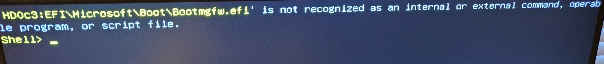

add windows drive as a boot option to boot options
I added the following entry
  # Bootloader.
  boot.loader = {
    systemd-boot.enable = true;
    efi.canTouchEfiVariables = true;
    # ONE line β†’ menu entry called β€œ11” pointing at fs2:
    systemd-boot.windows."10".efiDeviceHandle = "FS2";
when I used this config, it booted me into
  boot.loader = {
    systemd-boot = {
      enable = true;
      # helper to find the handle: set edk2-uefi-shell.enable = true,
      # rebuild, boot the shell, run  `map -c`, then `ls HD0c3:\EFI`
      windows."11" = {
        title           = "Windows 11";
        efiDeviceHandle = "HD0c3";   # whatever handle lists the Microsoft dir
        sortKey         = "o_windows";
this shell
after some further debugging with chatgpt I found out I could use
Shell> map -r -b
to get the device alias. I tested it by running the following command
Shell> fs2:
fs2:\> dir EFI
Once I am in the directory, I verified that the microsoft and boot folders were there. Then I had chatgpt update the entry
update nix os repo instructions
I added highlevel steps based on my experience working on this

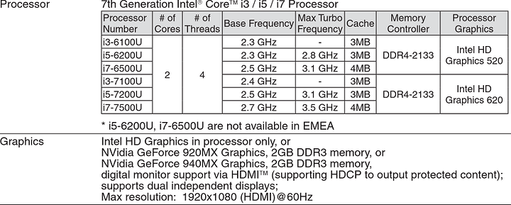

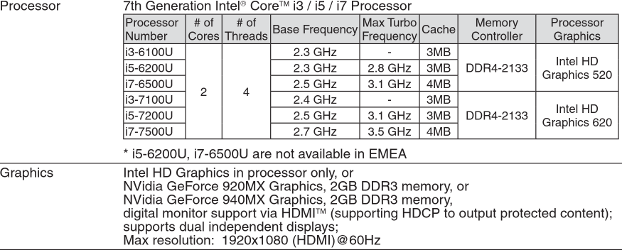

After that I decided to get my nvidia 950m working. I found that the suggested nixos-hardware was the solution
Fortunately for me it turns out the lenovo think pad e470 had the same setup as my laptop.
https://www.lenovo.com/us/en/p/laptops/thinkpad/thinkpade/thinkpad-e470/22tp2tee470
I had to check if the 7500u was kaby lake because the name didn’t look right
https://www.intel.com/content/www/us/en/products/sku/95451/intel-core-i77500u-processor-4m-cache-up-to-3-50-ghz/specifications.html
so it was as simple as adding a import

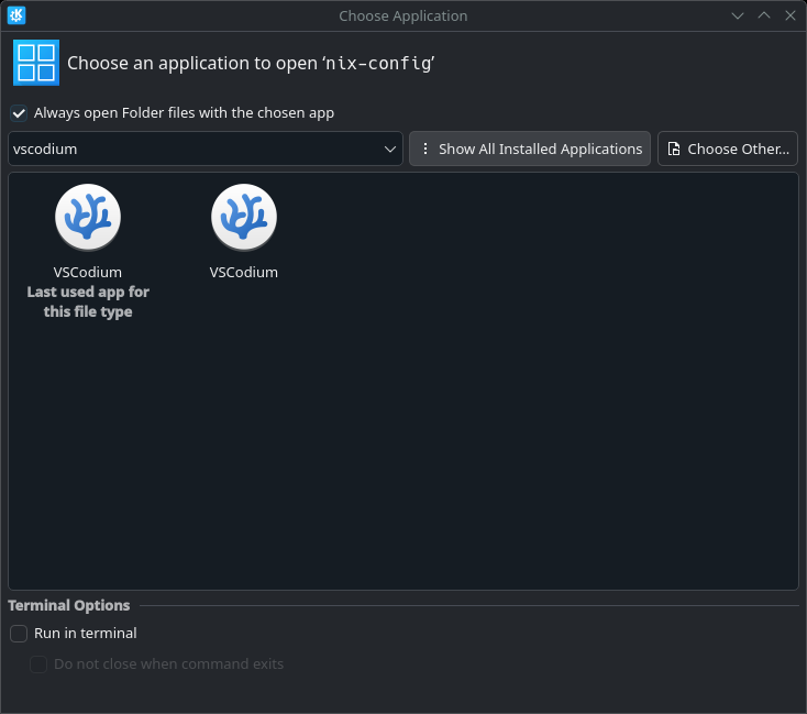

I use vscodium for development projects. A feature that saves me time is opening a project directory from the file explorer with vscodium.
By default in nix and kde, I could click the checkbox Always open Folder files with the chosen app and the app would get added.
However, it did not remember between sessions.
I got it working using this entry in plasma manager
If you want to view the other changes I made, the commit is here
how I figured it out with chatgpt

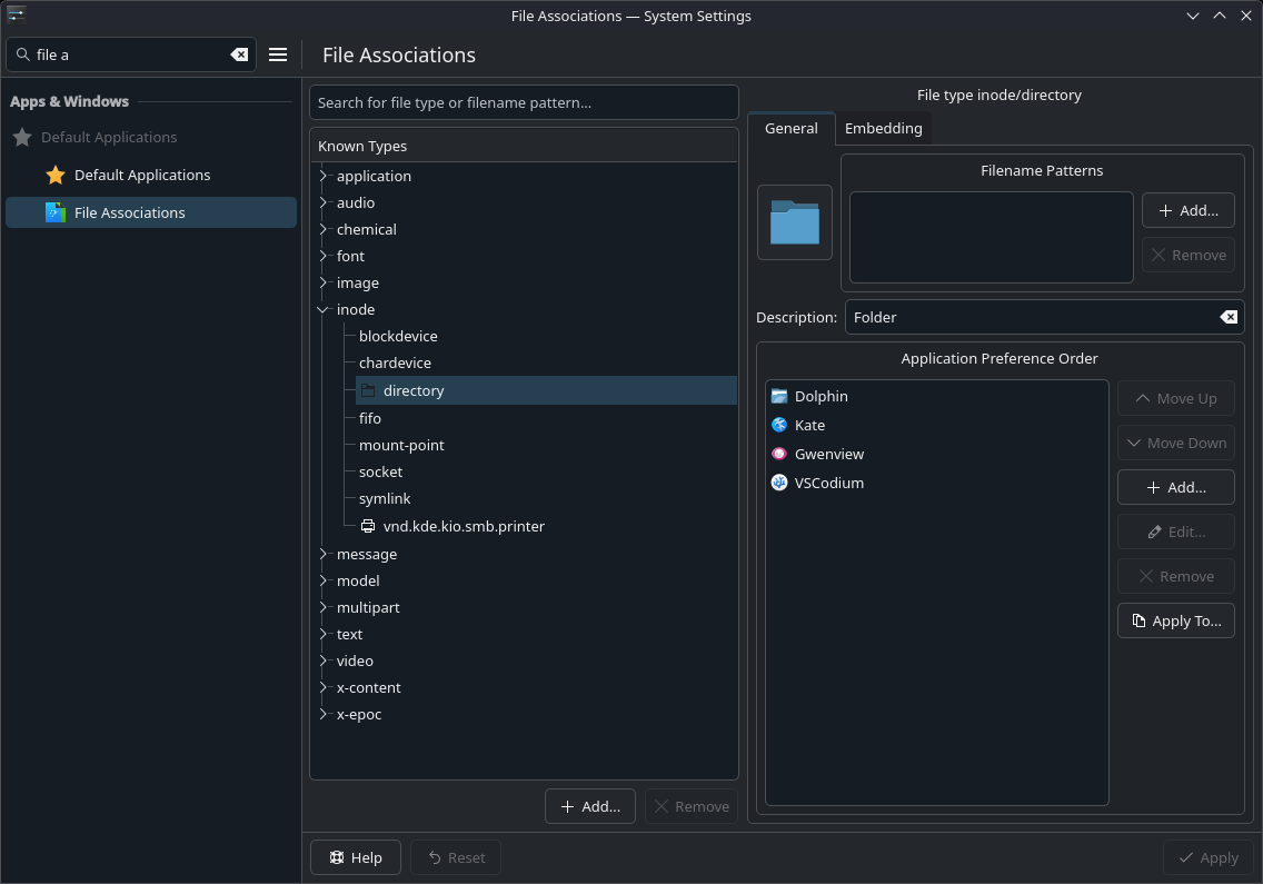

I started by configuring it using the settings menu.
Afterwards I asked chatgpt how to find the configuration. Chatgpt suggested I use
gio mime inode/directory
Default application for β€œinode/directory”: org.kde.dolphin.desktop
Registered applications:
        org.kde.kate.desktop
        org.kde.gwenview.desktop
Recommended applications:
 xdg-mime query default
inode/directory

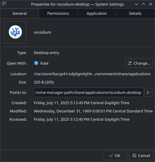

However, vscodium didn’t show up. Chatgpt suggested this snippet
  xdg.desktopEntries.vscodium-folder = {
    name        = "VSCodium (Folder)";
    genericName = "Source-code Editor";
    exec        = "codium %F";
    icon        = "codium";
    mimeType    = [ "inode/directory" ];
    categories  = [ "Utility" "Development" "TextEditor" "IDE" ];
    terminal    = false;
It worked, but I wanted to use the vscodium icon. After some further debugging to figure out where the vscodium icon is stored. The breakthrough was to attach a screenshot of the vscodium entry
Chatgpt then suggested I run this command
grep '^Icon=' /nix/stor
e/*codium*/share/applications/codium.desktop
Icon=vscodium
Icon=vscodium
I was able to add the entry vscodium to use the icon as well

getting synced wallpapers for desktop and lock screen
The last thing I wanted was to have my kde cycle through a directory of desktop backgrounds.
I started by asking chatgpt, but it wanted to use a custom xdg config entry. I then had it look it up instead.
It suggested this, but I wanted it to integrate back into my existing config
# modules/kde-home.nix
{ config, lib, pkgs, plasma-manager, ... }:
let
  wpDir = "/home/${config.home.username}/Pictures/desktop-backgrounds";
in {
  programs.plasma = {
    enable = true;
    overrideConfig = true;
    # Desktop slideshow (Plasma Manager "workspace" module)
    workspace.wallpaperSlideShow = {
      path     = wpDir;   # can be a string or a list of dirs
      interval = 900;     # seconds = 15 minutes
      # optional:
      # randomize = true;
      # fillMode  = "zoom";  # other values include: "fit", "stretch", "center", etc.
    # Lock screen slideshow (Plasma Manager "kscreenlocker" module)
    kscreenlocker.appearance.wallpaperSlideShow = {
      path     = wpDir;
      interval = 900;
      # randomize = true;
Chatgpt based it on the following appendix items from plasma manager
wallpaper: Appendix A. Plasma-Manager Options
lockscreen: Appendix A. Plasma-Manager Options
programs.plasma.workspace.wallpaperSlideShow
    Submodule for configuring the wallpaper slideshow. Needs a directory with wallpapers and an interval length.
    Type: null or (submodule)
    Default: null
    Example: { path = "${pkgs.kdePackages.plasma-workspace-wallpapers}/share/wallpapers/"; }
    Declared by:
    <plasma-manager/modules/workspace.nix>
programs.plasma.workspace.wallpaperSlideShow.interval
    The length between wallpaper switches.
    Type: signed integer
    Default: 300
    Declared by:
programs.plasma.kscreenlocker.appearance.wallpaper
    The wallpaper for the lockscreen. Can be either the path to an image file or a KPackage.
    Type: null or absolute path
    Default: null
    Example: "${pkgs.kdePackages.plasma-workspace-wallpapers}/share/wallpapers/Kay/contents/images/1080x1920.png"
    Declared by:
    <plasma-manager/modules/kscreenlocker.nix>
This works if I only had a single monitor, but for multi-monitor setups it doesn’t ensure that the same image is on every monitor. I asked chatgpt to look for a way to synchronize it across all monitors. It came up with some javascript and a systemd user timer to make a slideshow
after building the config and getting it working smoothly, I committed it to my repo

bind guake toggle window to super + `
Once I got unbound kde, I had chatgpt come up with the entry for guake. I fed it my guake module and this was a entry it suggested to the dconf.settings dictionary
    "org/guake/keybindings/global" = {
      show-hide = "<Super>grave";
see the full context here
commit is here

  wpDir        = "${config.home.homeDirectory}/Pictures/desktop backgrounds";
  intervalS    = 900; # seconds between wallpaper changes (sync cadence)
  # Script: pick frame deterministically and set same image on ALL desktops
  syncWallpapers = pkgs.writeShellScriptBin "sync-wallpapers" ''
    set -euo pipefail
    DIR=${lib.escapeShellArg wpDir}
    INTERVAL=${toString intervalS}
    # Collect images (stable order)
    mapfile -t FILES < <(${pkgs.findutils}/bin/find "$DIR" -type f \
      \( -iname '*.jpg' -o -iname '*.jpeg' -o -iname '*.png' -o -iname '*.webp' \) \
      | ${pkgs.coreutils}/bin/sort)
    [ "''${#FILES[@]}" -gt 0 ] || exit 0
    now=$(${pkgs.coreutils}/bin/date +%s)
    idx=$(( (now / INTERVAL) % ''${#FILES[@]} ))
    img="''${FILES[$idx]}"
    # Plasma JS: set same static image on every desktop
    js='var ds = desktops();
        for (var i = 0; i < ds.length; ++i) {
          var d = ds[i];
          d.wallpaperPlugin = "org.kde.image";
          d.currentConfigGroup = ["Wallpaper","org.kde.image","General"];
          d.writeConfig("Image", "file://'"$img"'" );
    ${pkgs.qt6.qttools}/bin/qdbus org.kde.plasmashell /PlasmaShell org.kde.PlasmaShell.evaluateScript "$js"
  # Read your repo JSON, normalize to a single-line JSON string
  kzLayouts = builtins.toJSON (builtins.fromJSON (builtins.readFile ../dotfiles/xiphergrid2_kzones.json));
in {
  programs.plasma = {
    enable = true;
    workspace.lookAndFeel = "com.valve.vgui.desktop";
    # IMPORTANT: Do NOT use Plasma's slideshow for the desktop; our timer drives it.
    workspace.wallpaper =
      "${pkgs.kdePackages.plasma-workspace-wallpapers}/share/wallpapers/Patak/contents/images/1920x1080.jpg";
    # Lock screen can keep using slideshow (independent of desktop sync)
      path     = wpDir;
      interval = intervalS;

  # VSCodium desktop entry override
  xdg.desktopEntries.vscodium = {
    name        = "VSCodium";
    exec        = "codium %F";
    icon        = "vscodium";
    terminal    = false;
  # MIME associations
  xdg.mimeApps = {
    enable = true;
    associations.added."inode/directory"  = [ "vscodium.desktop" ];
    defaultApplications."inode/directory" = [ "org.kde.dolphin.desktop" ];
Which I applied and what you’ll see for the final config
