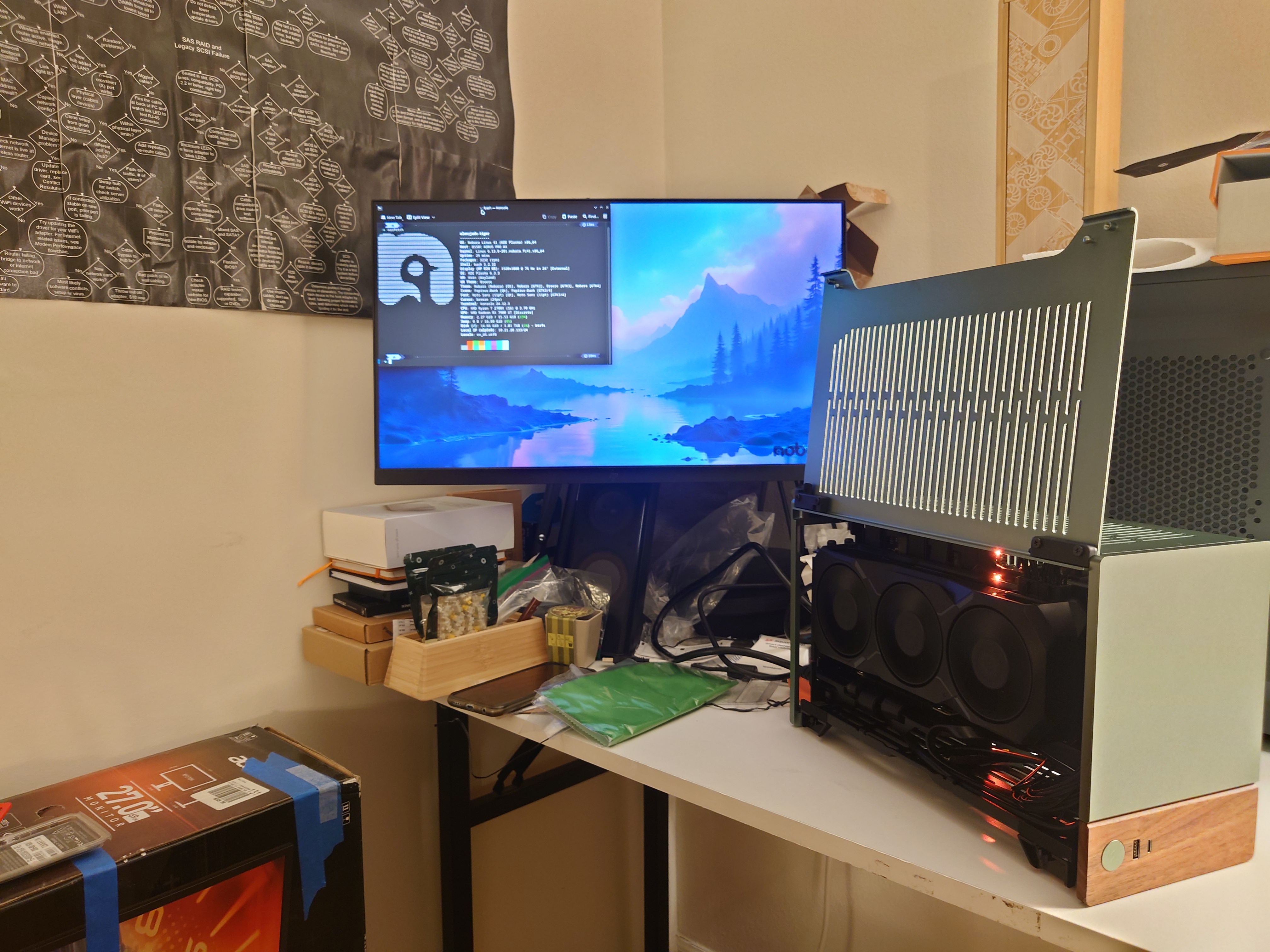

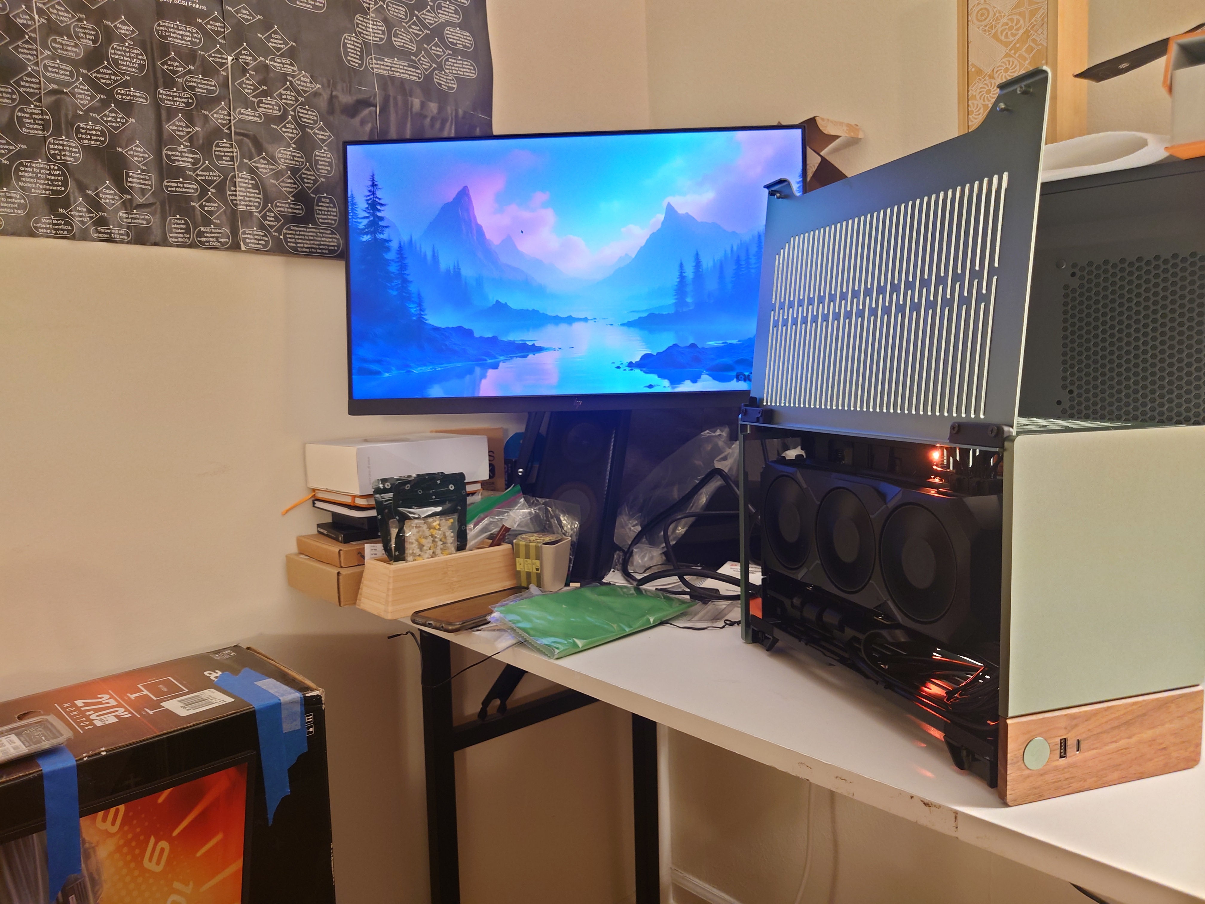

I recently built a computer for my dad who wants to get into local llms.
I wanted to write this post so that if I have to fix his computer, I have a reference of how I configured it. Also this was a great excuse opportunity to learn about nix. If the experience is good, I might migrate from Fedora.
Stick around to see my updates

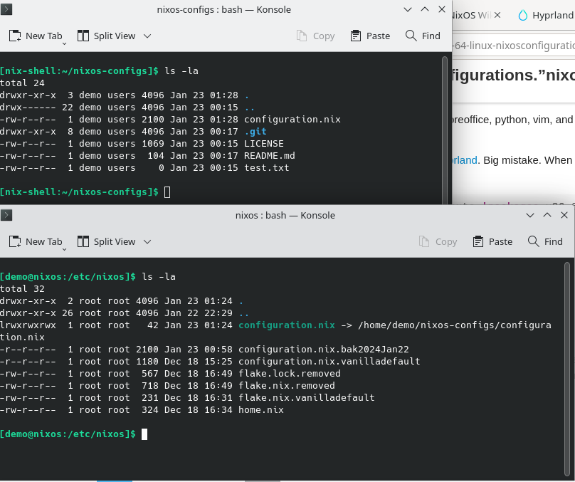

linking a custom configuration with git for version control
One of the benefits mentioned by the nix videos is the ability to use version control to manage packages
This was a good guide
modifications to these instructions
  • I structured my directory to follow one similar to this example
  • I made the git repo within my nix-config in my Documents folder. I plan to expand by making sub folders configurations for their own machines.
  • I moved the hardware-configuration.nix to the folder as well
  • I ran the ls -la to get my account name for the chown command for configuration.nix and hardware-configuration.nix

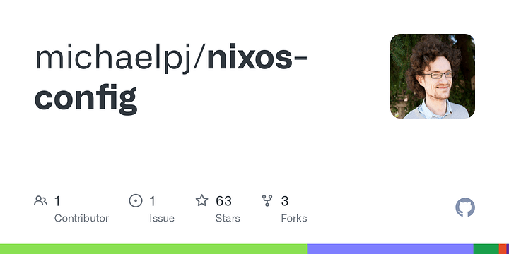

This is great, but there are too many configurations + repo structures.
I’m going to follow this guide because they have a video of getting a repo setup

    • structure flake to be similar to michaelpj’s config
      • copied their modules folder and home.nix, home-manager.nix, and entertainment.nix

michael’s home.nix config has the following line section for bash, I want to change it so that fish is the default shell for all users
  programs = {
    home-manager.enable = true;
    direnv.enable = true;
    bash = {
      enable = true;
      initExtra = builtins.readFile ../dotfiles/.bashrc;
    tmux = {
      enable = true;
      keyMode = "vi";
      extraConfig = builtins.readFile ../dotfiles/.tmux.conf;
I initially tried to use chatgpt, to modify michael’s config + the nix wiki documentation on fish. It worked in adding a entry to homemanager, but failed to get fish to autostart.
https://nixos.wiki/wiki/Fish#Home_Manager
The nix wiki has the following for fish and home manager
Michael’s config didn’t had home manager configure it by the system, so I couldn’t copy paste the wiki entry. Furthermore, I wanted fish at the system level. Finally I needed comment out grc from the plugins list because it didn’t not exist in my NixOS version of 22.05

I wanted my amd gpu to increase the refresh rate for kde and wayland
Didn't work my display is locked at 30hz
https://www.old.reddit.com/r/NixOS/comments/1e81ait/comment/le4h0ym/
I edited my configuration.nix for the machine.
{ config, pkgs, nixos-hardware, home-manager, ... }:
  imports =
      nixos-hardware.nixosModules.common-gpu-amd
      ./hardware-configuration.nix
      home-manager.nixosModules.home-manager
      ../../modules/home-manager.nix
However I couldn’t use the <nixos-hardware/common/gpu/amd/default.nix> because I used flakes. With the help of chatgpt and websearch I was able to use the correct import of nixos-hardware.nixosModules.common-gpu-amd.
Before that, I tried nixos-hardware.nixosModules.gpu.amdgpu, but threw errors when I tried to rebuild.
sudo nixos-rebuild switch --flake .
warning: Git tree '/home/admin/Documents/nix-config' is dirty
error:
       … while calling the 'seq' builtin
         at /nix/store/zd0x43g1jcav0xy0k6q9pdhy3bvif77n-source/lib/modules.nix:358:18:
          357|         options = checked options;
          358|         config = checked (removeAttrs config [ "_module" ]);
          359|         _module = checked (config._module);
       … while evaluating a branch condition
         at /nix/store/zd0x43g1jcav0xy0k6q9pdhy3bvif77n-source/lib/modules.nix:294:9:
          293|       checkUnmatched =
          294|         if config._module.check && config._module.freeformType == null && merged.unmatchedDefns != [ ] then
          295|           let
       (stack trace truncated; use '--show-trace' to show the full, detailed trace)
       error: attribute 'gpu' missing
       at /nix/store/5jd3hfmz4v1r23x3c5638cz156rvhh35-source/machines/jade-tiger/configuration.nix:10:7:
            9|     [
           10|       nixos-hardware.nixosModules.gpu.amdgpu
           11|       ./hardware-configuration.nix
Fortunately chatgpt found this post
https://old.reddit.com/r/NixOS/comments/18m67ew/too_stupid_to_figure_out_how_to_use_nixoshardware/ke282nh/
I’m stuck. Does anyone know how to fix this bug?
I’m using Wayland, I have Kernel 6.14.1. No amount of tweaking has fixed this
