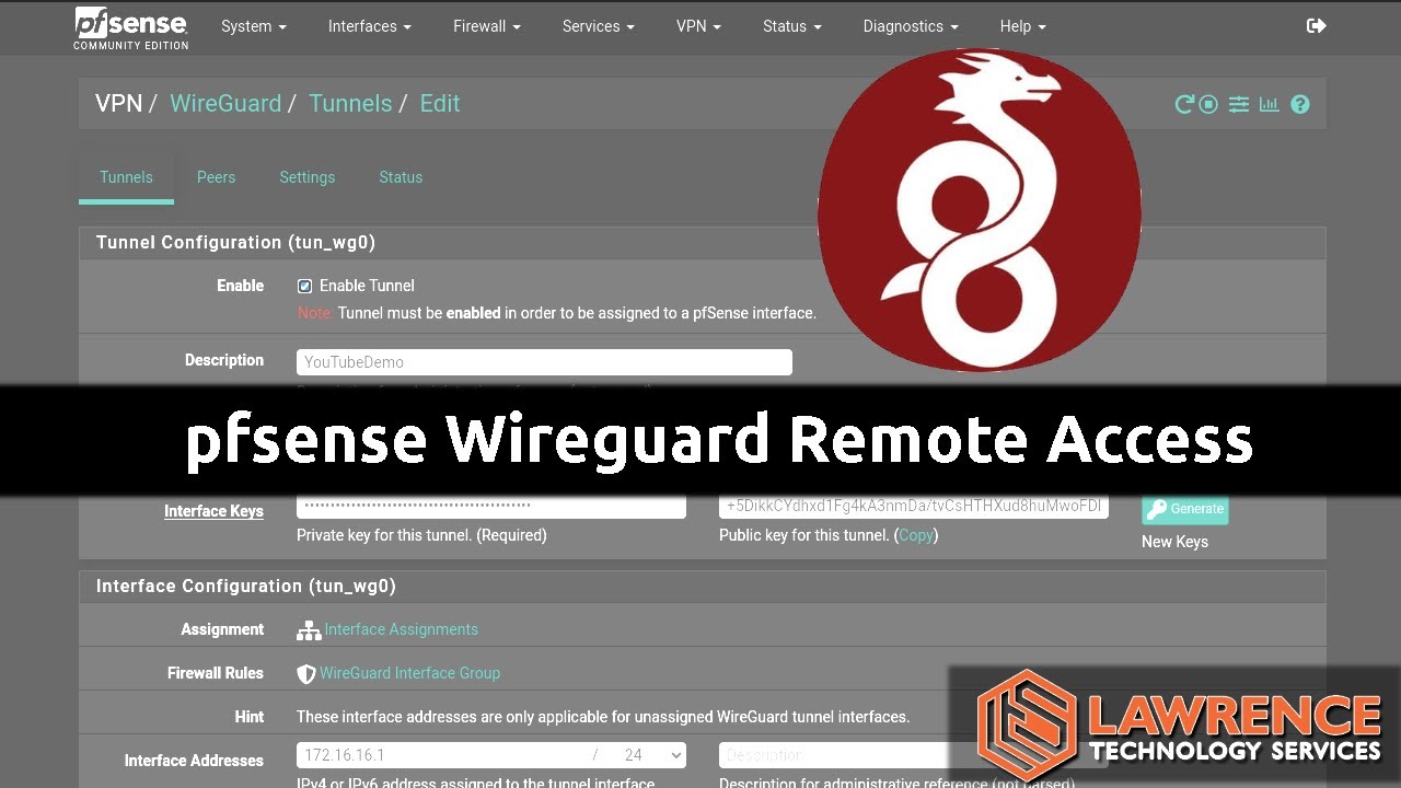

  • Wireguard as a server or client on your Home Router (pfSense)
  • Wireguard, as a server or client, on your NAS (Truenas Scale or Core)
If you have done other Level1Techs tutorials going back to the beginning of time, you know we’re big fans of building your own router because of the flexibility and experience that gives you. It is a good learning exercise.
Tom at Lawrence systems did a more recent video on setting up pfSense with Wireguard and you should check that out:
