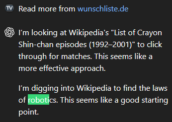

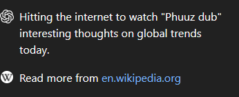

I recently tested out ChatGPTs “deep research” feature with, what I assumed would be, a challenging but not insurmountable task.
I had 2 websites that hosted episode lists of a cartoon show.
One with the German episode numbers, titles and plot synopses, the other website with the English episode numbers, titles and plot synopses.
Cartoons, especially ones without an overarching story, where episodes are almost always standalone, were often released in a different order in German. Season 1 for the German release might contain a smattering of episodes from seasons 1, 2, 3 and 4 of the original English release, etc.
I asked ChatGPT 4o, with deep research enabled, to create a mapping table between the German and English releases, with the columns “German episode number”, “German title”, “corresponding English episode number”, “corresponding English title”.
I also included the information, that the title translations are not word for word, literal translations of the English titles, and that it should try to match them based on the plot synopses, rather than just the title,
After 10+ Minutes of “deep research” I got a mapping table that literally just mapped German episode 1 with English episode 1, German episode 2 with English episode 2, etc.
I tried again, telling it to only do it for German Season 2, since I had already mapped Season 1 manually, and this time I got nonsense hallucination episode numbers and titles. Titles that sounded plausible, but didn’t actually exist.
Out of curiosity I asked my 10 year old nephew, whose English isn’t that great, to try and do it, and he did 3 episodes successfully before getting too bored. So I’m assuming that most 14-15 year old interns could do this task quite successfully.
Maybe I’m just getting jaded, or old and cranky, but Open AI is advertising this “deep research” as an agentic capability that can handle complex tasks. Yet it completely fails on something that literal kids can do.

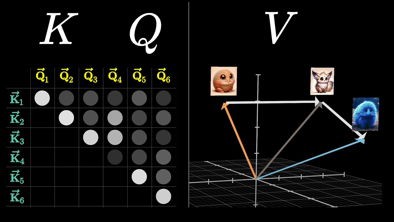

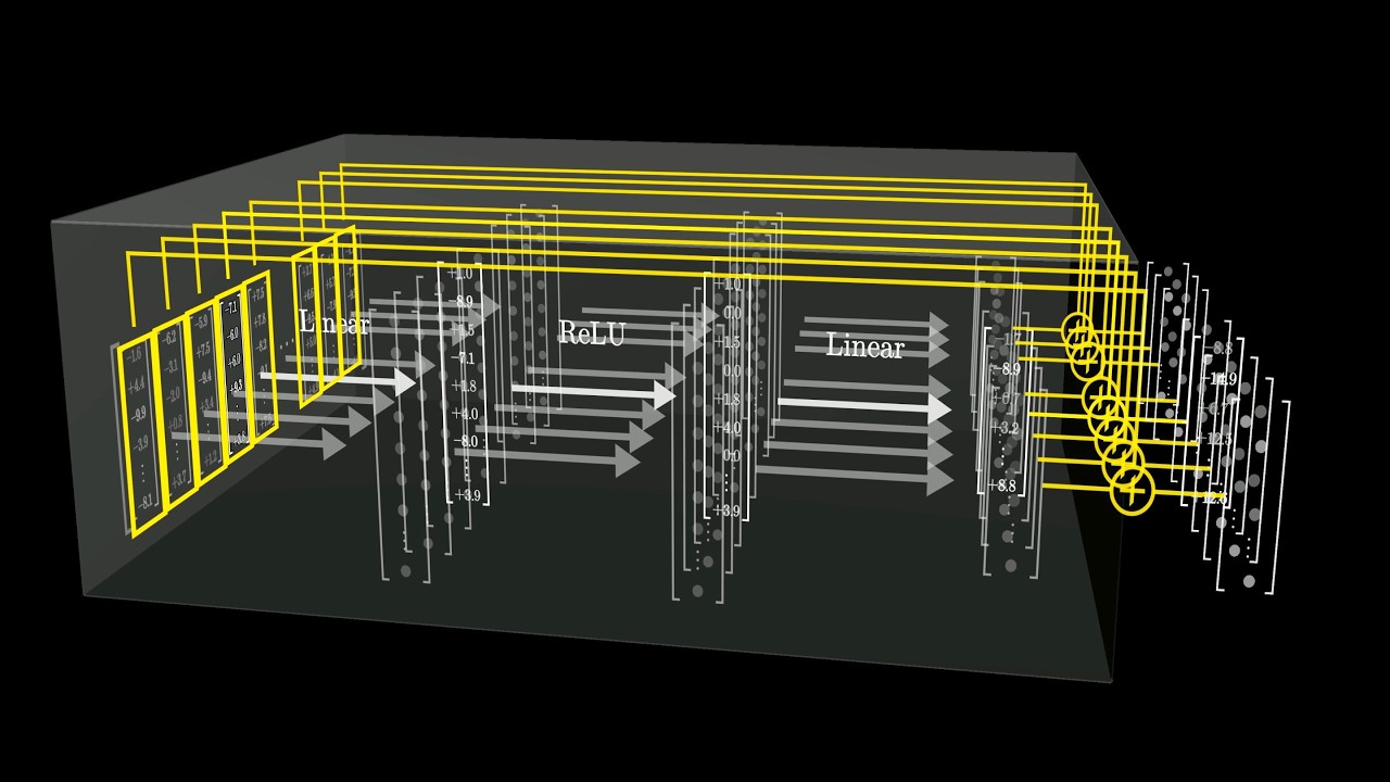

If you’re a software engineer and took a Machine Learning class back in college/university, and you remember the Back Propagation Algorithm (you don’t have to remember how it works, just that it exits), 3Blue1Brown does a really great set of videos on modern LLMs:
These are some of the best videos I’ve seen that explain how tokens are mapped in this very large matrices, and how those are used for next word (really next token) prediction.
If you don’t know what neural networks are, the previous videos in the series can get you up to speed (although his explanation of the Back Propagation Calculus is way more complicated than the one I remember).

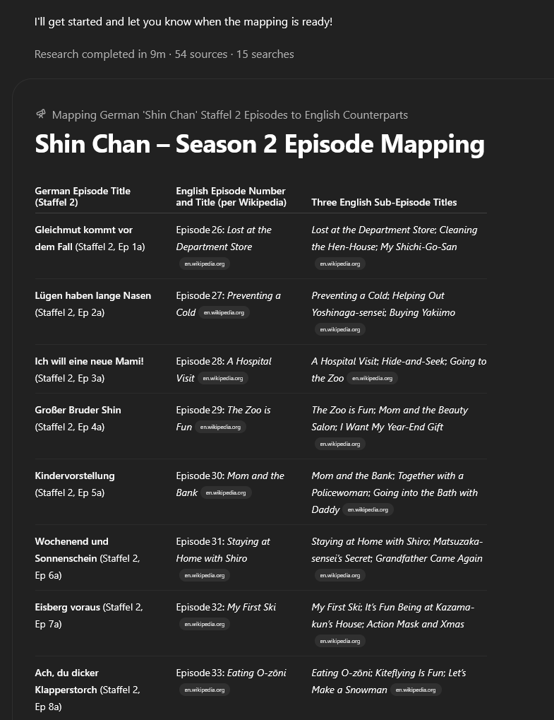

You got pretty much the same output, that I got from ChatGPT in deep research mode.
It doesn’t realize that 1.01a is Season 1, Episode 1, Subepisode 1 and that it should group 1.01a, 1.01b and 1.01c into one episode. So it starts to match subepisode 1 of episode 1 with all 3 subepisodes of the first english release.
And then your result also has the exact same behaviour, where it simply matches German episode 1 with english episode 1, german episode 2 (or what it thinks is episode 2, in reality it is episode 1, subepisode 2) with english episode 2, etc.
Here is a screenshot from the output of ChatGPT for Season 2:
It starts at episode 26, because the first season of the german release has 25 episodes, but it does the exact same thing. It matches them 1:1 instead of doing the actual task, reading the synopses and making sure the plot matches.
I also have no idea how or why it started researching the laws of robotics while looking up shin-chan episodes:
Or what interesting global trends it can discover in a cartoon show from the 90s:
