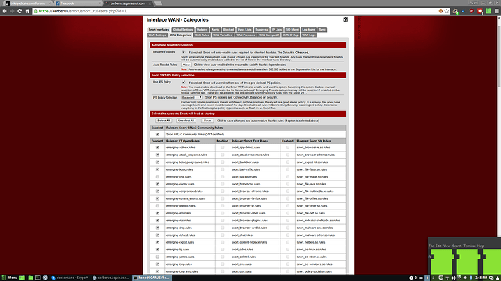

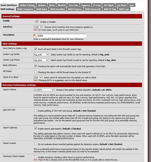

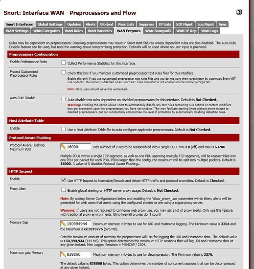

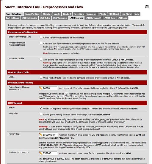

I wanted to get everyone’s opinion on my PFsense/Snort setup. Its my first rodeo for an IPS so be gentle.
My primary goal is to have others ok this setup for best practices/best configurations, I have used snort guides on the net but some are outdated at this point and several heads are better than one right?
The blotted images are private IP addresses on the logs page. My main concern is that there are large amounts of alert events but not all IP addresses get blocked, which worries me that whatever probing they are preforming is getting through or not being stopped by Snort.
So here goes:

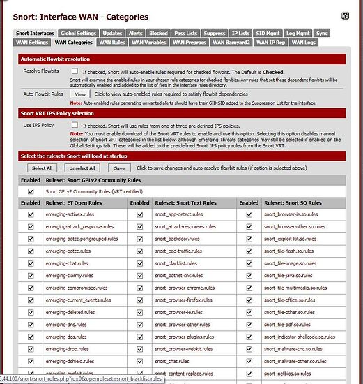

WAN setup

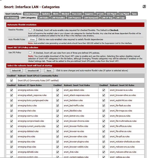

LAN Setup

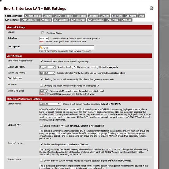

Looks pretty good. You don’t need to run snort on both your WAN and LAN interface, it’s basically just doing everything twice. It’s usually best practice to run it one the WAN interface so packets are processed before they hit the firewall, this is also the reason why you will end up with a lot of alerts as most of what you’re seeing would have been dropped by the firewall anyway.

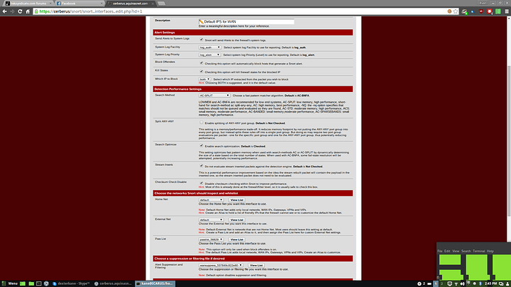

Also I’d recommend using AC-SPLIT for the search method, it has good performance without using a ton of memory. If you have the memory to spare then AC is probably the fastest.
Also with your rules you might want to go through and disable some of them if you just have everything selected, a lot fo the rules are for policy stuff rather than security, so they will block games, or executable files being downloaded or certain content like porn. Stuff like that. For my rules I use the balanced VRT policy which automatically selects rules from the snort rules and everything from the ET rules except: chat, deleted, games, inappropriate, info, p2p, policy, and voip.
As for why something generate an alert but aren’t blocked, there is an automatic whitelist which includes the local subnet, your public IP and the gateway IP which will not get blocked, but they will still generate alerts. A lot of the IPs in that screen shot were broadcast addresses so they won’t be blocked either and the ones you blurred out are presumable your public IP. Otherwise everything which generates an alert should be blocked, if that’s not the case then something is wrong.
Once you have it up and running you’re going to get a lot of false positives, especially if you have a large ruleset, so you’ll need to go through and disable rules which block legitimate traffic. On the alerts page you can click the X for a rule under the SID column, this will disable that rule. You can also click the + on that column or for a specific IP address on the source or destination columns, this will add that rule or that rule and IP address to the suppression list. Generally if you want to disable a rule completely then click the X as that will disable it and stop if from being processed and using memory, only use suppression if you only want to allow a certain IP address as suppressed rules are still processed but the alerts are ignored.
Hope that helps.

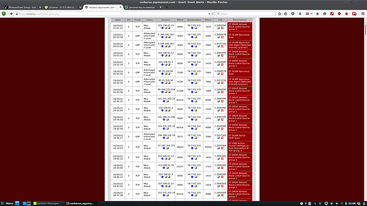

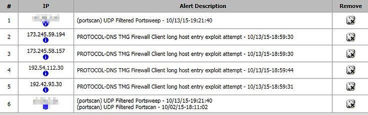

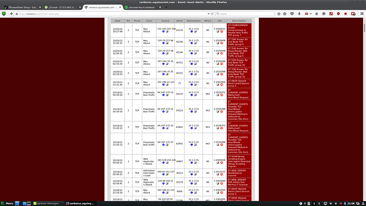

You had mentioned that stuff would get blocked like EXEs, certain bad sites etc but Snort doesnt seem to block any of that now, I rely on HIDS to assist with alot of the nasty stuff.

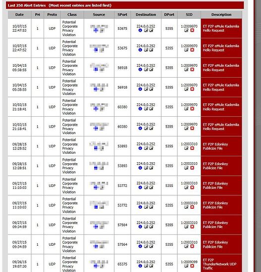

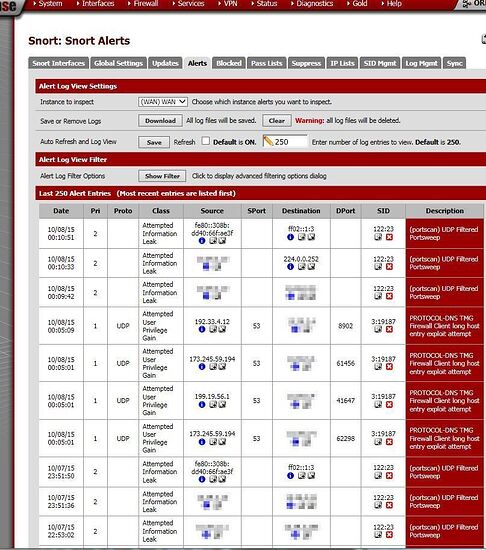

As fpr stuff not getting blocked, I see this on the Alerts tab
Note these two IPs arent in the block section:
For the LAN, Im hesitant to remove it since it has blocked threats in the past, but I do hear you on generally just running the snort on the WAN interface.

Sorry one IP is blocked, the other isnt..
Depending on how you’ve set it up blocked hosts will be removed after 1 hour, so it could be that. I haven’t seen a case where some traffic is blocked but others aren’t, basically anything on the alerts pages should be blocked unless it’s in the white list or suppression list, so if you’re seeing blocks then it’s safe to assume it’s working correctly.
And yes, if you run it on both LAN and wan then you will get alerts for both but that’s only because traffic from the LAN is hitting the LAN interface on snort before then going through the wan interface. If you only ran it on wan then it would still be blocked as you’re running the same rules against the same traffic, you’re just doing twice as much work for the same result.
I would suggest rather than running all the rules instead choose the vrt ips policy and use balanced and then pick some of the ET rules that you think you’ll want. A lot of the rules are for policy rather than security and the names can be misleading. For example if It says p2p or chat it doesn’t mean it’s for securing those things but for blocking them. Whereas dns or SMTP if for security. You can find descriptions of the rules online which will help in choosing which one you want to run.
Also remember that snort won’t be able to do anything with encrypted traffic so if you’re using https or a vpn then it can’t see anything, which might be why the policy rules like blocking .exe files didn’t work.
And for four gb of ram I’d use ac-split (in fact I do) I’ve tried ac and ac-std and I ran in to memory issues with 4gb of ram.

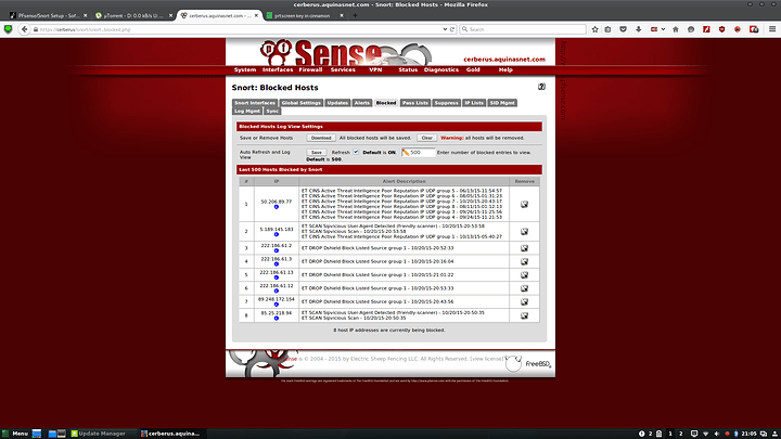

If you have something in the blocked tab then it is currently blocked, once it is unblocked it is removed from that tab. The one from 10/2 might keep generating an alert so it’s never released from the blocked hosts (remember snort processes packets before the firewall so blocked traffic will still be seen by snort). I think it’s safe to assume it’s working, if you want you can change the block time to something longer to check that things are getting blocked, just be careful not to lock yourself out. You can also look through the system log or firewall log to see what has been blocked by snort.

Ok thanks,can you also post your blocked tab, I am curious to see what get auto blocked for you on a daily basis.

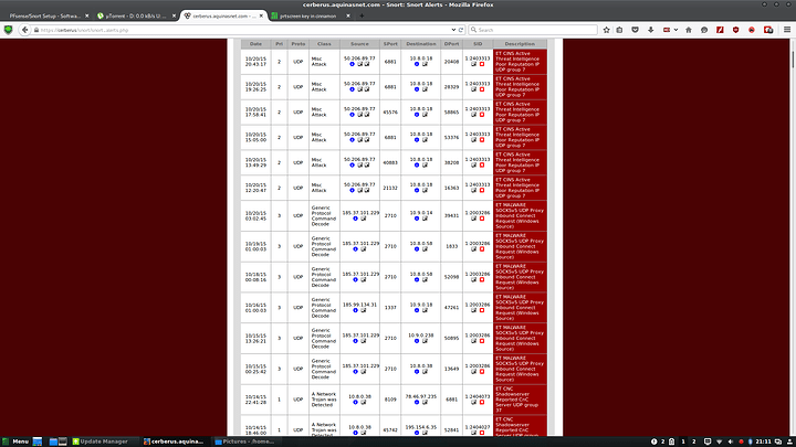

Okay here are some screen shots.
This is the blocked list.
I have four snort interfaces running, one for WAN and the other three for VPN conections. This is the WAN alerts, I have no open ports and most traffic goes though a VPN so everything on here is just noise pretty much.
Yeah, I couldn’t be bothered hiding my IP, it’s dynamic anyway so it doesn’t really matter.
This one is the VPN I use for torrents, Pretty sure all these inbound proxy connection alerts are false positives.
This is the VPN I use for browsing, there are a few alerts alerts relating to browser exploites. The port scan alerts are false positives caused by pfsense checking the gateway status, the IPs for the gateways and google and opendns servers are all on a whitelist but I still get the alerts.
This one is for my connection to my VPS, I use it for my mail and web servers. This one gets a few alerts for exploits like heartbleed. These are most likely from bots or scriptkiddies.

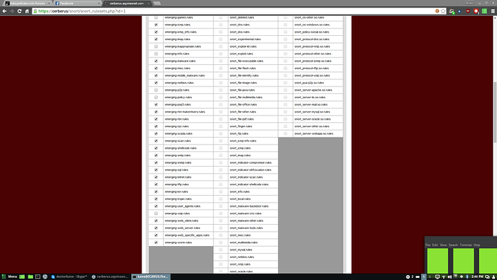

As for you not getting the same alerts as me, you can see which rules I have enabled in a screenshot above but you may just not be being targeted by those IPs. I run a web server and mail server so it would be expected that I would get more port scans and stuff like that.

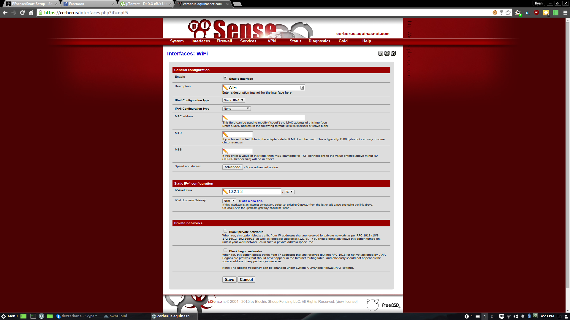

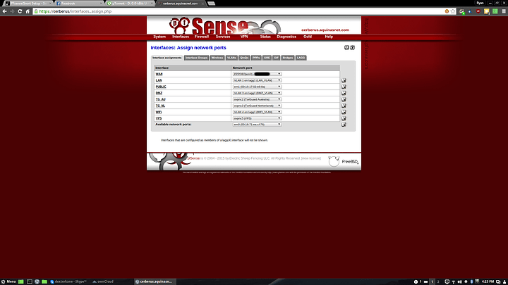

Thought I’d throw in some screenshots to help explain that better. This is my Wi-Fi interface configuration.
I don’t have a wi-fi card this just connects to a separate AP. In your case you’d set up the physical interface in the wireless tab of the interfaces>assign menu, then assign that wireless interface to a pfsense interface like WIFI or OPT1 or whatever you want to call it (You will already have LAN and WAN). Then you would configure that interface with a static IP like I have in my screenshot. I have a /24 network because I use DHCP and I’d say do the same even if you’re not using it.
If you set it up like this then you will also need to create firewall rules for that interface. You LAN by default will have an allow any to any rule but the new wireless interface will have no rules so you will need to create one. The any any rule will allow traffic on the wireless network to access the internet aswell as the LAN. If you want to stop it from accessing the LAN then create a block rule above the any any rule (pfsense processes firewall rules from top to bottom until it finds a match) which will block traffic from any to the LAN subnet.
If you want the wireless network to share the same interface as the LAN network then go to the assign menu and open the bridge tab and create a bridge using the wireless interface that you created and the physical interface which is currently assigned to the LAN (you may have to unassign it first) then go back to the assign page and assign the bridge interface to the LAN.
That’s my assign menu just so you know what I’m talking about, once you create the bridge interface it will be available in the network ports and then you can assign it to your LAN interface.
