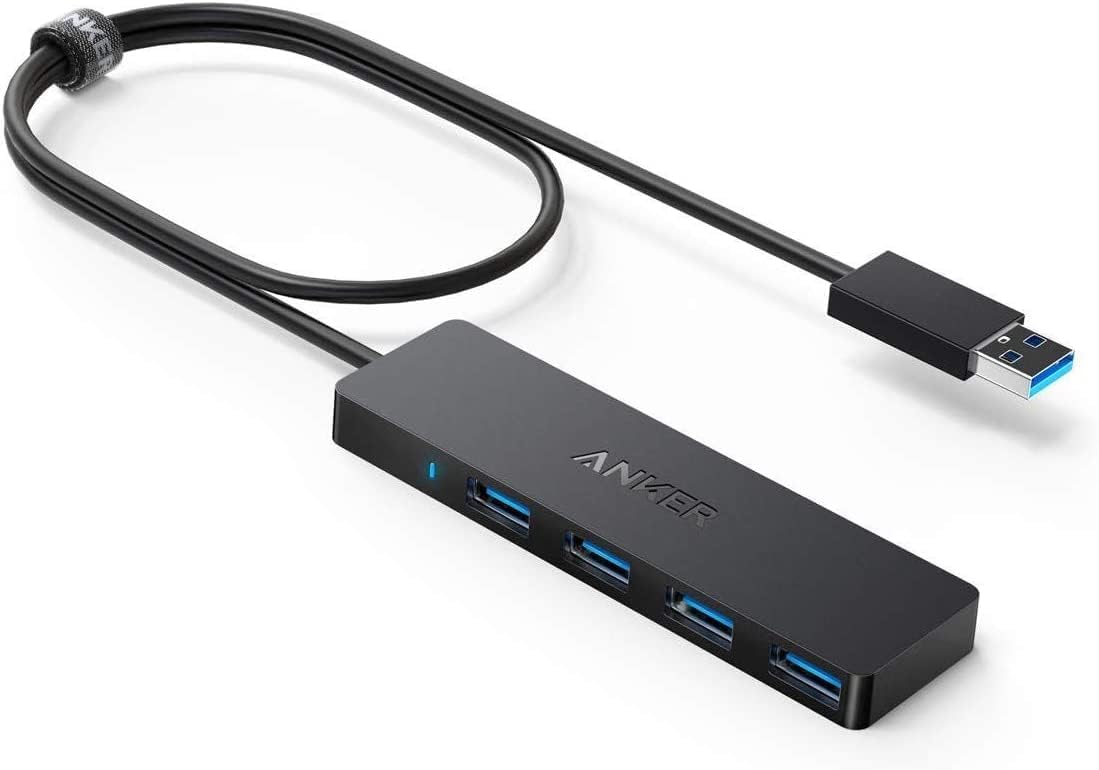

Yeah, I think I’ll just get a USB3 hub. Any Level1 favorites that are validated to work with this KVM?

We use Anker here sometimes, and their products are pretty good. You could probably use something like this without issue:
