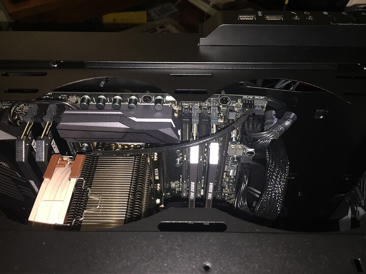

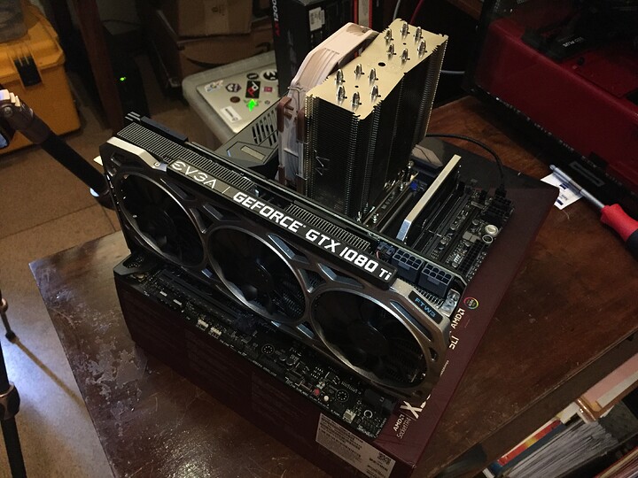

  • With the TR4-SP3 Noctua cooler (NHU-14S), I had it installed at offset 0; even if I had moved it to offset +6, it would make no difference in terms of blocking the top-most PCIe slot. This is a total PITA as that top slot is a 16x slot. Ugh.
  • The EVGA GTX1080Ti FTW3 - incredible over-the-top cooler for sure. At idle, all three-fans are basically off. Sure, in Fedora, it doesn’t draw much in idle… just 13W

  • On the ROG board, there aren’t too many fan headers towards the top of the board.
  • I’ve resorted to using the 3rd (longer) PCIe slot as this is the only other 16x slot.

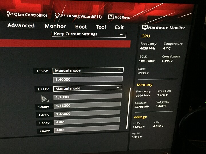

The Corsair Dominator Plat. 32GB DDR4 3200MT/s RAM I’m using is the same identical kit and item off Amazon, however, this time I received 2x 16GB of v4.31 instead of the v4.24 variant that I got with the Gigabyte 1950X build.

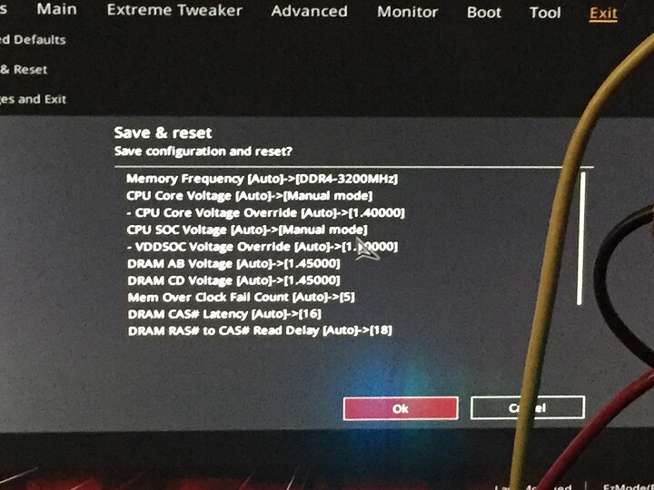

I followed the same process this time around, on the stock UEFI (I haven’t updated it yet), which is 0401 on the ROG board with the following config-
CPU VCore 1.4vdc
VCore SOC 1.1vdc
DRAM Channel 1.48vdc
XMP - disabled
Memory manually set to 3200 MT/s
Timings manually set to 16-18-18-18-36
I first tried 1.45vdc on the DIMMs, but later increased this to 1.48vdc. It was far easier to get this kit to boot at 3200MT/s. I also disabled Asus’ Overclocking Enhancement, as I didn’t want all the cores being pushed to 4GHz+ in no-load conditions.
Today, I moved all the hardware into a second Corsair 570X Tempered Glass case, which isn’t meant to support E-ATX. There’s a wee-bit of flex on the mainboard PCB, and I haven’t fully tightened the screws on the very right side. The middle screw on the very-right side has also not been added. It’s mainly held but the same spots one would find on a normal ATX board, but with a few turns for the top/bottom E-ATX spots. I was way gentle here, as I didn’t want to fracture traces etc.
As you can imagine, that first boot was wee bit stressful. I either flexed it just right, or just blew $500+ Couple video-clips of quick-n-dirty reactions… that first POST haha, I was relieved for sure… :smile:
