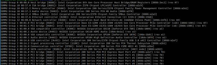

I am extremely new to Linux (working in it for about a month) and am moving over from Windows 10. Ever since I switched, I’m falling more and more in love with it. I still have my windows partition as a back up, but I’m trying very hard to switch solely to Linux. The latest challenge I’m facing is being able to game. I’ve done the research and what I’m going to do a mix of native gaming, WINE gaming, and a VM with a GPU passthrough using VFIO. After a week and a half of work I’ve managed to figure out all problems with VFIO but now that I can create the VM I’m having troubles with my IOMMU groupings. My GPU and companion sound controller are in a group with 4 other devices. I’ve read about a ACS override patch (I’m running on a Xeon E3-1200 controller which I’ve read doesn’t support ACS) and it looks like its extremely hardware specific to me and the one Wendell made looks looks like its only for radeon cards? If I’m wrong about this, I would really appreciate it if someone could help me by providing me a link to a good ACS patch and how to apply it to my kernel
EDIT: changing to kernel 4.19 did not affect the problem at all. Could an earlier kernel help me?
Here are my IOMMU groups so that you can see my issue

With most distros, you have to download the kernel source code, insert the ACS patch, and compile+install the patched kernel.
Since you are running Ubuntu(or spin thereof), there are pre-compiled kernels with the acs patch available here-
https://queuecumber.gitlab.io/linux-acs-override/
Download the kernel and headers, and install them with sudo dpkg -i <file>.deb, obviously substituting the correct path for it. Put pcie_acs_override=downstream in /etc/default/grub in the line GRUB_CMDLINE_LINUX_DEFAULT=" ". Then run sudo update-gruband reboot.
Hopefully, then they will be separated.
If you want to learn to compile your own custom kernel, you can download the patch at the page above. Download the patch for the kernel version you will be compiling, the patch versions are very similar but with minor tweaks.
Thank you so much for the response! I got the kernel and my IOMMU groupings are now much more separated to the point where each GPU is in its own group. I had a small problem with the install but I looked at the error and it pointed me to a log where I just had to download a dependency (not sure why they had to print that to a log instead of just on the terminal, but whatever). However now I’m getting very low FPS after reinstalling my proprietary Nvidia driver (390.87) to the point where the entire system will gradually slow down to a halt if given a large work load (like actually creating the VM) and I have to reboot the system. Do you or anyone else have a fix for this?

You did enable the patch in grub and reboot before checking the IOMMU groups? The reason for the patch is if you have thing(s) you do not want to passthrough in the same group as your GPU. So if it is the audio and stuff of the GPU, then just pass everything in the group through.

Yes, I did check the IOMMU groups after rebooting and Vega 64 was split up into 4 groups but the nvidia card had all it’s components under the same group (iommu group 17). I tried running my VM but it kept saying 0000:04.00.00 in group 17 was not valid and I should check to make sure I had separated the groups.
