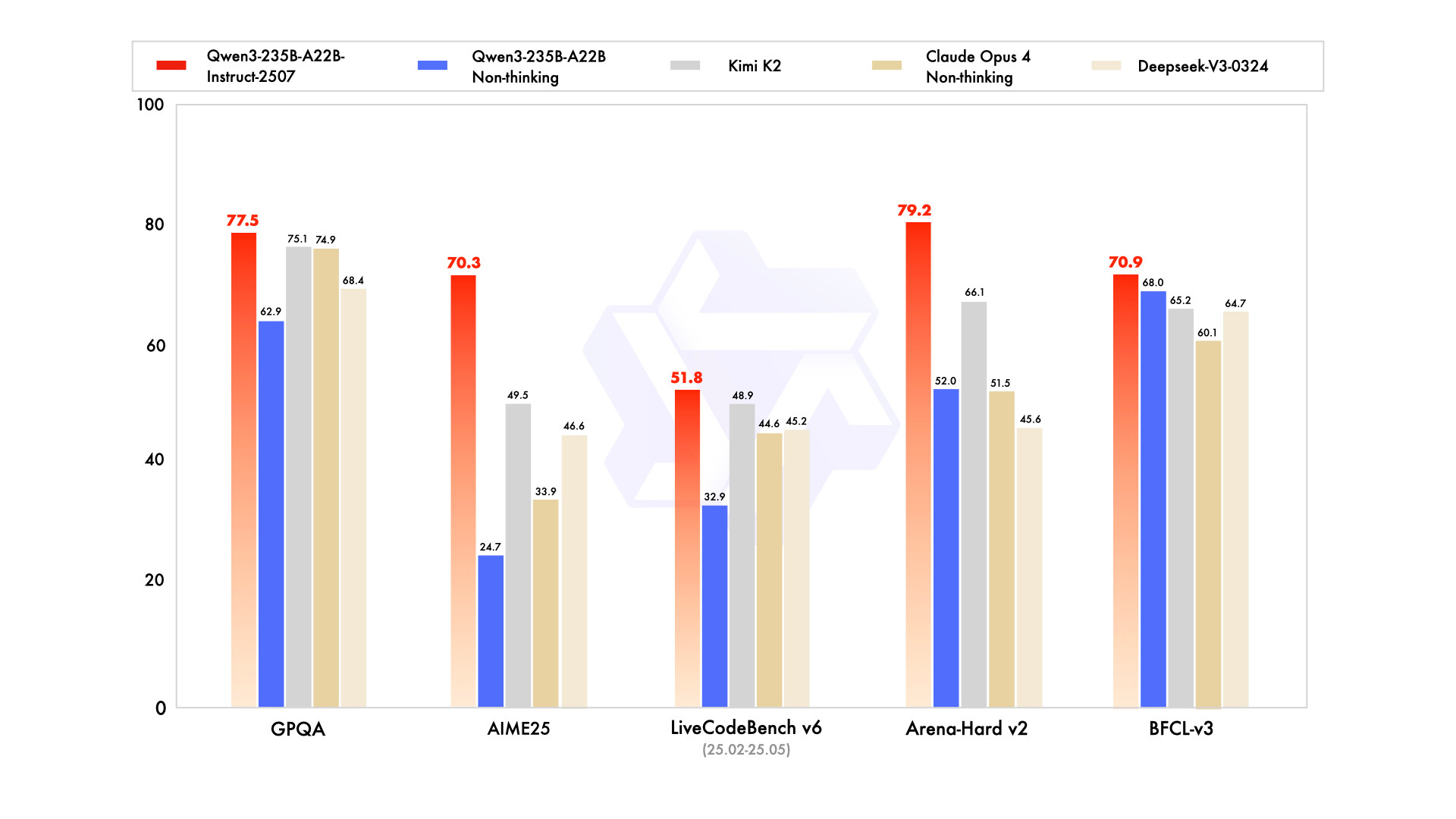

Not R1 related but it seems Qwen released a new 235B MoE model Qwen/Qwen3-235B-A22B-Instruct-2507 · Hugging Face
Now they separated it on non thinking (instruct) and thinking (reasoning). Only the former is out now.
Their benchmarks are really impressive, but I will have to test as they claimed something similar with the old 235B and it wasn’t better than V3 or R1.
