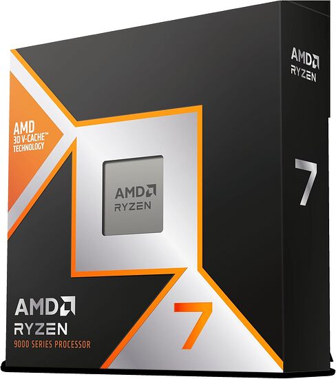

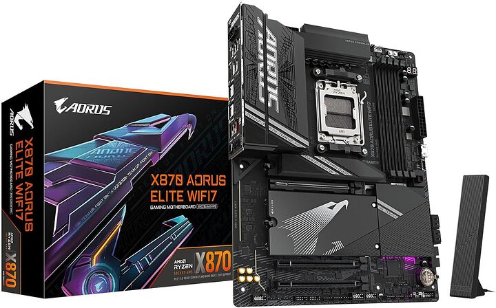

What is the build in the video?
https://www.amazon.com/FSP-Computer-Titanium-Eco-Friendly-HTI-1000M-GEN5/dp/B0D467S15T?tag=level1techs-20

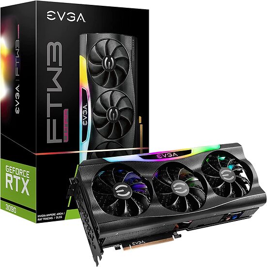

The old 3090 with 24GB VRAM running around 1TB/s memory bandwidth at around 350Watts is still a decent price point. I use this for my home rig.
You can do a lot in 16GB VRAM, but ideally more will be useful if you’re into the AI stuff like LLMs and ComfyUI etc.

You’re right. 16gb VRAM might be a little low. 3090 is also 30% cheaper than 5070 ti but used of course.

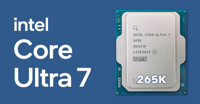

I’ve looked at Intel cpus as well. Recently got the newer T14 Gen 5 for work featuring a Ultra 7 155U which work suprisingly well. I’m tempted to try using a Ultra 7 265K for the build, same price as 9700X, but faster in AI workloads, according to techpowerup. But since its running on GPU mostly it might not matter or might not even be properly supported in linux:
