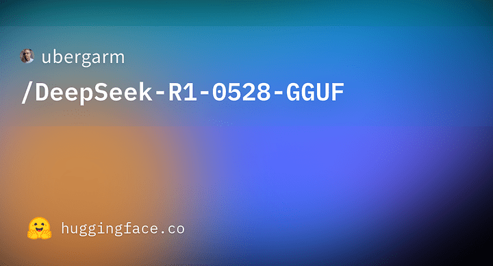

FWIW, just going to add that @ubergarm’s old IQ2_K_R4 recipe at Huggingface, with the following changes:
blk\..*\.attn_kv_b\.weight=q8_0 like the later Kimi-K2 quants, and,
All routed experts targeted to CPU switched from IQ3_K_R4 to IQ3_KS, and IQ2_K_R4 to the brand-new IQ2_KL,
would produce a 2.930BPW/229.226GiB quant that still does 32K context off of 16GB VRAM. Perplexity is 3.4379 +/- 0.01847, quantized from unsloth’s version of DeepSeek-R1-0528-BF16 with ubergarm’s original imatrix. No surprises with processing and generation performance either, but probably not that much of a difference in perplexity to really matter in any case.

Oh nice, sounds like you’re able to cook some of your own quants?! Yes, if I were to go back and re-visit some older recipes that mix you describe indeed sounds like some good choices.
If I understand it right, this is the comparison you’re making:
  • JWNoctis/R1-0528/IQ2_KL 230GiB (2.930 BPW)
    • Final Perplexity: 3.4379 +/- 0.01847
  • ubergarm/R1-0528/IQ2_K_R4 220GIB (2.799 BPW)
    • Final Perplexity: 3.5069 +/- 0.01893
That is quite a nice improvement for not much more size! I’ve been re-working my Kimi-K2-Instruct recipes after noticing Kimi-K2 seems even more sensitive to quantization of those attn/shexp/blk.0.ffn.* layers.

have you tried ours? it has the best (edit: hah 2nd best. top 5 surely. lol) perplexity on HF. yes it’s not perfect but it’s surprisingly good.
