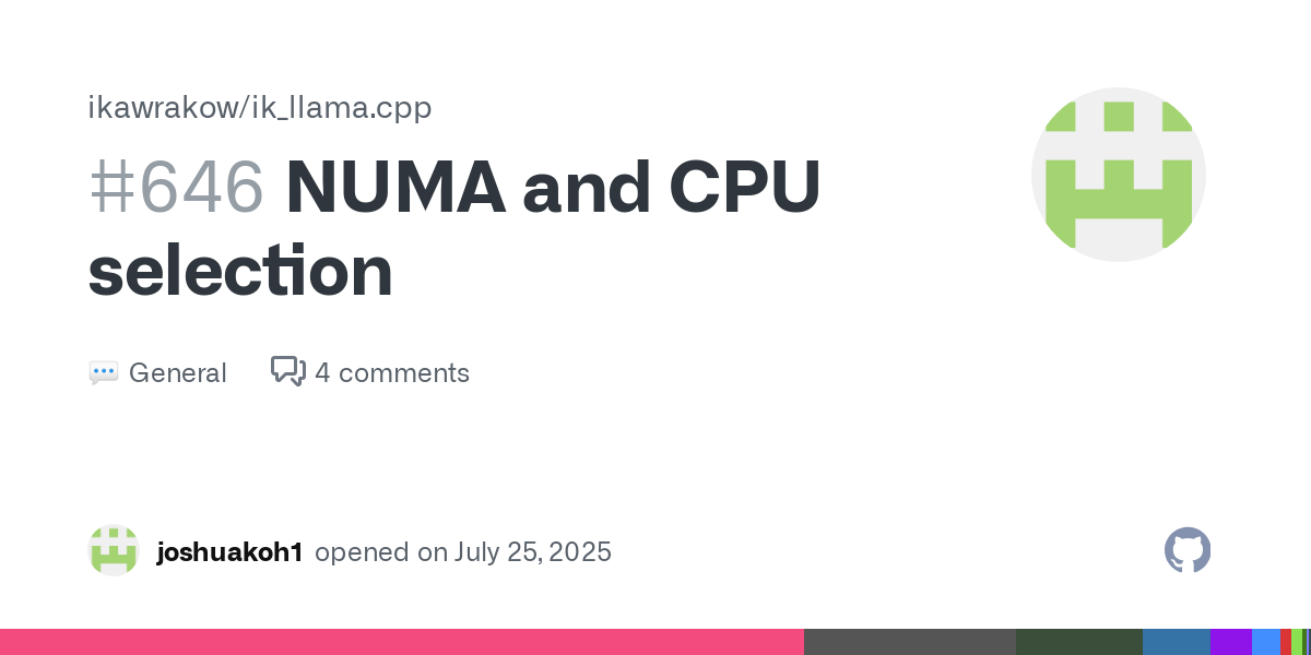

Hello all,
For those familiar with the subject, Am I correct to assume that the numa domain challenges haven’t been resolved yet, thus making the threadripper pro platform with a much better price/perf compared to big epyc or xeon build?
I ask that because for the little speed numbers I could gathered I don’t see much improvement for epyc over threadripper pro. And was pretty much underwhelmed by the experiment wendel did on that big intel 6900P (even with the biggest cpu and fastest ram).
I feel it’s been months we are stuck on that software challenge and do not expect it to change in near future.
What do y’all think about that? Or am I completly wrong and those server platform are faster.

@pure_syn
There are a number of projects out there with attempted solutions. For example, some inference engines (like ktransformers) and some modified llama.cpp forks I’ve tried essentially load the weights into RAM N times, once for each N NUMA Nodes (usually 2). The idea to keep a copy close to the CPU cores that will use it, but at the cost of requiring double RAM. I call this approach “data-parallel”.
There are no multi-NUMA “tensor-parallel” solutions of which I’m aware yet no, at least not with GGUF style hybrid CPU+GPU inferencing.
You can go full VRAM GPU only with vLLM and sglang and use tensor-parallel though for very fast speeds on small models or in big multi-GPU nodes etc…
I haven’t done a comparison of single socket Epyc vs Thread Ripper Pro systems to see which one can pack the most RAM bandwidth into a single NUMA node at the lowest price though.
What size models are you interested in running and what kind of prompt processing and token generation speeds would your application need?
TR Pro will never win on price, that’s for sure. That said, if you’re using it as a workstation, it’s an infinitely nicer experience compared to Epyc (motherboards available with sound, USB4 (and plenty of USB in general), overclocking options, M.2 slots, etc. everything you’d like from a desktop platform. All while having 8 DDR5 channels and 6 x16 slots. That said, you can have Epyc much cheaper on a single slot system with 12 channels.
For reference, my TR Pro 7995wx shows ~400GBps memory bandwidth with 8x DDR5 6800.
Oh some interesting discussion on multi-NUMA and Epyc systems and Zen5 benefits as well going on with ik overe here in a new discussion:
