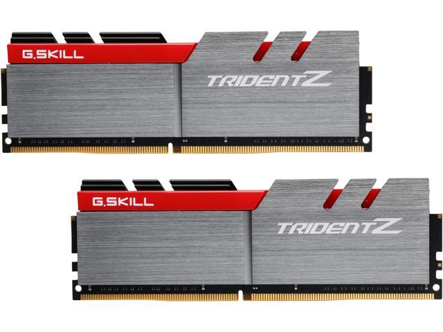

Well I spent a lot of time on this one, and still nothing. When I load XMP Settings to the first profile which is what my ram is supposed to operate at... ddr4 3200 14-14-14-34 .. but it shuts down and reboots into ddr4 2133 15-15-15-36 ...
I raised the dram voltage to 1.4 and to no avail.
Any one got a clue on how to get this ram running faster or am I waiting on a mobo update ?

Your model number is not yet listed in the Memory QVL for the Taichi.
http://www.asrock.com/mb/AMD/X370%20Taichi/index.asp#Memory
If you purchased this kit online you might be able to do an RMA with one of the two compatible 3200 kits listed. If you explain you ordered the wrong SKU to an agent on the phone, you may even be able to have the new kit cross-shipped.
+1
The kit will still work, but will need manual setting, XMP won't work on it. It's not a big deal from my point of view, but if you feel like it is for you, which is totally OK, you can actually expect that from RAM, just swap out the kit for a kit that is supported by the mobo.

Yes i did set values manually... that failed as well.. even setting the manual values to what the auto reading does, gives a failure. I tried single stick .. both individually , same failure. Funny story, my part number on invoice is different then what I ordered & received. F4-3200-14D-16TZ R ... The only difference I can tell is the RGB... well it looks like I may have to call newegg, and see what they say.

LOL let me clarify ... I got the ram I ordered... however on the bill it says I ordered the rgb ram... which I did not... The order number leads me to the correct ram I ordered however the billing says otherwise.. even though i got what i ordered... my first link was wrong... apologies.
This is what i ordered and this is what i got
However the PART number on my bill has leads me to the RBG. which I did not order.
Although the actual ORDER number of the bill leads me to the one i have... Just a mistake on their behalf...
I updated the bios to 2.0 early this morning. Still no go... I tried single ram in A1 , A2/B2 configuration and even A1/A2 configuration. Nothing works at anything other then 2133 latency 15. I contacted Gskill via email and stated my problem to them... as I saw on another site some people had exact same ram and it ran perfect, and another had the same ram doing exactly what mine is... they contacted gskill and were told the ram is bad... so I wait for gskill to respond.
