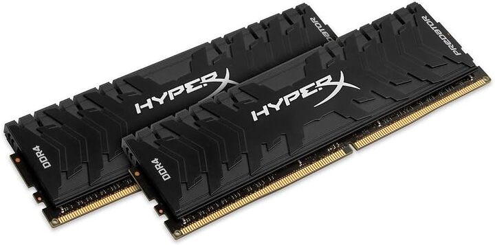

Tested OK at DDR4-3200 in this board:

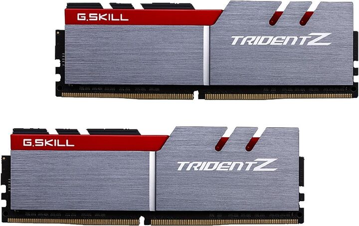

Tested OK at DDR4-3000 in this board:

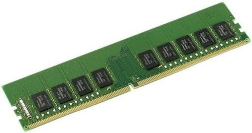

Tested OK at DDR4-2400 in this board:
That’s good news for me. Though won’t be grabbing the same mobo, will have 4x16GB dual rank D die Samsung sticks

So guess I can conclude that all dual channel G.Skill 3200MHz memories are alrite at least with Taichi.
..and probably Hero?
Curious if all G.Skill 3200 kits can go same as upcoming Flare X?
My memory overclocking skills are opening QVL and copying specs for same kit running higher speed. :smiley:
