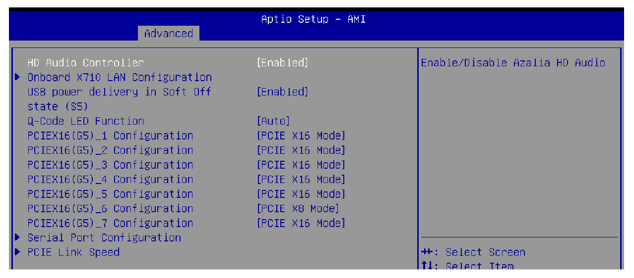

I’ve tried disabling fast boot, turning on resizeable bar support, turning off VGA support on the board, disabling on-board audio, wifi, setting lanes to gen 4 for each pcie slot, and switching the ipmi switch on the motherboard, but nothing seems to be working.

Make sure the slots are correctly configured based on the number of required lanes.

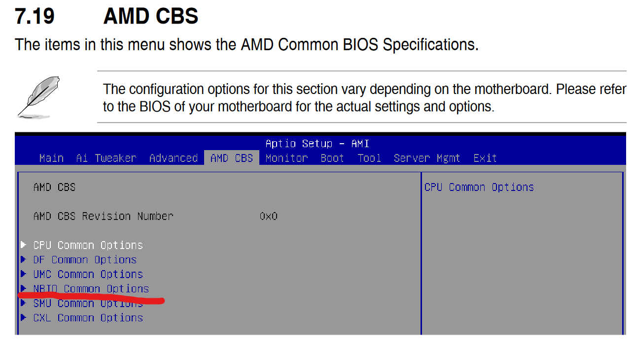

In the NBIO/IMMOU section there are some addressing settings you can test as well.

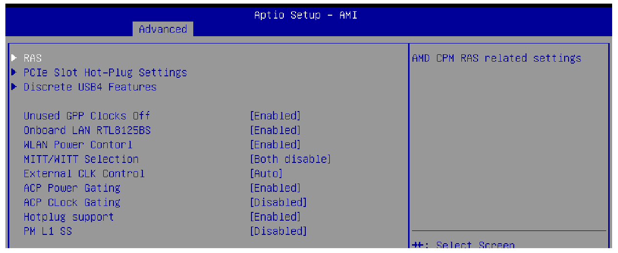

  • I don’t see PCIe slot Hot-Plug settings - maybe another setting somewhere is hiding that menu option from me?
  • I also don’t see above 4G Decoding as an option anywhere (not even in the bios manual)

PCIe Hotplug is Advanced > AMD PBS > PCIe Hotplug

Under AMD CBS > NBIO Common Settings > there are several PCIe related toggles you can try flipping

  • the APM Configuration menu does show the Power On By PCI-E option and it is disabled. The other option that shows up in the bios menu for PCI-E Hot Plug support does not show up in my AMD PBS menu (only USB settings show up there). I’m assuming all that stuff is just disabled.

  • I probably have more learning to do in the RAS and NBIO settings areas. Apart from the ones you’ve already mentioned, I don’t know what a lot of the settings do.
