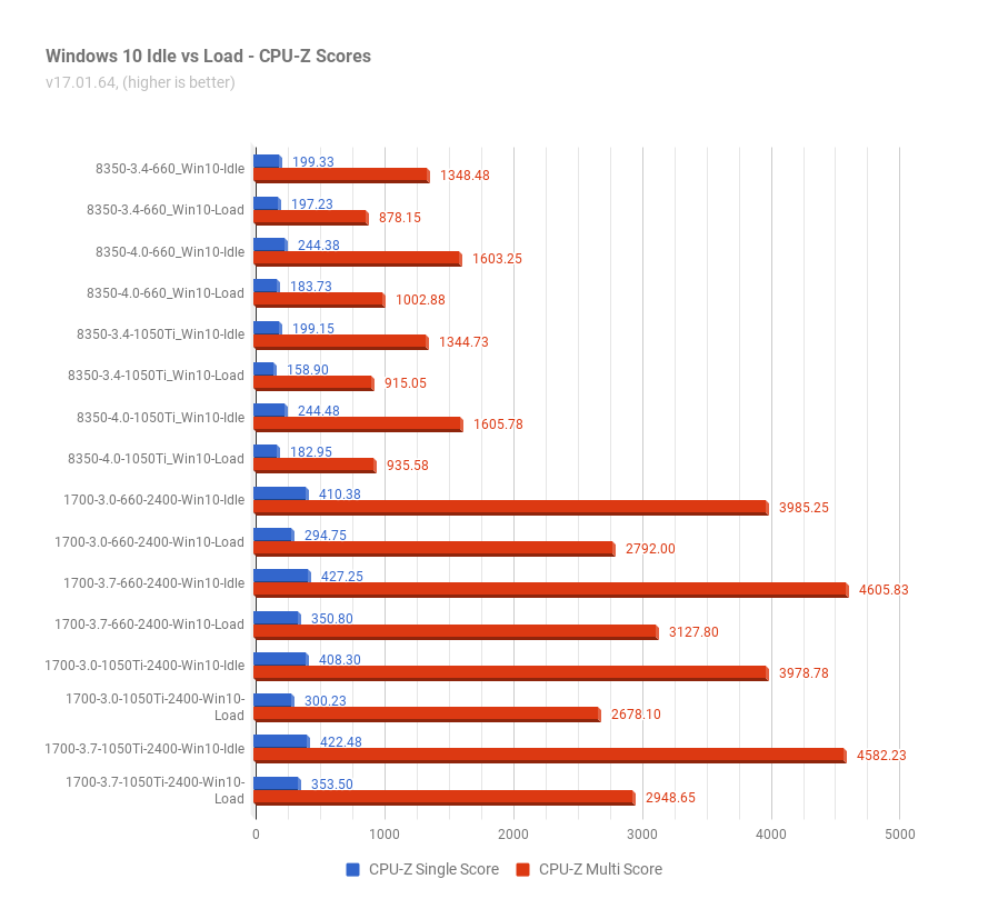

CPU-Z Single and Multithreaded

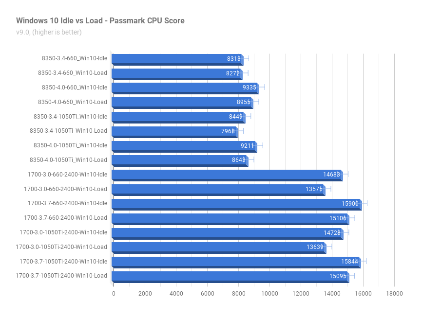

Passmark CPU Score
- Passmark CPU is not a great benchmark.

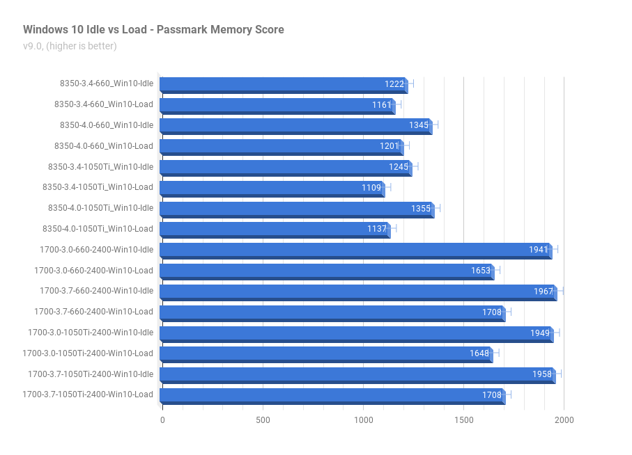

Passmark Memory

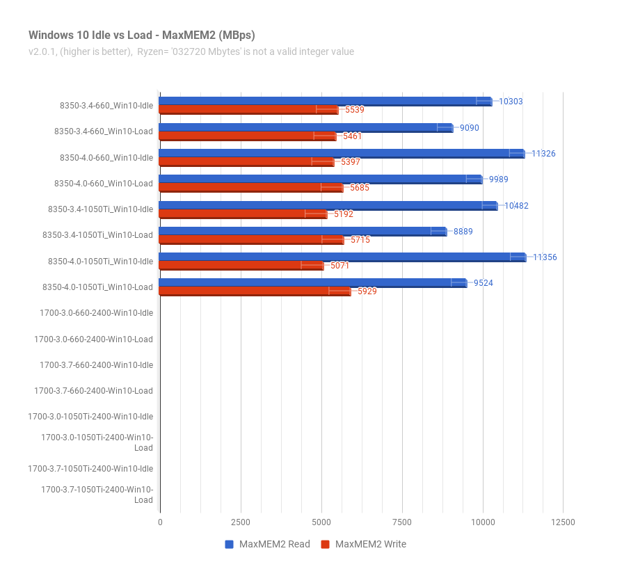

MaxMEM2
- My FX system has lousy memory writes.
- Oddly enough, putting a load on the system consistently increases memory write performance. Unclear if this is a testing quirk or indicative of real world memory write performance.

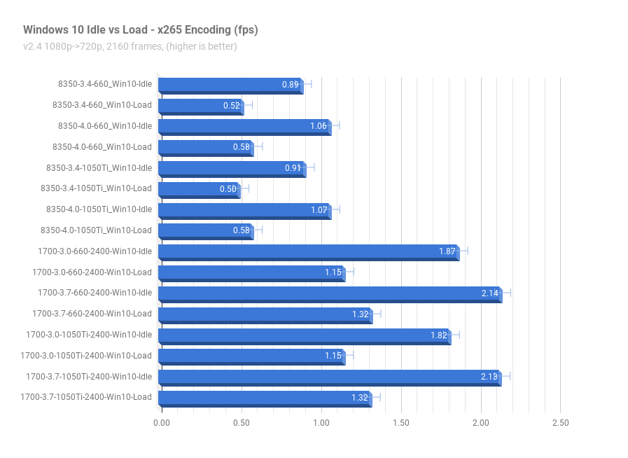

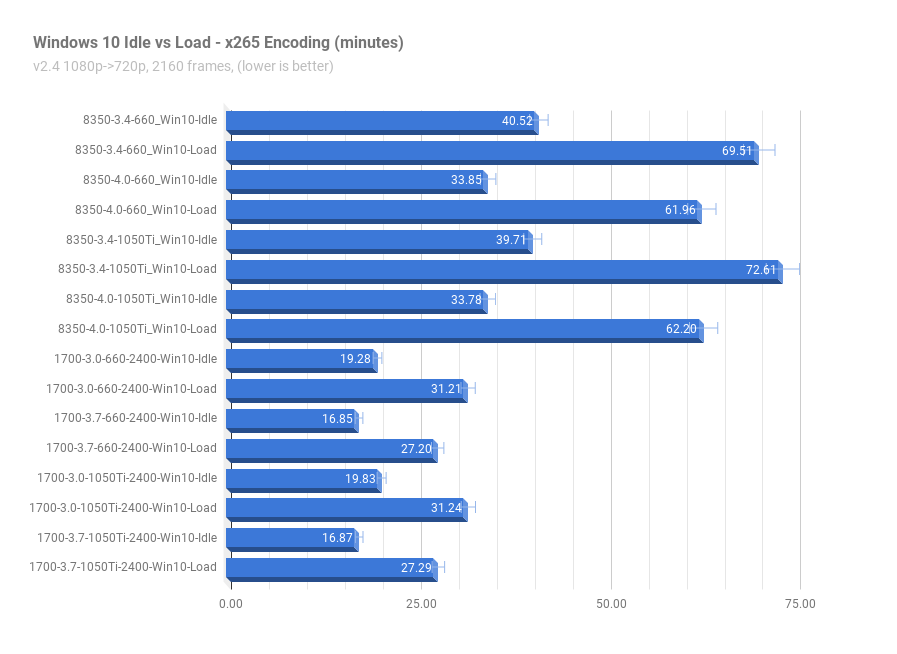

x265 Encoding Time
- Encoding time does not quite double, implying two encodes started simultaneously would take less time overall than stagnating them. That said, it would be quite a while before either encode finished.
x265 Encoding FPS
- Encoding at 0.52 fps typical under load. At least Ryzen doubles that to 1.15 fps. Or even 1.82 for those rare moments when there is only one encode in the background, instead of multiple ones. Welcome to the world of encoding.

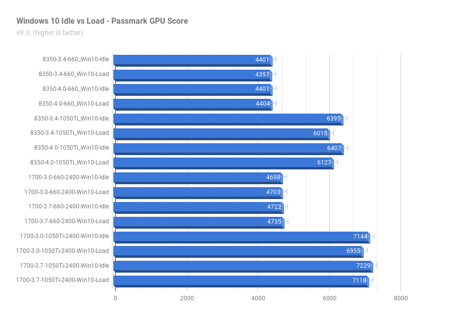

Synthetic GPU Benchmarks
Passmark GPU

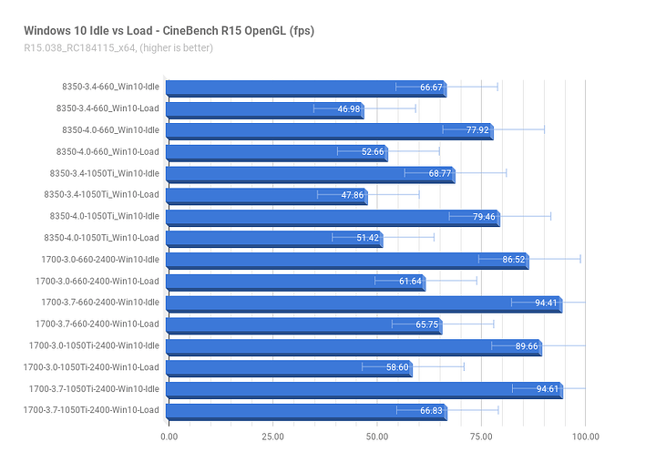

CineBenchR15 OpenGL
- Those error bars… I do not even…

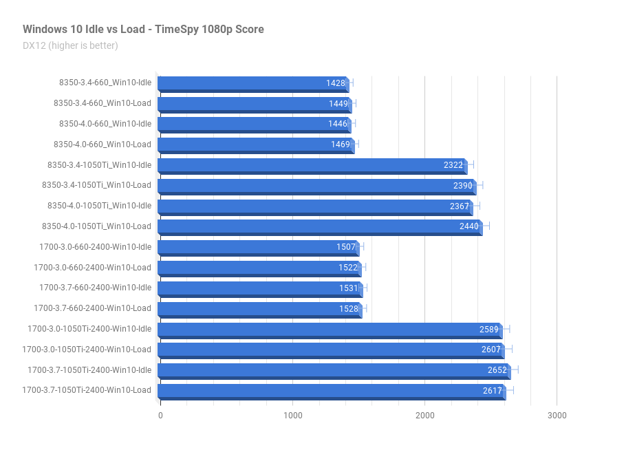

3DMark TimeSpy Score
- Same story as Firestrike but with DX12.

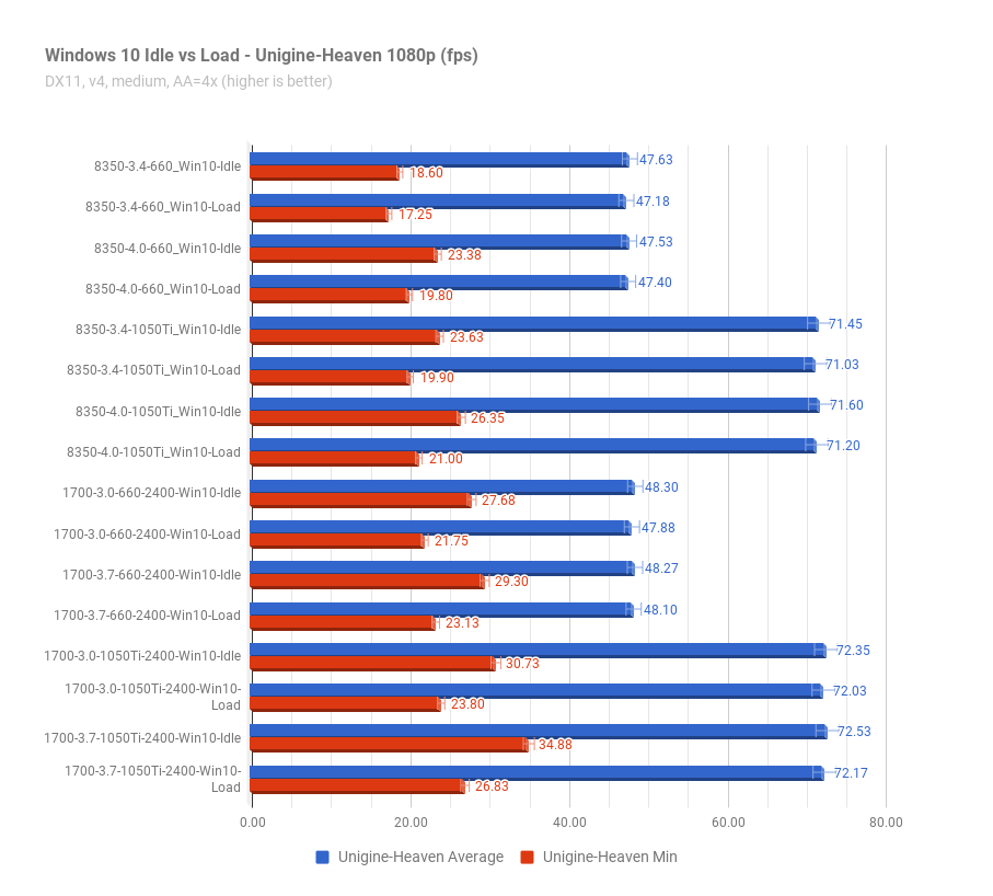

Unigine-Heaven FPS
- So loads affect minimums disproportionately compared to averages.
- That said, Unigine does not properly factor in the minimum framerates into how it is reporting averages.

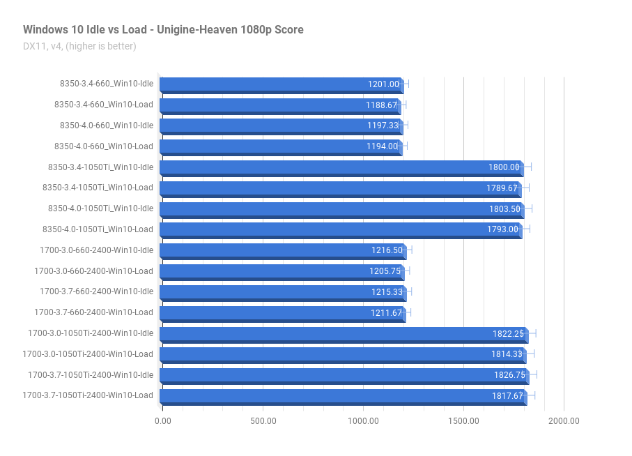

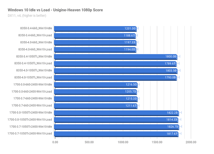

Unigine-Heaven Score
- The scoring completely ignores minimum frame rates.

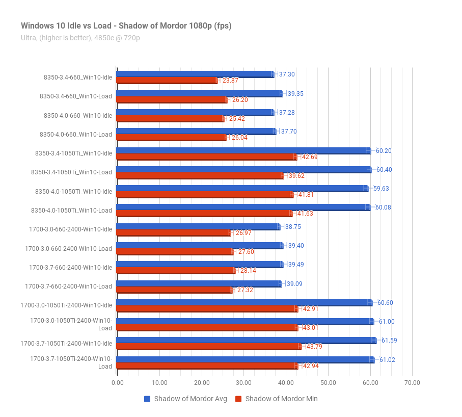

Games

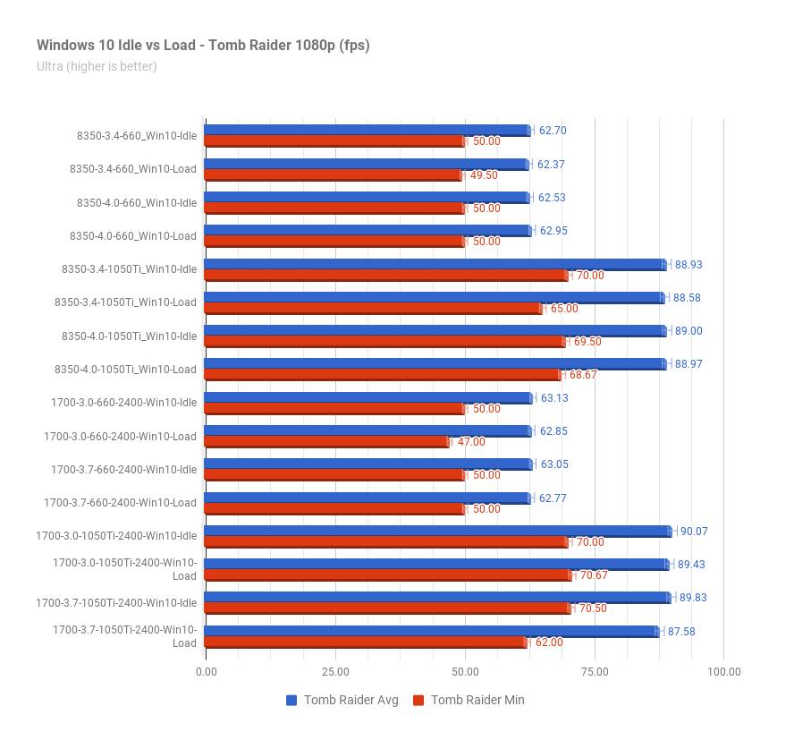

Tomb Raider
- Tomb Raider does not care about your CPU. It doesn’t care if it is a dual core, or you are encoding in the background. It just doesn’t.
- But sometimes, while under load, FPS can dip due to OCing. This would not be perceptible under Windows 10 but it is measurable. Unclear why this happens.

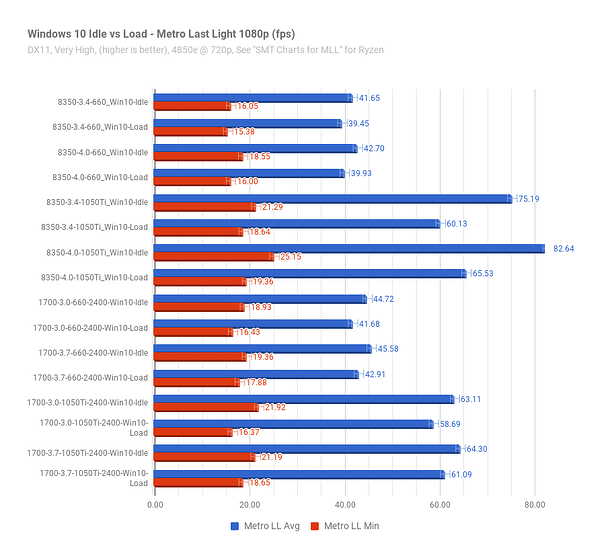

Metro Last Light
- Regarding MetroLL and Ryzen’s SMT.
- From the averages, it looks like FX dips much harder than a Ryzen system. The Ryzen system would be smoother.
- Given how little minimum frame rates are indicative of actual performance in MLL, it is difficult to draw any conclusions as to the extent of CPU loads while running this game beyond the above.
Shadow of Mordor
- Another Tomb Raider. Feel free to encode in the background while playing Shadow of Mordor under Win 10. It will not affect performance significantly.

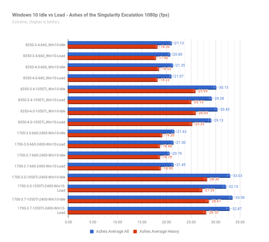

Ashes of the Singularity Escalation
- Same story here.
