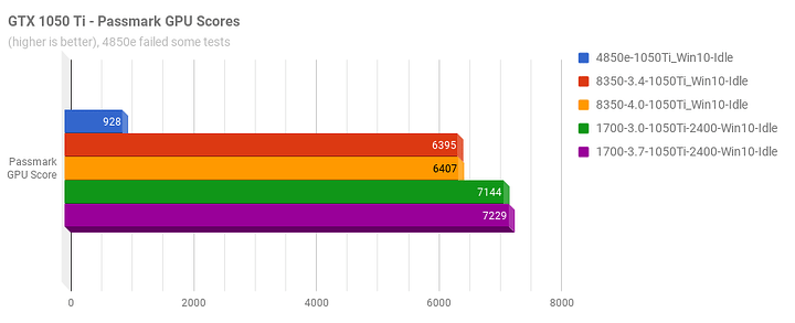

Passmark GPU
- Significant scaling across architectures (11.5%) but not clock speed increases.

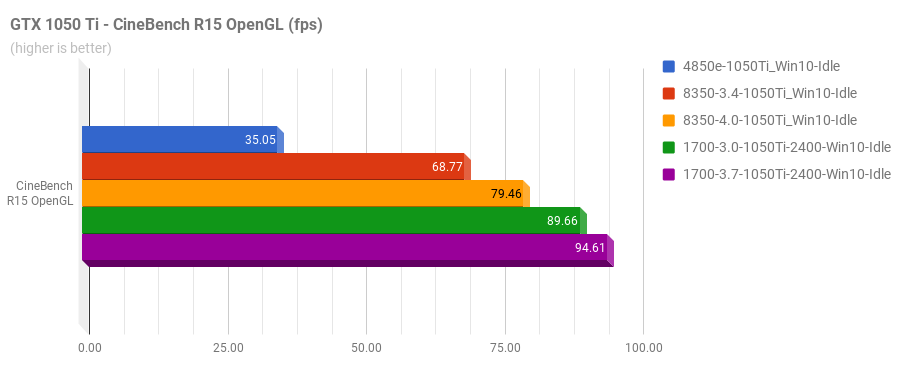

CineBenchR15 OpenGL
- What real world applications scale like this? Maybe OpenGL games? So DOOM maybe?

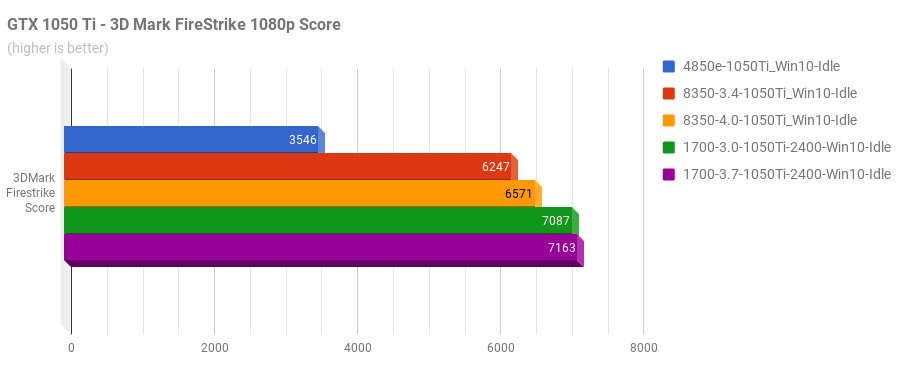

3DMark Firestrike Score
- Significant scaling across both architectures and not clock speeds that is likely more indicative of real-world performance in non-GPU bound games.

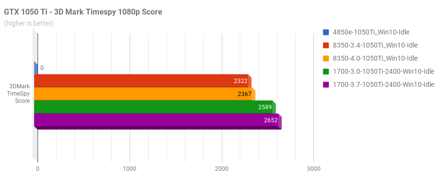

3DMark TimeSpy Score
- Phenom II and older CPUs, like Brisbane, are not DX12 compatible.

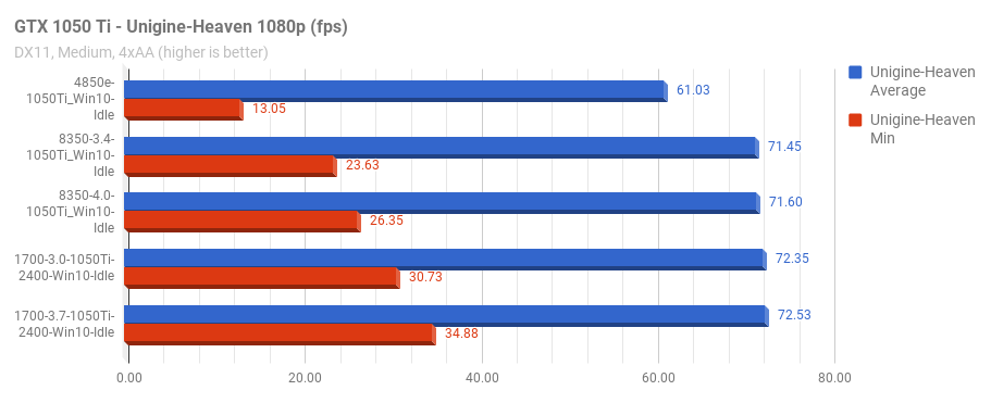

Unigine-Heaven FPS
- That 4850e lives!
- More importantly, it seems getting a better CPU will increase minimum frame rates significantly.
- This test also does not properly factor in that minimum frame rate increase into how it reports averages.

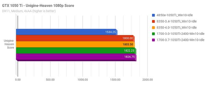

Unigine-Heaven Score
- The minimums are not reflected in the score at all.
