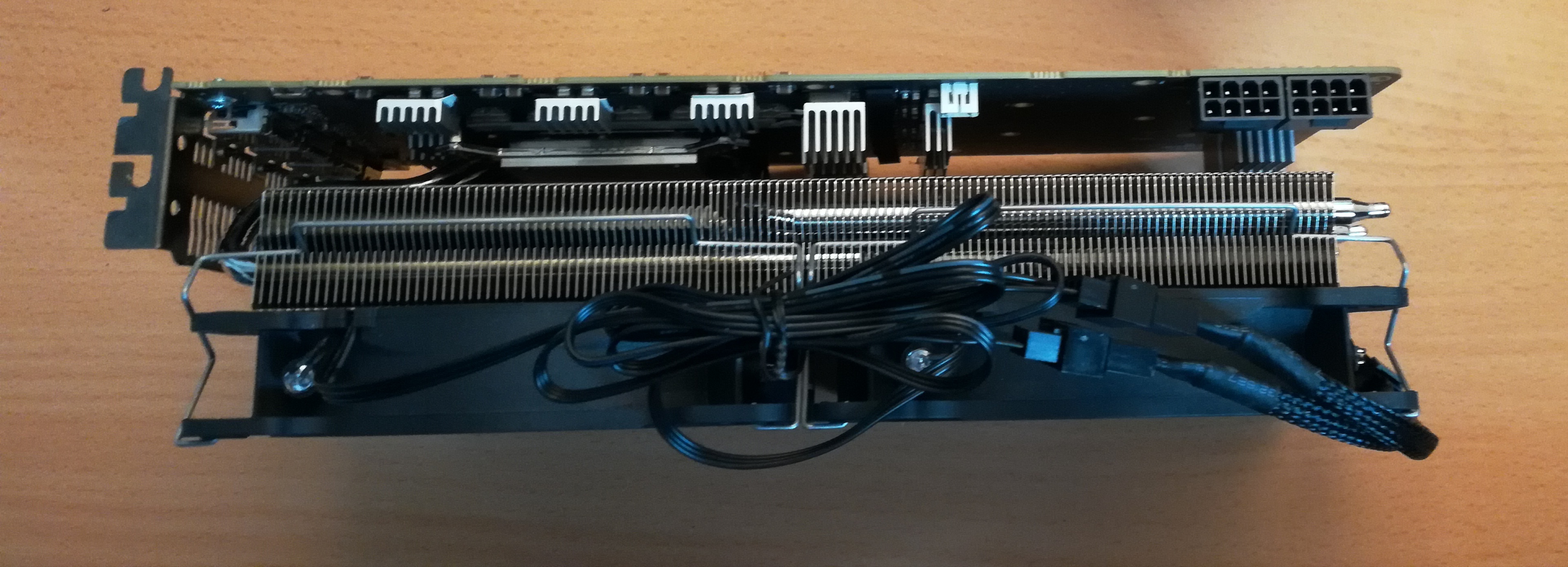

I have 2 Sapphire Vega56 Cards, identic and one I have modded

how is that connector called?
Thanks!
will arrive on monday.
thanks brother!
That looks like a Morpheus II to me.
If it is, can you check the manual if the R9 FuryX is supported? Would help this guy a lot.
It is, says on the box and on the website.
can go right ahead with this mod.

Same card stock cooler
Looks good.
I wonder if you could fit one of those low-profile fans under the rear of the heatsink.
Nope, maybe without the heatsinks? But would that be better and/or how much of a difference would there be?
It is not an advantage in a thermal sense, but in cases like mine (retarded HDD-cage position), it would allow the cooler to fit.
i have a dg 87 so much much room for airflow and a bunch of fans

I assume you just plugged both fans into the connector on the GPU and had no issues with overloading the onboard fan controller?
I am slightly worried that I’ll fry something.
Sayonara!
Shadow
Tbh i dont think it will overload the connector nor anything else. I dont really have a clue on why it wont happen but i cant imagine that a pwm header on a pcb can draw so much voltage that it fries something.
I havent tested it yet, i will report it i fry my card. :joy:
Terve!
So, I used a sacrificial 7950 and it held out well. The fury X has been modded with the new cooler and is currently awaiting stress tests.
First results show temps up to 72°C - which isn’t amazing but at least the GPU is working.

Direct comparison of a stock v56 and modded v56
It now lives in my computer
Since I finally installed my modded V56 and got it running very nicely (60fps solid in rocket league on 3440x1440x) now the whole software thing starts.
