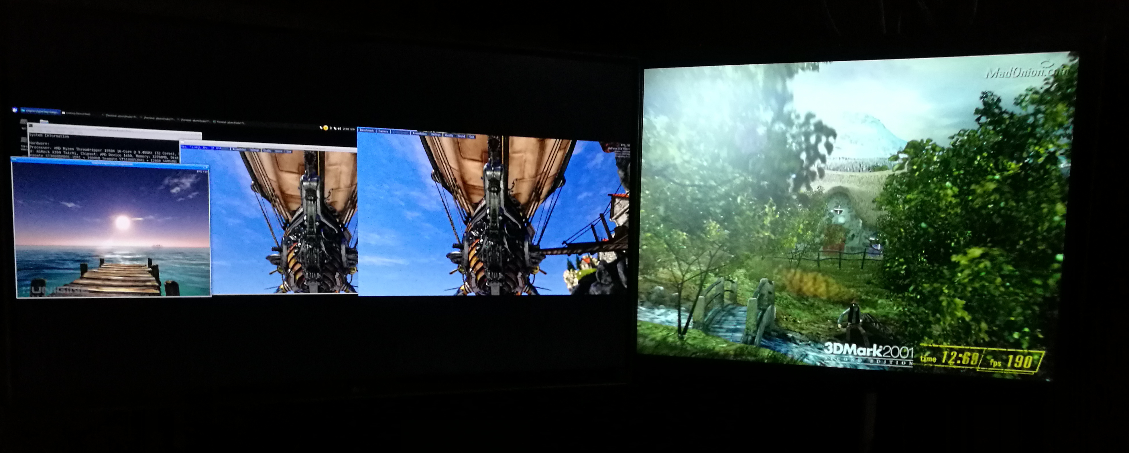

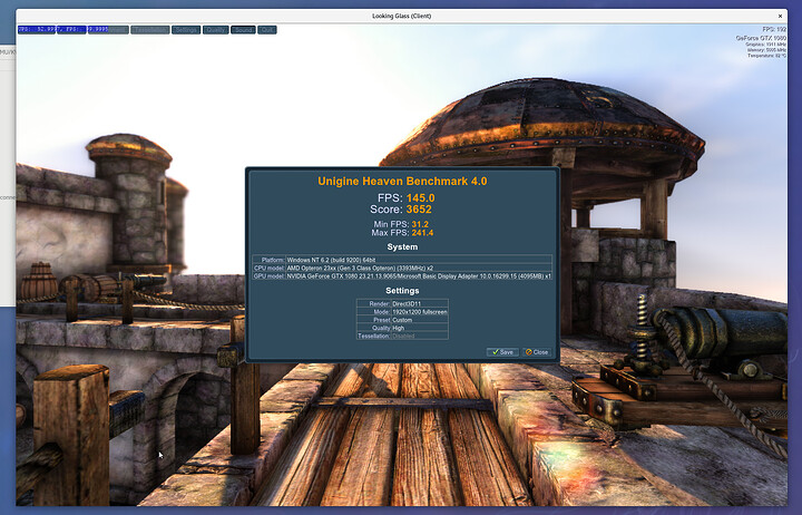

I can confirm the patch works great on Fedora 27 with both nvidia 1080/1080ti, Radeon Pro WX5100, Fury and Vega.
