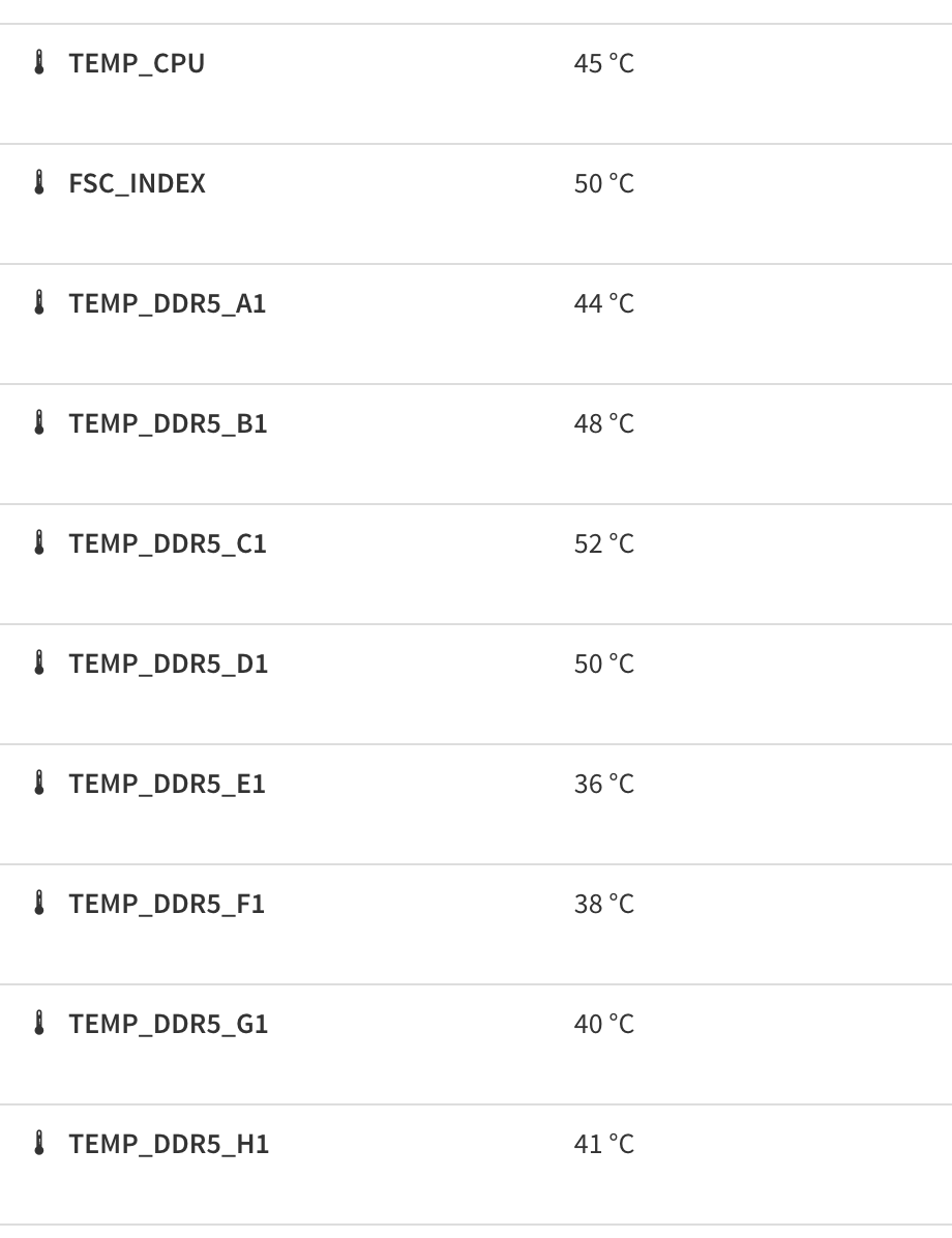

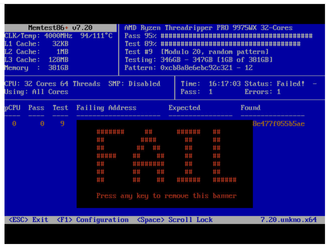

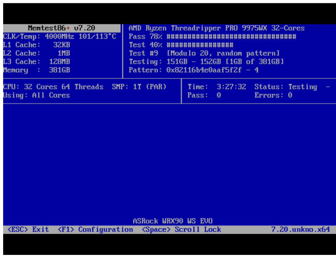

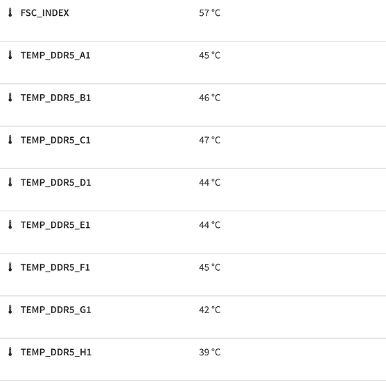

I left all the fans on full blast, for 16 hours. This is the current situation.
Much better! That’s giving me confidence that it’s just a temperature issue. It does also seem that SMP causes more failures. I didn’t catch it in time this run to turn it on.

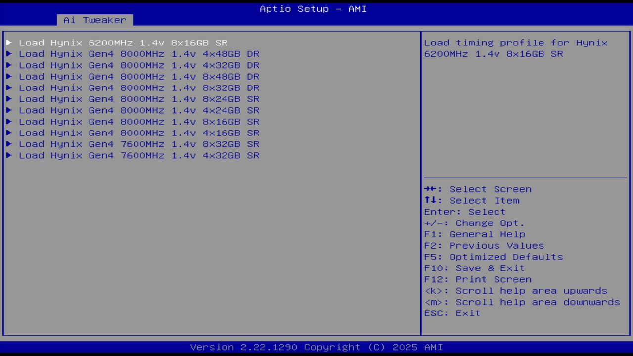

Especially about that 8000 8x24 SR ASUS preset:

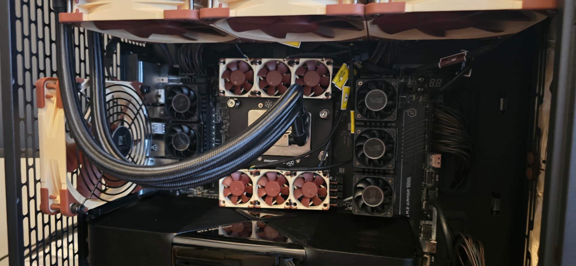

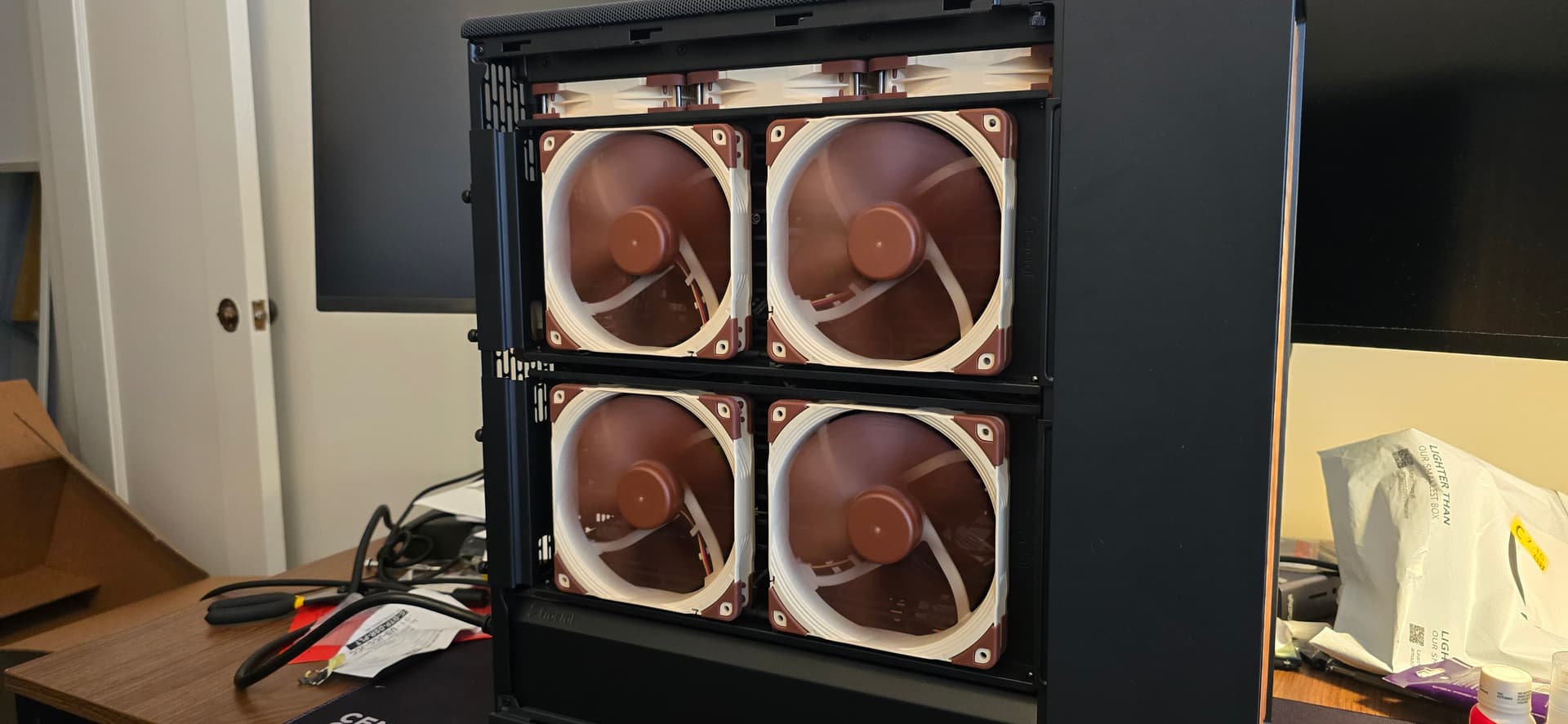

Finally got some 40mm fans, will try some configurations soon.
Well, let’s see how jank this is. No real mounting points or anything. Could use a 3D printer for sure.
I tried to see if I could do a parallel setup, or I was going to pull though instead of push onto the ram, but I need a better mounting solution. There wasn’t much space either.

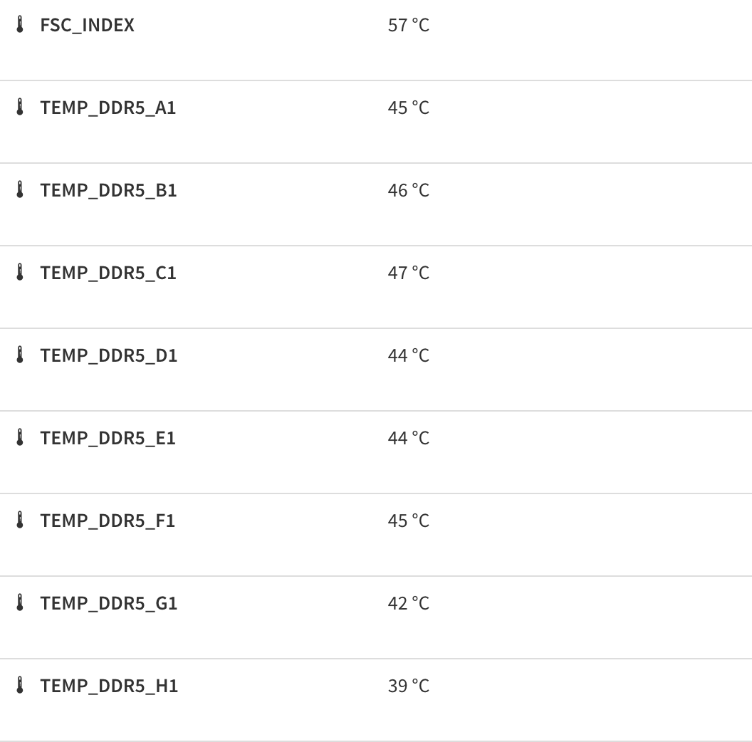

Seems a lot better, at 40% fan speed.
Interested in doing a memtest now and seeing if it will complete.
Nice! Fans on full blast, but about to add a couple more and see…
Okay, less and more jank

Tring some tests with the ram fans at 40% which isn’t bad on the ears. Everything else is on “optimal” fan curve default settings.
I also did a funny and bought another Fractal North XL Mesh to get another side fan bracket. I looked everywhere for a loose one and on their site for accessories, guess that one will have to be my next build.
No room for a push-pull setup on the rad, but if the ram has no errors at 6800 and I can run PBO for 5.2-5.4 GHz while maxing out my 3 GPUs and storage card, pretty damn good for me. Counting the PCI cards, there are now 25 fans in this beast.
I wonder if pulling up through the RDIMMS might be better, or if I could configure some side panel fans as exhaust, but IDK atm.

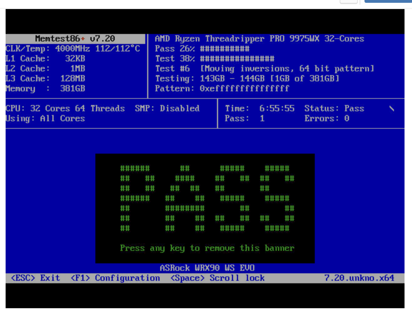

Seeing if memtest86+ with SMP enabled passes with these fans on mostly quiet mode for now.
So far so good!
