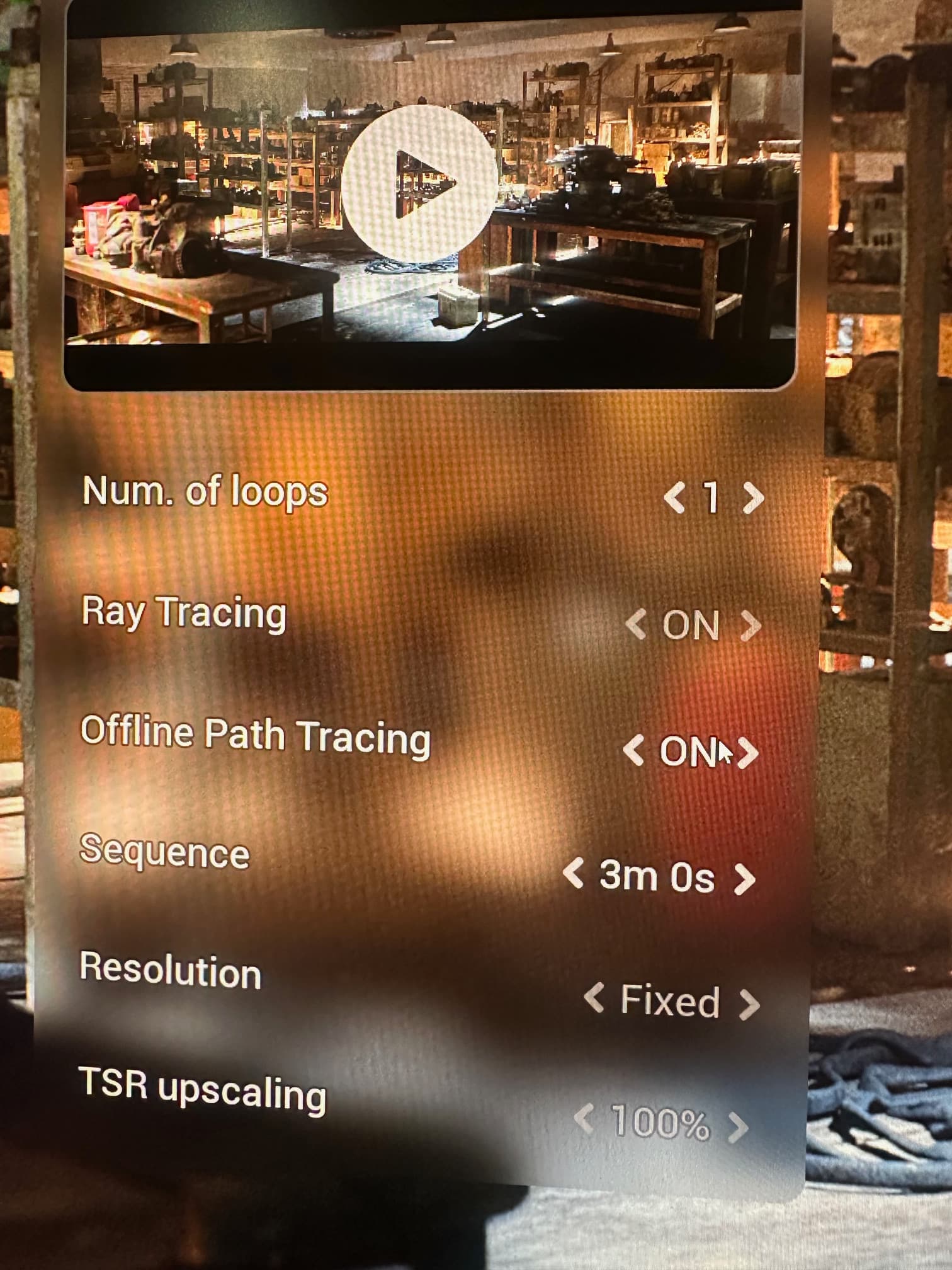

I’ve been testing some UE5 titles and the findings are consistent. UE5 titles can also apply mGPU to path tracing as well with engine 5.1, 5.2, 5.3 and 5.4
Other titles are Hellblade 2, Silent Hill 2, and the Talos Principle 2, as just a few examples.
I have also found that some UE4 titles allow for mGPU
For the Matrix Awakens City Demo UE5, 5.2 and 5.3, I almost scale to double the performance using the second card , however moving to same demo in UE5 5.4 the performance increase for the second video card is only 45%.
Again, everything is et to max textures, max eye candy, max ray tracing, etc and all at least at 4K without using DLSS or FG
so… milage may vary with development.

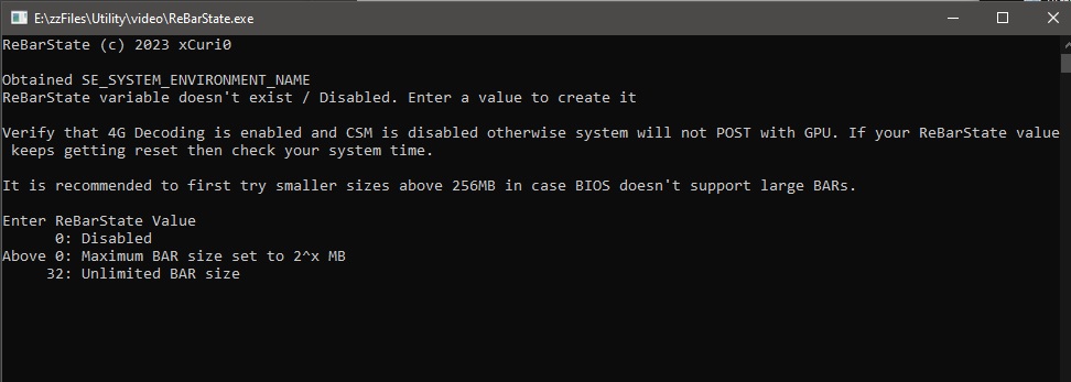

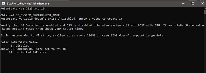

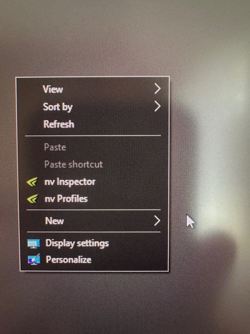

Please optimize and enable Resizable BAR to “unlimited” and if you are using nVidia drivers you may want to turn OFF shader cache.

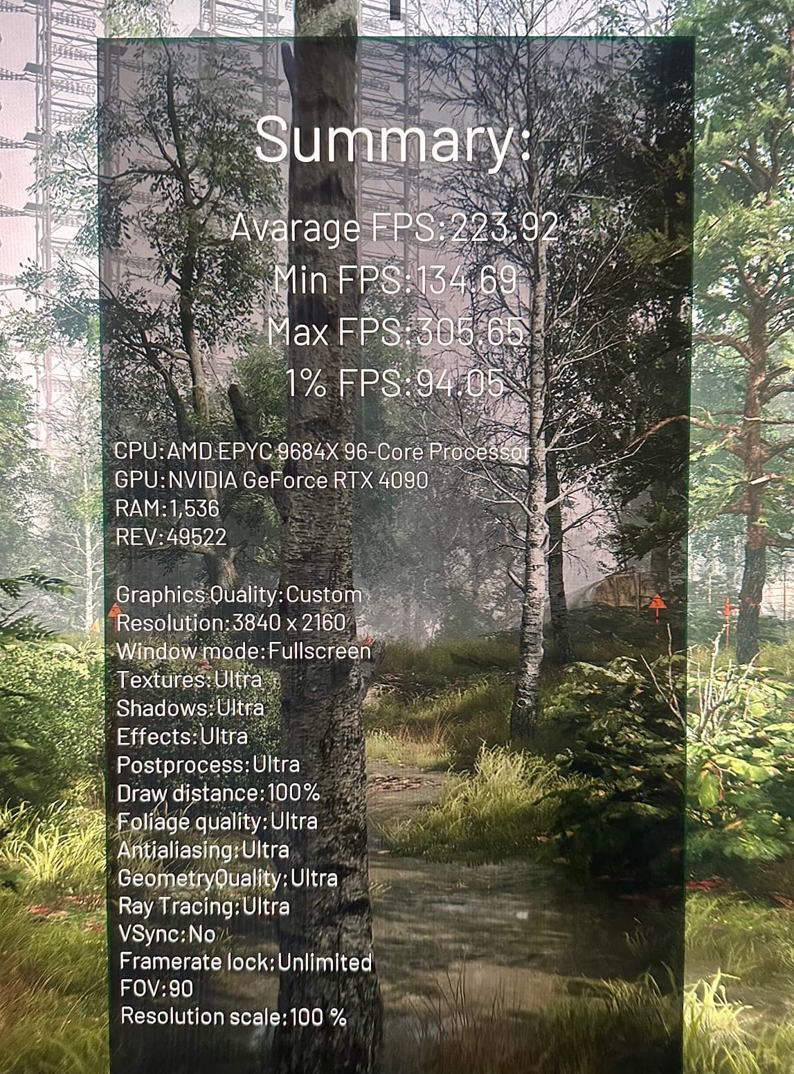

Lets use an example that allows for disclosing the settings used, so that folks can see the end result:

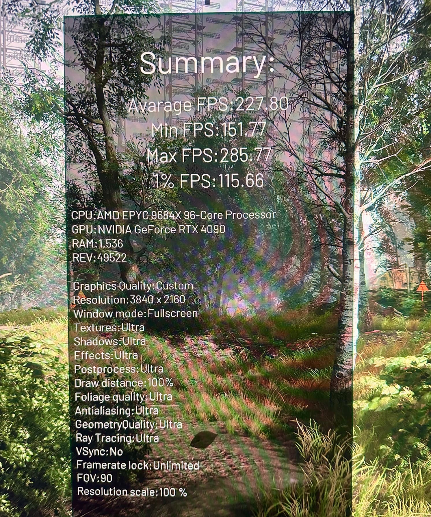

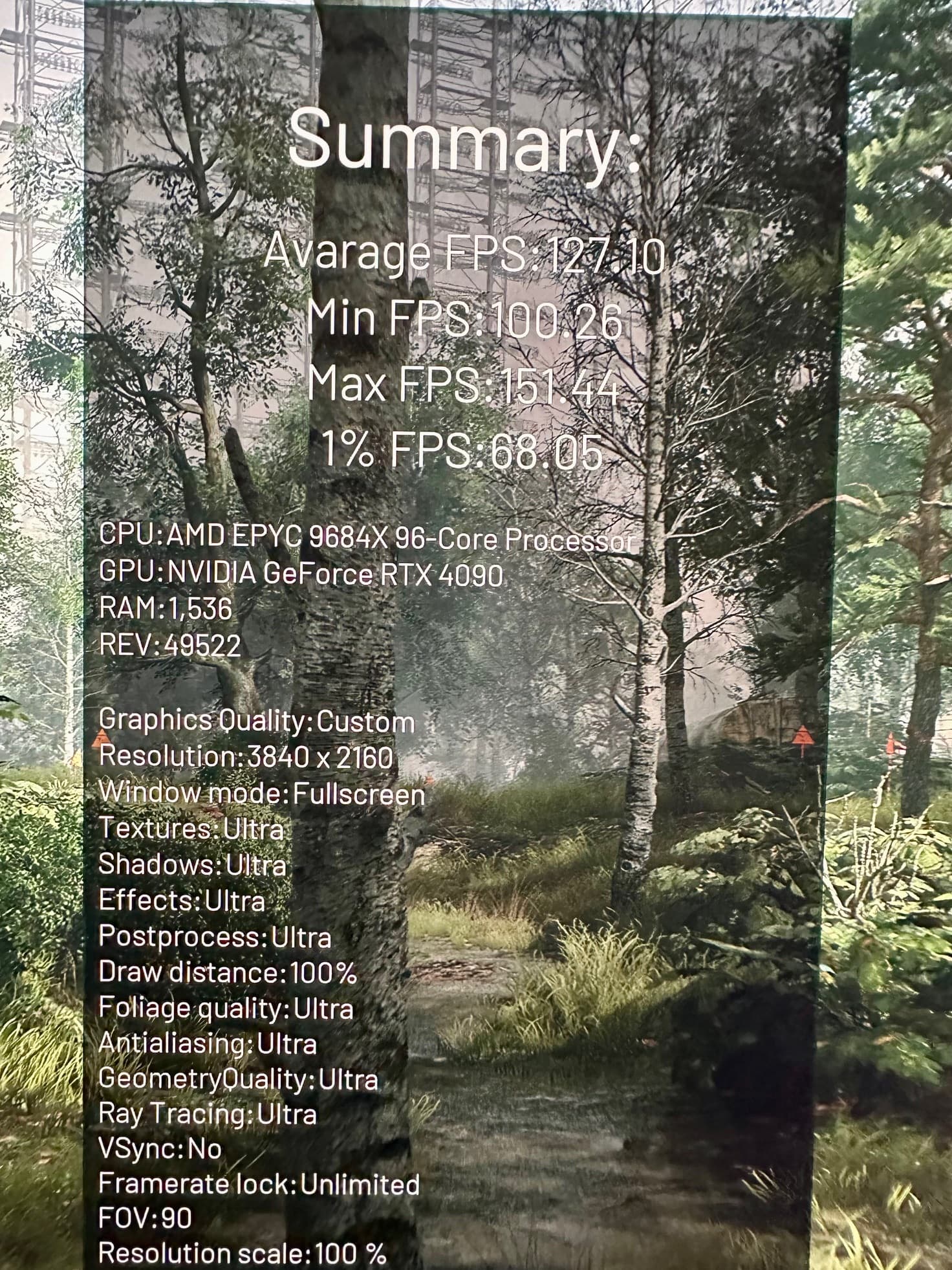

I will use Chernobylite a UE4 title as a representative as the benchmark summary screen actually lists the setting used in the benchmark (wish more titles did this)
Again, max eye candy, to me, means: No DLSS, No FG, No Vignetting, no noise, no Film Grain, 4k (or above) and using 120hs + monitor and HDMI 2.1 or DP 1.4
1 GPU Chernobylite MAX settings all with Raytracing set to ultra, 4K, NO DLSS and NO FG
2GPU Chernobylite MAX settings all with Raytracing set to ultra, 4K, NO DLSS and NO FG
In this example, FPS went from an average of 127 FPS to an average of 228 FPS
228 FPS with Ray Tracing set to ULTRA and no DLSS ! This why one should understand mGPU.

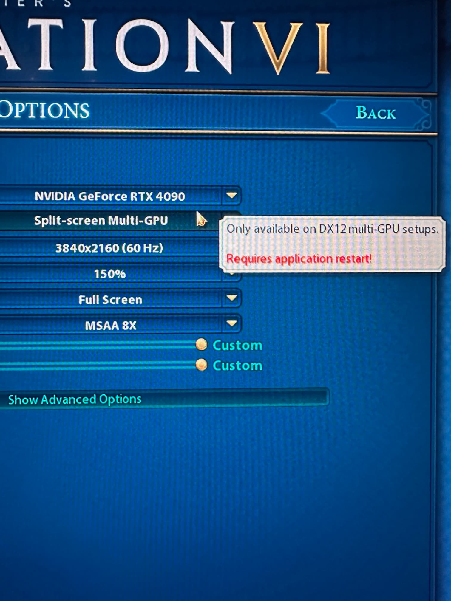

For some apps or games setting up mGPU is available through the interface complete with choices and selections, ithers is just a check mark and for some others its only possible with xml, ini, and cfg changes as well as launch parameters,

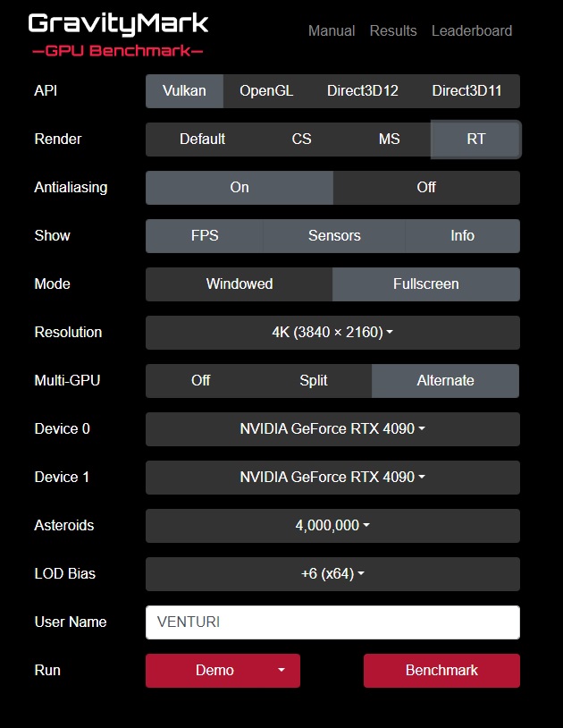

Gravity Mark interface:
Ashes of the Singularity interface:
Civilization IV

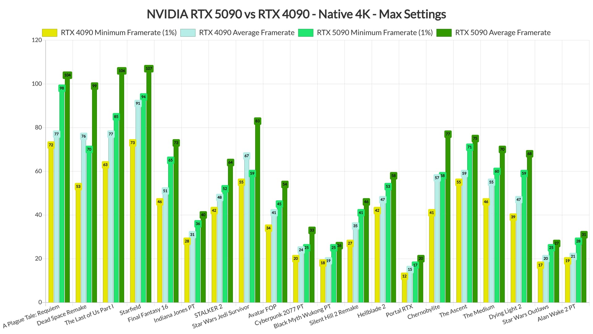

I’ve been watching reviews of the 5090s and I am concerned. Apples to apples, my 4090s, non DLSS, 4k max settings are higher than any of the reviewers
example DSOG review of 4090 vs 5090, look at Chernobylite bench
and here is my 4090s. higher than the 5090, also in AW2, Cyberpunk, etc (all non DLSS 4k max setting)
even lowest 1% is higher than the 5090, and I don’t overclock
Hope the 5090 is not a disappointment for those of us that don’t do the DLSS gimmick
My single 4090 score in chernobylite, 4x, max, Ray Tracing set to ULTRA
My Dual 4090 score (mGPU not SLI)
Benchmark for 5090 review at DSOG
Hence, my concern, as all my non overclocked 4090 scores are HIGHER than the 5090 non DLSS scores.

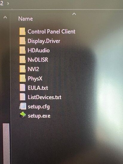

Situation and gap got worse when I used the new 571.96 driver as I gained 4-5%
driver found in the new 12.8 CUDA toolkit at
I loved the video review that he made for LV1 Tech on the 5090, and I hope apples to apples the gain is the same.

Hi and thanks for bringing mGPU back from the ashes (pun intended), I haven’t heard of it in ages and I am glad that this is apparently not abandoned and I always wondered if heterogeneous mGPU could be viable. So I added my old 3070 alongside a 4070ti and followed your advice to start with gravity benchmark and here are my results:
–Setup–
5900x 32GB 3600c16 Asus B550-e
PNY verto 4070ti + 3070FE
All watercooled (custom)
–Settings–
Render: Default
AA: On (Temporal)
Mode: Windowed
Resolution: 2k (2560x1440)
mGPU: Alternate (AFR)
Asteroids: 200.000
LOD Bias: Default
  • Vulkan score
    3070 (mGPU off): 31,062 / 186 FPS
    4070ti(mGPU off): 50,556 / 302 FPS
    3070+4070ti AFR : 68,414 / 409 FPS
  • DX12 score
    3070 (mGPU off): 32,219 / 192 FPS
    4070ti(mGPU off): 48,008 / 287 FPS
    3070+4070ti AFR : 62,012 / 371 FPS
Notes:
  • Something weird the 3070 is reported as GPU0 in windows and If I select the 3070 as device 0 in the benchmark it uses the 4070ti (which is reported as GPU0 using command: “nvidia-smi”). 4070ti is on PCIex16_1 slot and 3070 on PCIex16_2 slot. Both run at PCIe gen4 x8 mode as per motherboard default.
    No idea how it affects the benchmark but for AFR benchmarks I used 3070 as device 0 and 4070ti as device 1, If I do the opposite I get worse result (vulkan: 52,658/ 315fps ; dx12: 53,370/ 319fps)
  • During AFR benchmark 3070 is at 100% usage while 4070ti is around 75-80%
Some guesses on heterogeneous mGPU AFR (to be tested for confirmation):
  • AFR performance seems to be limited by the weakest GPU, although vulkan seems to give little more than double the 3070 performance dx12 is slightly below double the 3070 performance, so my guess is that if I were to used a 2nd GPU that has less than half the performance of the 4070ti it might be worse than using just the 4070ti (which means forget about iGPU or your 10yo GPU boost dream…) I may test it later if I find a weak GPU to confirm that though
  • Same thought for VRAM, since both GPU need to render frames in alternance they use the same amount of VRAM so it might end up to be limited by the GPU that has less vram
  • Obviously it would work best with 2x the same GPU but It still seems to give great result so it is worth digging imo, I suggest to use GPU that have closest amount of VRAM and performance

I’ll try to map out again example Chernobylite and post, that one was more complicated.
The easier examples are Strange Brigade, Ashes of the Singularity and Gravity Mark as they work without too much fussing and have friendly menus to get you there. GravityMark is a great tool to hone and optimize you’re setup.

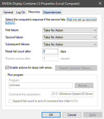

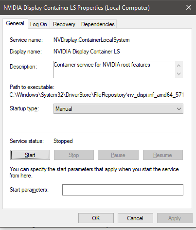

Nvcontainer / nvidia service breaks many mGPU attempts
I have it turned off in services (manual)
I can’t seem to included an image in this message editor so I will provide that setup in your main thread.

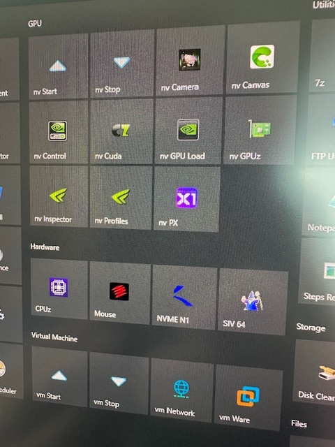

I use a right click shortcut to control the set up but if needed I use the start stop shortcuts
here is my desktop right click:
I disable the NCContainer / nvidia service but if I ever need to get to it I start and stop it with shortcuts:
(yes, all my tiles are orderly and well behaved and are transparent without any vendor or MS added colour, I also have no ads running
for tile transparent background colour modify the xml
with:
BackgroundColor=‘transparent’/>
…easy enough, just try it
nvcontainer set to manual in services as such:
service
start
start stop shortcut commands are easy:
net start NVDisplay.ContainerLocalSystem
net stop NVDisplay.ContainerLocalSystem

you must have resizable BAR on in the BIOS and you need to set the Resizable BAR to “unlimited” ( I believe the switch choice is “32” in the setting.
in windows you can use (if your hardware is capable) the :
ReBarState.exe

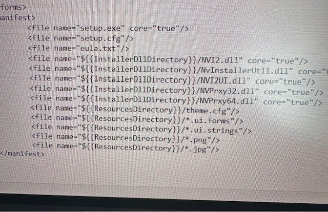

the driver itself should only include these things in the downloaded driver and remove so that this is what is left:
and modify the bottom of the CFG file so that the three lines under the eula are gone, like this:
IMG_6703
ONLY then di the exe setup

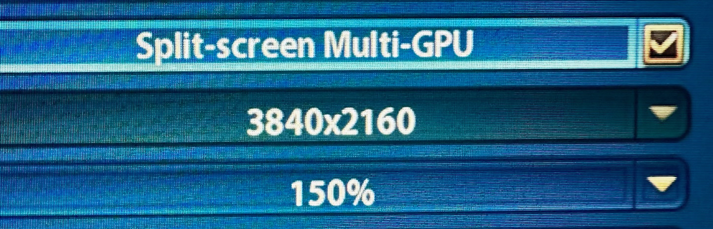

the next “easier” game to set up is Civilization IV and also a good introduction to what lies ahead.
step 1: DO NOT USE STEAM VERSIONS OF GAMES, only standalone versions without a third party check in “rent to own” games. Games that the version lets you launch the game from the real exe in the game folder.
Civilization IV, you’re goal is to enable this check mark without SLI or NVLink:
in in fraxis, in the graphicoptions.txt
set these changes:
;Set DX12 compute queue usage on (1), off (0), or platform default(-1).
EnableAsyncCompute 1
;Enable DX12 split-screen optimizations for multi-GPU systems. On (1), Off(0), or platform default (-1) [Platform Default is OFF, but may change in the future.]
EnableSplitScreenMultiGPU 1
[Video]
;Experimental rendering modes
RenderMode 1
;Experimental resolve modes
ResolveMode 1
and save the file as “read only”
you can also go into the other config files and manually set the amount of threading for cpus and other features, it scales well.
I have to look up which version I have as one of the updates from Fraxis broke all those GPU and CPU perks.

Bare in mind that I am also waiting on a pair of 5090 FE. A pair of 4090 FE, as I have right now, quite puzzlingly, is out performing by 130% the reported benchmarks of a single 5090.
The pricing of 5080 is street value higher than 4090.
I would also bare in mind that there have been so many issues with the 5090, and the worst being architectural issues and missing ROPs, I think anything else I could handle, but chip flaws…
Knowing myself very well - If I had a pair of 5080 lying there I’d probably have cracked them open on the walk back from the mailbox. If paid higher than retail… then its more subjective.
