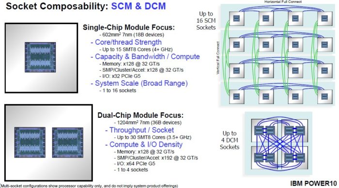

Timothy Prickett Morgan has an article that speculates on how the POWER10 SCM vs DCM (single vs dual chip modules) may fit into IBM’s future line up:

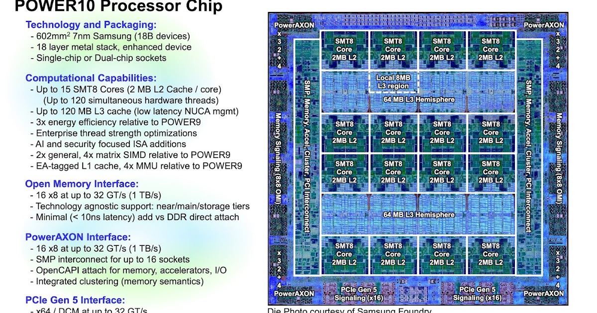

An overview of I/O changes and possibilities in POWER10, also by Timothy Prickett Morgan,
Note that this article seems to think the POWER9′/AIO/Axone chip may still be released, but from my discussions at the weekly OpenPOWER Virtual Coffee Calls (previously mentioned by @Nawrocki) I am quite certain the Axone chip has been cancelled.
