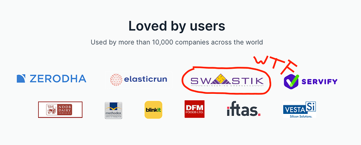

Has anyone used ERPNext? Looks promising…
Apparently the project is based in south Asia. Definitely did a double take on their client list…
Before I duckduckgo that, perhaps it could be an Indian company specializing in selling yoga mats?
The symbol was a symbol of peace and friendship that the Nazis co-opted. Kind of how congress critters pass bills with misleading names that do the exact opposite.
