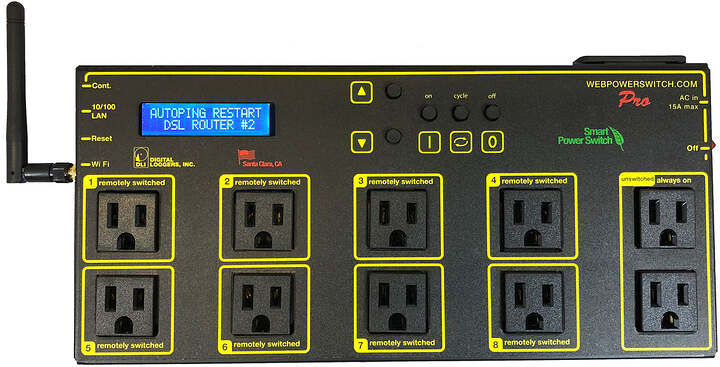

Do you have one of those 120v Pro Switches? Not sure I have a use for it, but looks interesting.
Im using it on a work thing. I need remote controlled power thats toggled via web with a somewhat clean interface and it must be COTS so no NRE. Figured some data center jockies here might know
Its going to have a weeee little netgate 1100 for a switch+firewall for the two devices hiding out in the remote box. Mainly because pfsense is easy and reliable for me and I dont want to fuck with it. The budget for the switch was <2 benjies so I wanted a reliable all in one device for that with wireguard and/or tailscale support
Sounds like you want a switched network PDU. Commonly found in data centers.
Like this one:
You can find any variation you may want, browsing UPS manufacturer’s websites:
Thanks dude. Looking for small but ill check around. Eaton is a great brand
It doesn’t need to be big. In fact it needs to be small. Its mostly going to have low power arm devices and an ARM switch+firewall. I mean the UPS on this will be a small 700VA
