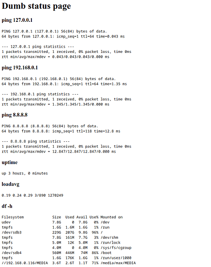

You can create an equally-simple CGI script(and do a lot more).
This is of course not static anymore, and has some security considerations(don’t host this publicly), but it’s dead simple:
#!/usr/bin/env bash
set -euo pipefail
#readarray hostArr < /path/to/hosts.list
hostArr=("127.0.0.1" "192.168.0.1" "8.8.8.8")
[ "${REQUEST_METHOD}" = "GET" ]
echo -e "Content-type: text/html\n\n"
echo -e "<h1>Dumb s[::ffff:127.0.0.1]:58536: response:404
for host in "${hostArr[@]}"; do                         [::ffff:127.0.0.1]:58540: response:404
    echo "<pre>$(ping -c1 ${host})</pre>"
done
# bunch of extra info
echo "<h3>uptime</h3><pre>$(uptime -p)</pre>"
echo "<h3>loadavg</h3><pre>$(cat /proc/loadavg)</pre>"
echo "<h3>df -h</h3><pre>$(df -h)</pre>"
echo "<h3>ip a</h3><pre>$(ip a)</pre>"
echo "<h3>ss -lpt</h3><pre>$(ss -lpt)</pre>"
echo "<h3>ps -aux</h3><pre>$(ps -aux)</pre>"
echo "<h3>cpuinfo</h3><pre>$(cat /proc/cpuinfo)</pre>"

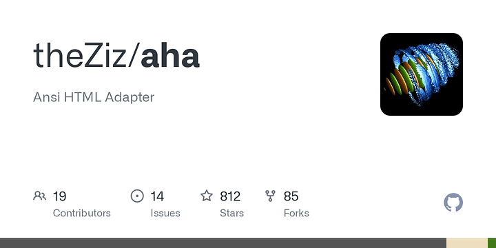

for producing html from shell output, `aha’ may be of interest
example
while true; do echo q| htop |aha --black --line-fix > htop.html; sleep 1; done
I’m sure coloring in ANSI escape sequences to shell scripts we all enjoy even more than formatting html, and it’s even possible to run them in tmux and tee the output to a webpage at the same time.

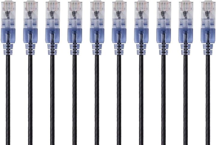

I know I’m late to this party, but these slimline cat6a cables are great. I don’t want to use anything else ever again. The only flaw is that the protective tab that hovers over the release tab can easily get caught underneath the release tab making it impossible to remove the cable until the tabs are swapped again. Mild annoyance though compared with how insanely thin these cables are compared to normal patch cables, and especially compared to bulk CAT6A.
Now if only they made SFP28 DACs this thin… I guess fiber is that thin, but who runs 1-5 feet of fiber?
I know lawrencesystems always raves about those
Do you reterminate these to your desired length? Can these even be reterminated reasonably well enough by us or do we need more specialized tools?
Patch cables are never meant to be re-terminated. Of course, you could technically do it, but it most likely would lose the signal integrity that qualifies it as CAT6A. I believe bulk CAT6A is usually of firehose chonk because manual termination inherently introduces much more signal degradation than factory terminations. Probably even worse for patch panels and surface mount boxes.
