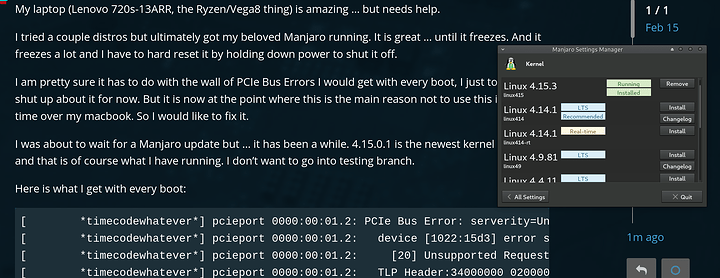

My laptop (Lenovo 720s-13ARR, the Ryzen/Vega8 thing) is amazing … but needs help.
I tried a couple distros but ultimately got my beloved Manjaro running. It is great … until it freezes. And it freezes a lot and I have to hard reset it by holding down power to shut it off.
I am pretty sure it has to do with the wall of PCIe Bus Errors I would get with every boot, I just told grub to shut up about it for now. But it is now at the point where this is the main reason not to use this install full time over my macbook. So I would like to fix it.
I was about to wait for a Manjaro update but … it has been a while. 4.15.0.1 is the newest kernel there is and that is of course what I have running. I don’t want to go into testing branch.
Here is what I get with every boot:

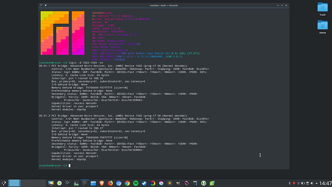

First can you find out what device is involved here?
lspci -d 1022:15d3 -vv
I’m assuming it’s still the same device involved here. If it’s changed use something else than 1022:15d3
Then we can continue.

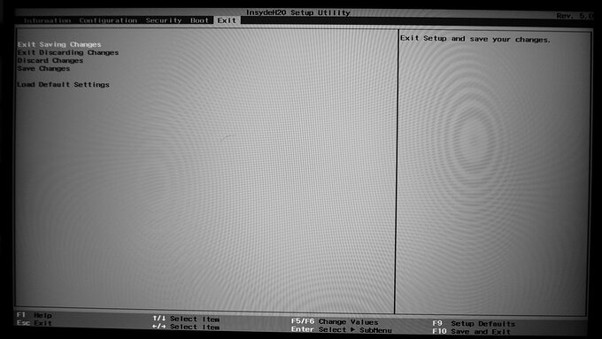

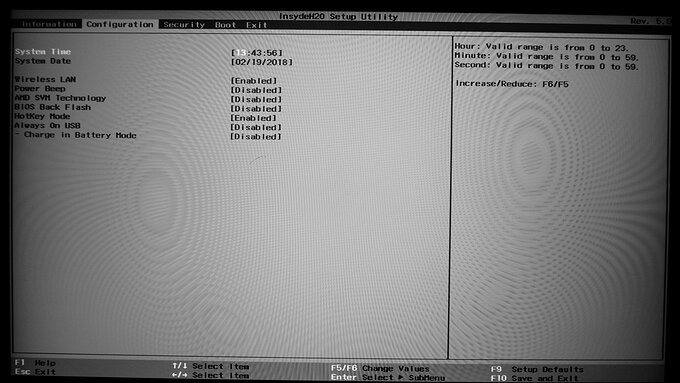

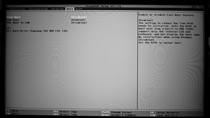

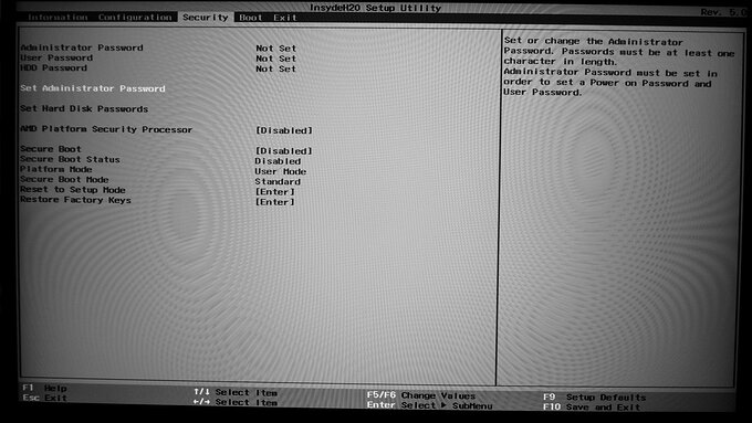

Also @noenken can you have a look into the laptops BIOS (if possible) and list what options are available?
I’m particularly interested in anything related to power management.
Try to photograph or screenshot all menus if it has that feature.
No, I didn’t think it would be that special. In general I assume I’m just being stupid with something or that there is a solution already and I just missed it.
Unfortunately there is very little at all. No submenus even…
Here is the output from lspci:
Wow that UEFI is basic.
Also I advise you remove that first image. It contains your device UUID serial number and OS License Keys and can be used to get a free Windows 10 install
Now obviously you use linux, but you might want to not give those away just yet. :smiley:
As for the device throwing the PCI-e error.
It appears to be the Standard Hotplug Controller Driver.
Thus I now wonder which device this may actually have to do with.
The module driver:

You can try blacklisting the shpchp module which should disable PCI hotplugging and see what happens. I can’t think of anything right now that would need it.

I am running Manjaro KDE 17.1.5 on kernel 4.15.4-2 at the time of this post.

In grub I have blacklisted shpchp without any observable (for a noob) effect and sp5100_tco which at least got rid of that one error seemingly without any negative outcome otherwise.
Smart as well as fsck had nothing bad to say about my drive or any partition on it.
I have set pci=noaer to get rid of the wall of PCIe Bus Error messages.

Have you run the kill Ryzen script? The cpu might possibly have the marginality error? It’s a 2000 series CPU so I doubt it… Buuuut.
Also disable pcie aspm?
That would suck in a laptop. Most of all for AMD. But I’ll check.
Can’t because UEFI has no options… like none.
Try the kernel pcie_aspm boot param?
I … uh, I totally knew that. …
Will try, thanks. :grin:

I ended up switching to testing branch of Manjaro. So, 4.16rc2 now.
I tried not to but I definitively don’t want to wait another month or so.
The update fixed the freezes on boot, so that is something.
