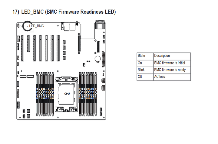

If you suspect that BMC isnt working, check this LED on the board (pg 25 of manual):

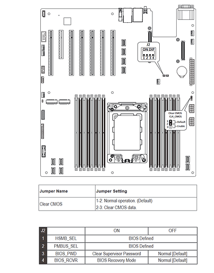

And there is a dip switch on the board between the mezzanine and the ram that will allow you to reset the supervisory password and/or enter bios recovery. The clear cmos jumper is also shown here (pg 27)
Oh wow, never seen this before. Activating Pin 3 of J2 is supposed to rest the PW. The screen even shows that the password reset jumper has been activated after booting the system. But, the BMC login still fails — neither “password” nor the serial number of the MB works.

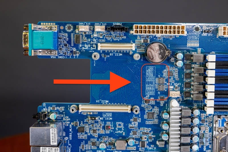

However, for the curious ones, here is where you can find the switch:
Pin 3 does not reset the bmc password. Pin 3 resets the bios password, as shown in the final image in my last comment. If it has a bios password, then it can be reset with that pin to be able to boot into and reset the bmc password using ipmitool.
