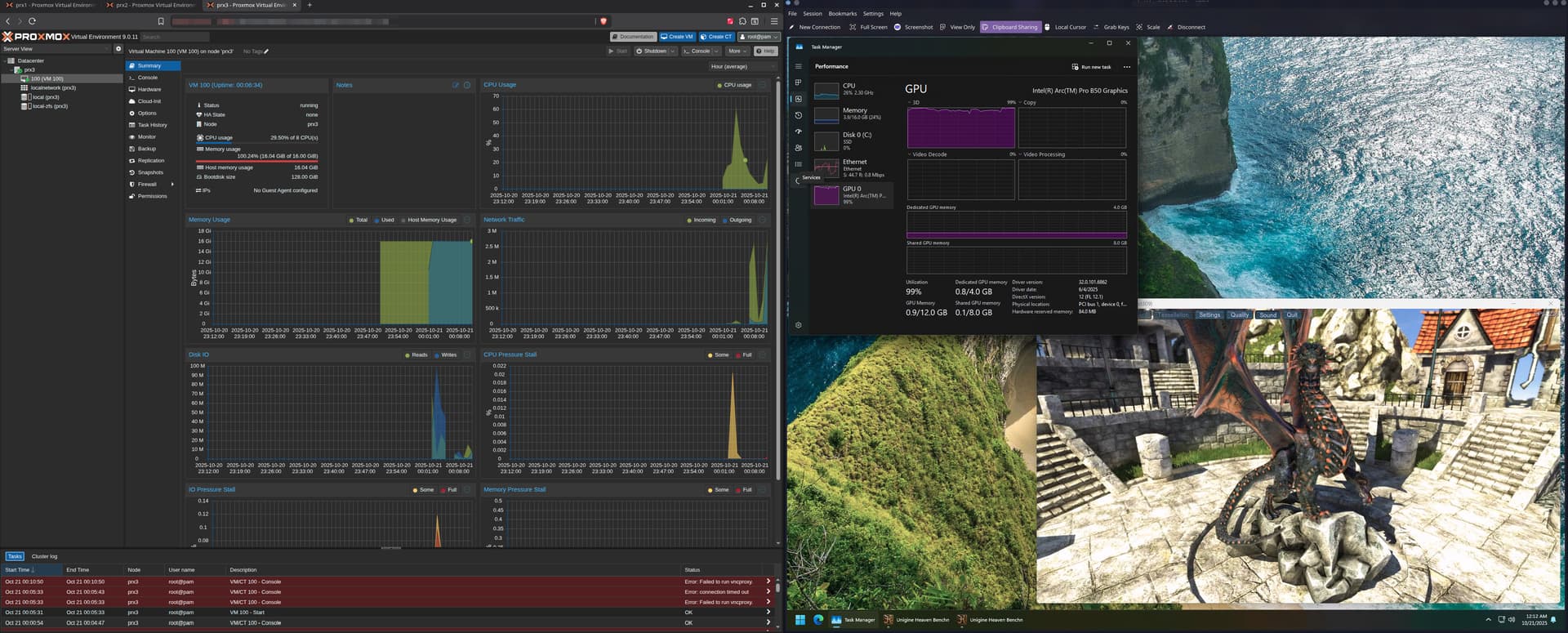

Small update.
I’ve run valley benchmark overnight on non-SR-IOV passthrough VM and there were no issues. It’s stable in basic passthrough.
My motherboard has some ASPM settings but disabling them don’t change how linux sees ASPM state on the gpu and it’s root port. It’s probably working because it helps with fan behaviour.
Manually disabling ASPM while ASPM is disabled in the bios doesn’t help further. Enabling ASPM in the bios and disabling it linux with setpci doesn’t help with fan. It’s strange.
Superposition may be slightly more stable with ASPM disabled in bios but I still cannot finish 2 running on different VMs at the same time.
With ASPM disabled fan behaves better. No max fan GPU with idling gpu.
