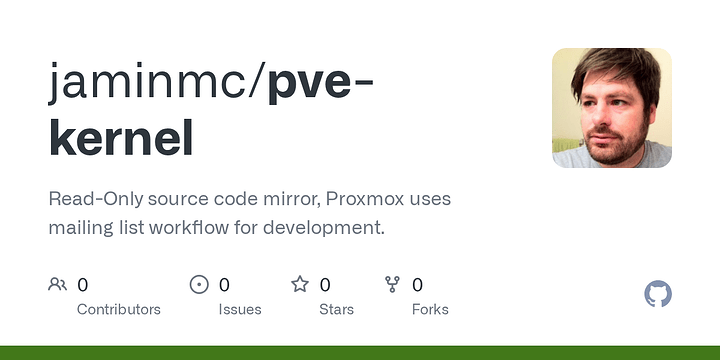

Update: This guy beat me to it!
this is the general build guide to build your own kernel. There are .debs provided there in release, but this isn’t too hard to build your own kernel and look over the patches there for any changes. It’s a reasonable starting point.
TODO Notes
I have some notes; should submit a Pull Request and/or clone that repo. High-fives jaminmc , nice work.
Ah, he ran into the same app armor issues:
*Ok, I have worked on this for over a week. I kept having Apparmor issues, as the newer kernels changed it, and my podman container was causing it to crash, and made my system unstable. Then today I had the bright idea to just patch it back to the 6.14 apparmor. Well, that didn’t compile, but with the help of Cursor. I was able to make a 2nd patch that fixed the older apparmor to work with 6.17.
GitHub - jaminmc/pve-kernel: Read-Only source code mirror, Proxmox uses mailing list workflow for development. is the git of all the changes I made to make it work. along with GitHub - jaminmc/pve-firmware: Firmware for pve-kernel for the firmware. So you can compile it yourself, if you don’t trust me. (I wouldn’t trust any random person building the kernel)
But if you are willing to risk it, I have my compiled debs here: https://github.com/jaminmc/pve-kernel/releases/tag/6.17.0-5.5*

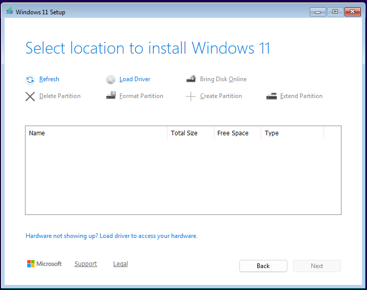

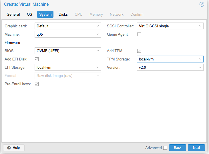

Set up the VM
Do the normal windows install, with something like these settings. We do not map the GPU yet!
Note I recommend mapping TWO isos to the vm, one that is your windows install ISO and one that contains the VirtIO drivers:
(download from proxmox or IBM)

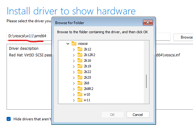

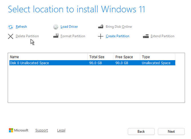

Disk setup (oh no, there is no disk!)
just hit browse, and go to vioscsi
and install those drivers. then the disk will show up:
… this driver has much less overhead and performs well vs alternatives.

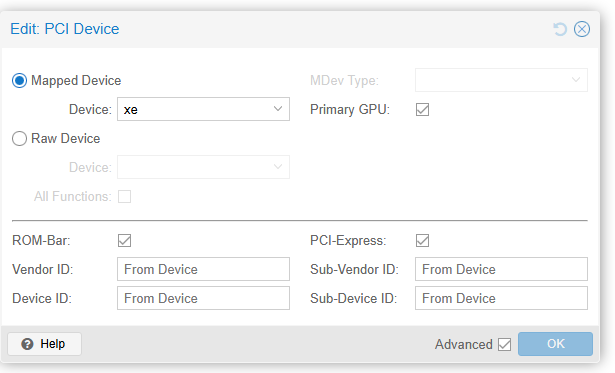

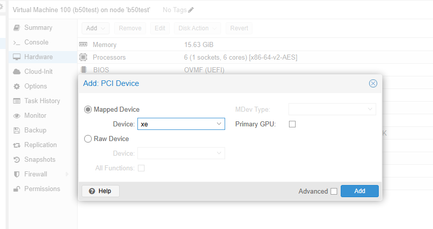

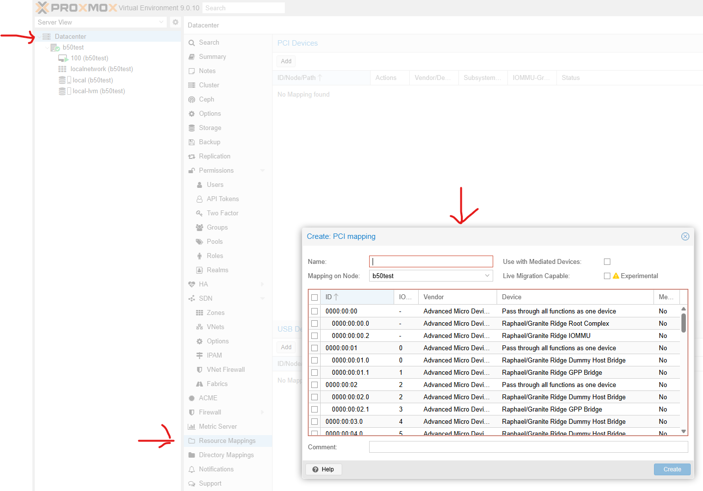

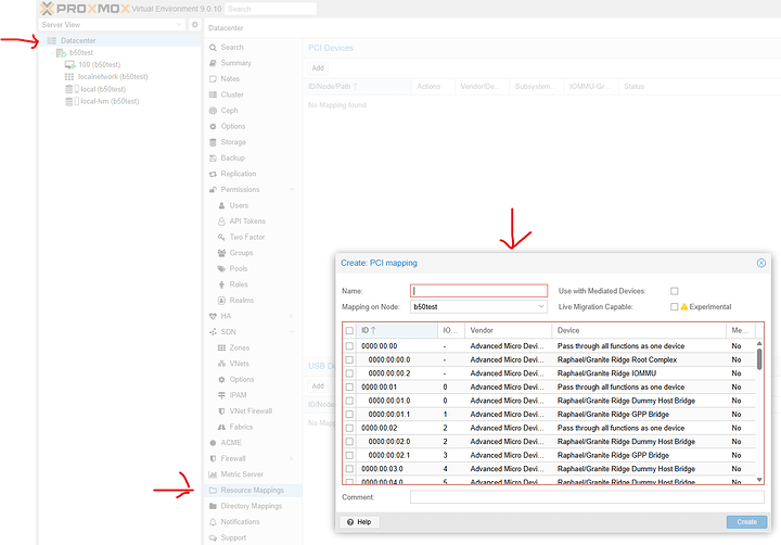

To attach the SR-IOV virtual funciton, that is done in the datacenter area of proxmox:
Datacenter > resource mappings > add the .1 .2 .3 .4 (etc) virtual functions that showed up in lspci earlier.
then, in the VM you created, it is possible to add a pcie device:
Note: Be sure to select advanced and then pcie=1
It is possible to add it as the primary gpu device but generally I don’t do that until 1) it is on the network and RDP is working and 2) the drivers are installed. So it can be a bit of a two step process here.
It can also solve some weird bugs in this beta state to remove the spice/vnc display adapter once you have this one working. Hence why it is a good idea to setup RDP ahead of time.

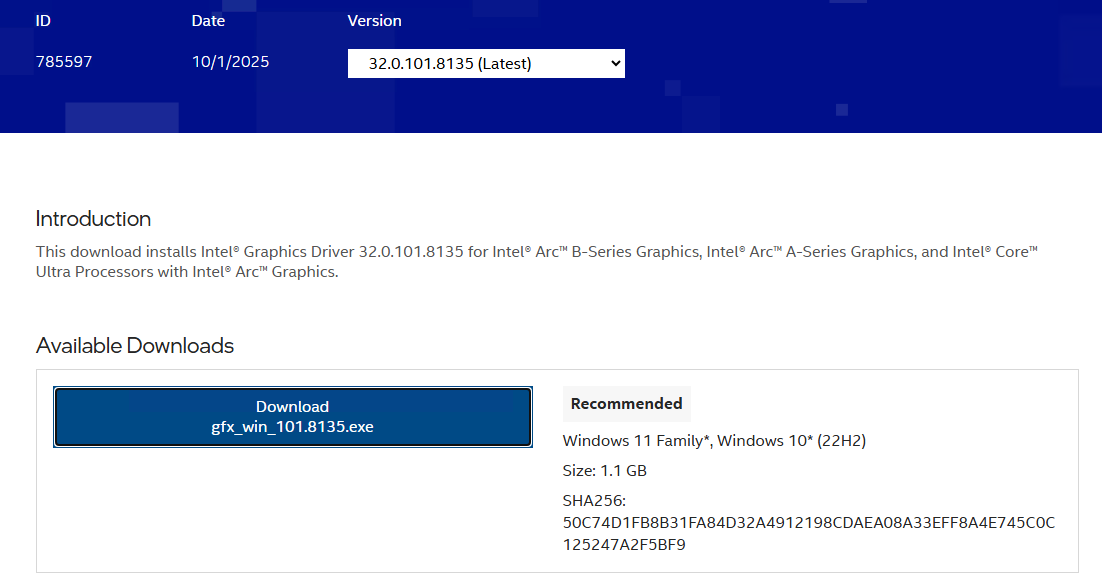

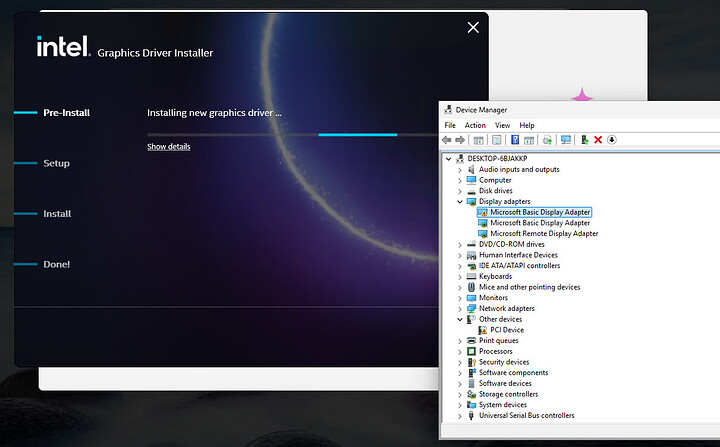

The 2025-10-1 drivers seem to have some bug that causes windows 11 to crash before login and RDP not to work (immediate log out/explorer crashes).
… so you need to start with this older driver and see how it goes.

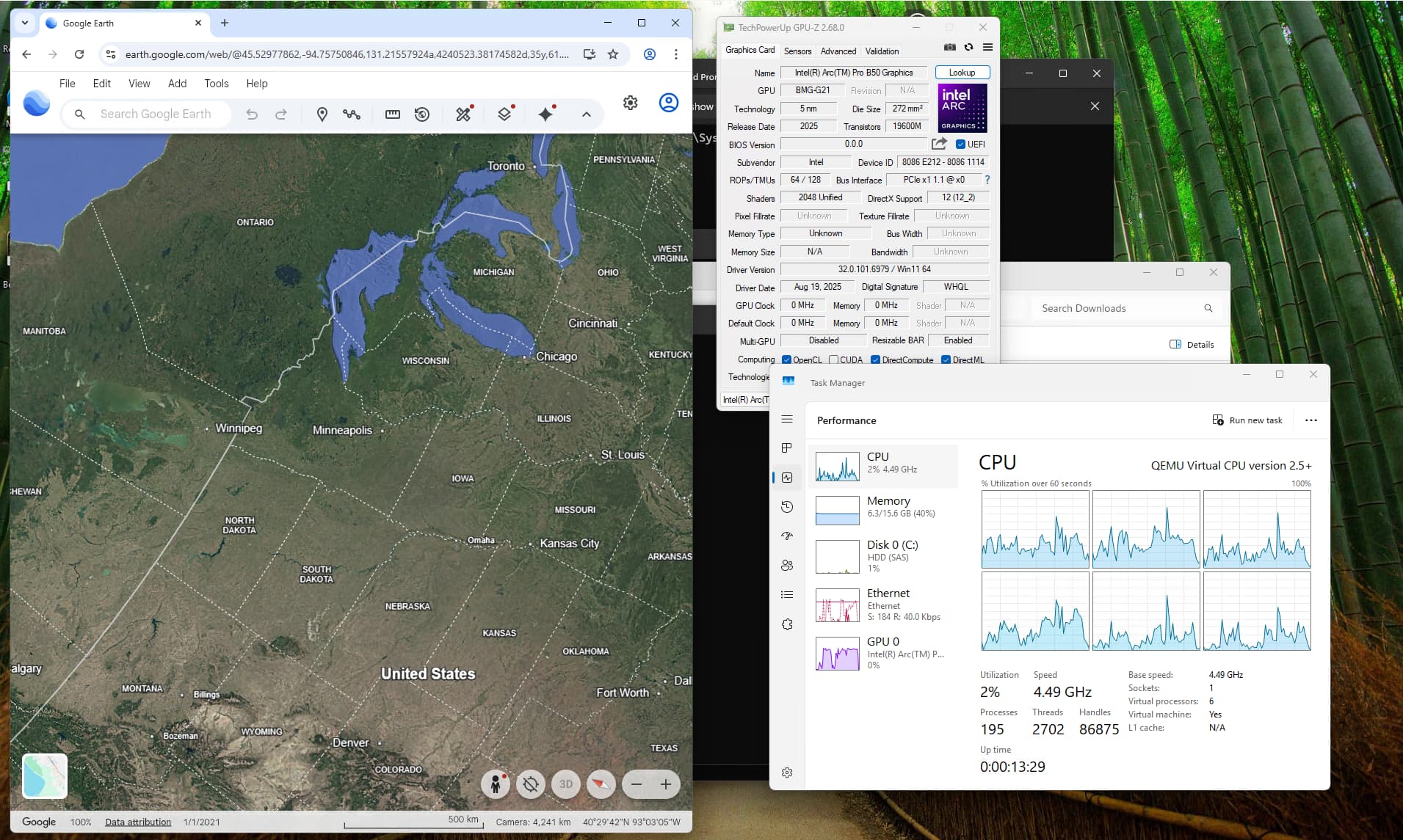

These drivers are confirmed working (albeit … somewhat beta). Note I recommend you setup your B50 in a stand-alone windows machine and install this driver. It has a firmware update bundled in the driver. Firmware can’t update on vfio stubs:

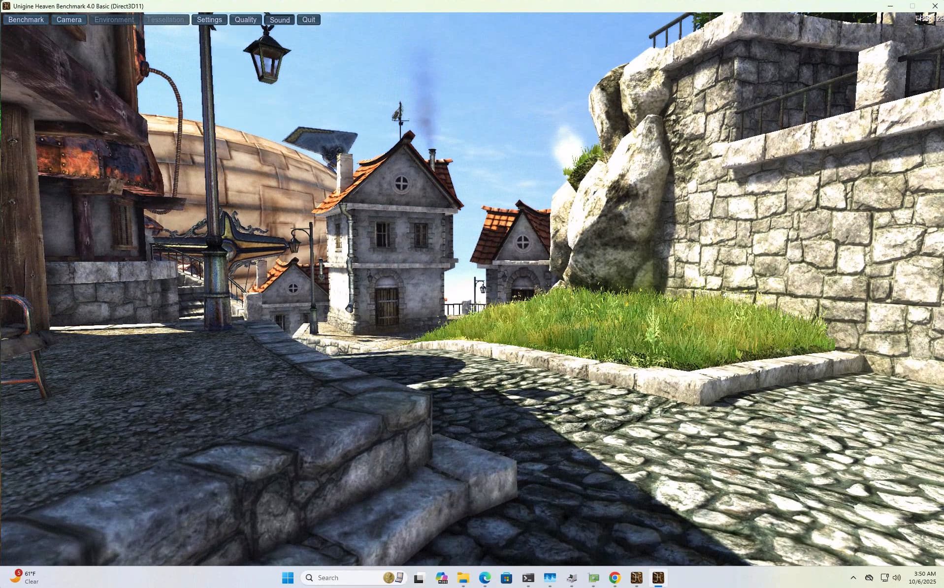

… and then finally check out that sweet tasty gpu accelerated RDP session:
all gpu utilization, no cpu utilization dragging around the virtual earth thingie.

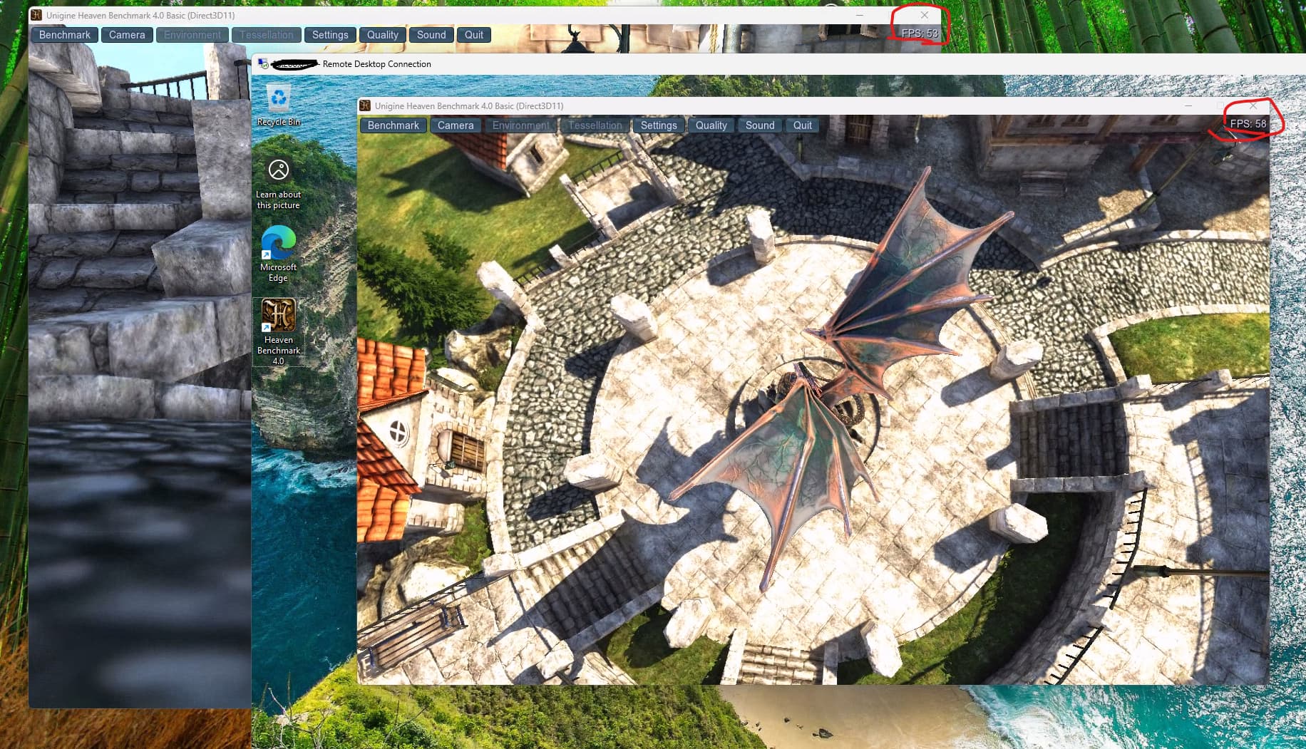

heaven: at ~~150+ fps
the performance can be very inconsistent running heaven, for example. from 20 to 150fps, especially when running lots of copies of heaven at once.
but this is quite promising.

this will sound insane, but download the heaven benchmark and run it (not full screen mode) in RDP.
then drag it halfway off the viewport. see if htat dramatically improves the frame rate.
then drag it back. And see if the framerate stays improved.
gdb seems to show this switches from unaligned memory copies to… aligned memory copies. its the difference between 20 and 140 fps.
if you run two instances instead of 4 you should get 8gb per instance. How that’s working is a bit weird. On the flex170 cards you had to explicitly specify ahead of time how you wanted to do things in order to get consistent behavior.

I tried what you suggested, the FPS counter in the heaven benchmark shows between 60-100 fps or so, but the RDP graphics is slow and choppy. Even if I move the window half way outside the viewport. I tried this with the full GPU forwarded, not using SR-IOV.
My RDP client is Remmina, maybe a real Windows RDP client would be better, but I don’t have any WIndows machine in the office right now.

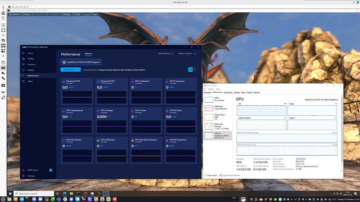

Just weighing in, I set this up tonight on a test box and I am blown away by how dead simple this is and how well it works. I Installed Windows, updated to the September Arc Pro driver to get the firmware, erased that and installed Proxmox 9, installed the required kernel and patches, rebooted, then located the device using lspci -t, poked the appropriate sriov_numvfs , and immediately the functions were enabled and visible in the Proxmox gui. I created a mapping for them called “b50-pro” then I pulled four VM images from my PBS server, including two prod jellyfin servers, assigned the b50-pro pcie device to all four machines and let it rip.
No crashes, which was a great sign, I then installed the same September Arc pro driver in all four machines, and it didn’t even require a reboot to start working. Jellyfin media transcoding is just… working perfectly out of the box and providing H.264 40mbit → AV1 20mbit encoding at 250fps. This is better than the A310 or the A380, at half the power consumption. Under SR-IOV!
This is astoundingly good. The entire process took less than an hour, including the 300gb worth of VM backups I had to pull. I did not have to change any system settings, I didn’t have to fiddle with VFIO, override kernel parameters, I didn’t even need to stub out the xe driver, proxmox just, as Wendell puts it, “Does The Right Thing”.
