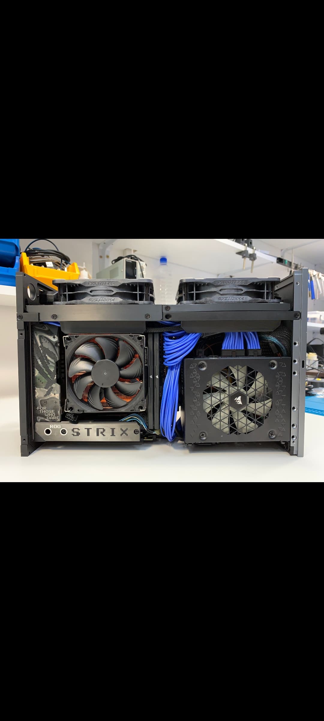

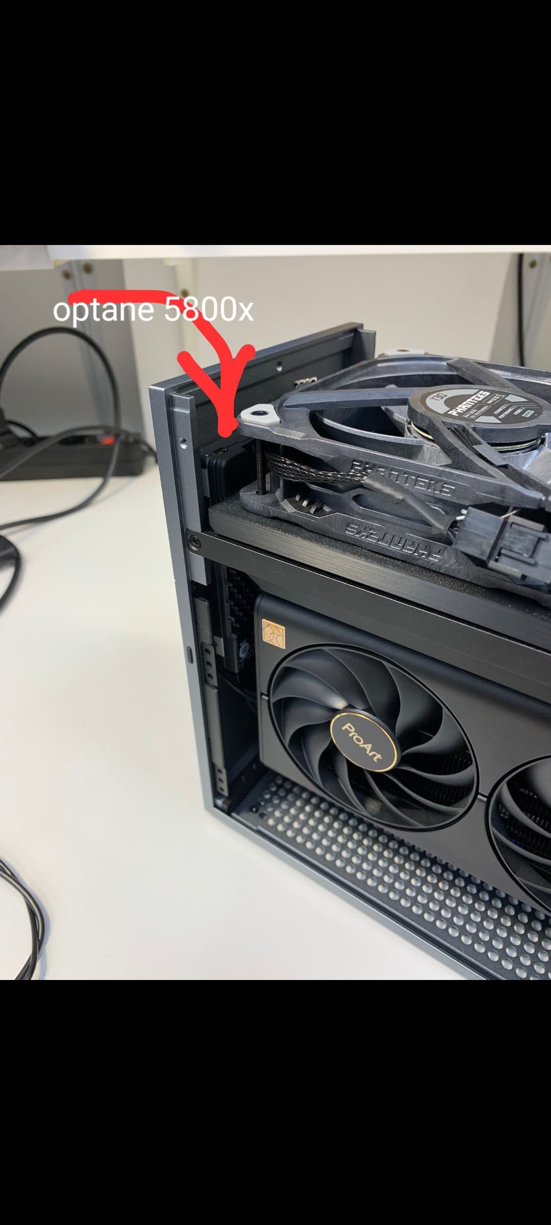

This is my Build:
Rtx 4080 Super
Amd ryzen 7950x3d
Asus x870 i
Corsair vengeance 96gb
Optane p5800x 400gb
Samsung 990 pro 4tb
I watched Wendell clips and he mentions a lot optane in combination with primocache,in order to get full potential
My plan is to have Windows installed on an optane p5800x 400g (C drive optane 200gb where will be windows) and D drive 200g optane,F drive 4tb 990pro,my goal is to have the fastest Windows response, Google Chrome and the fastest boot time possible

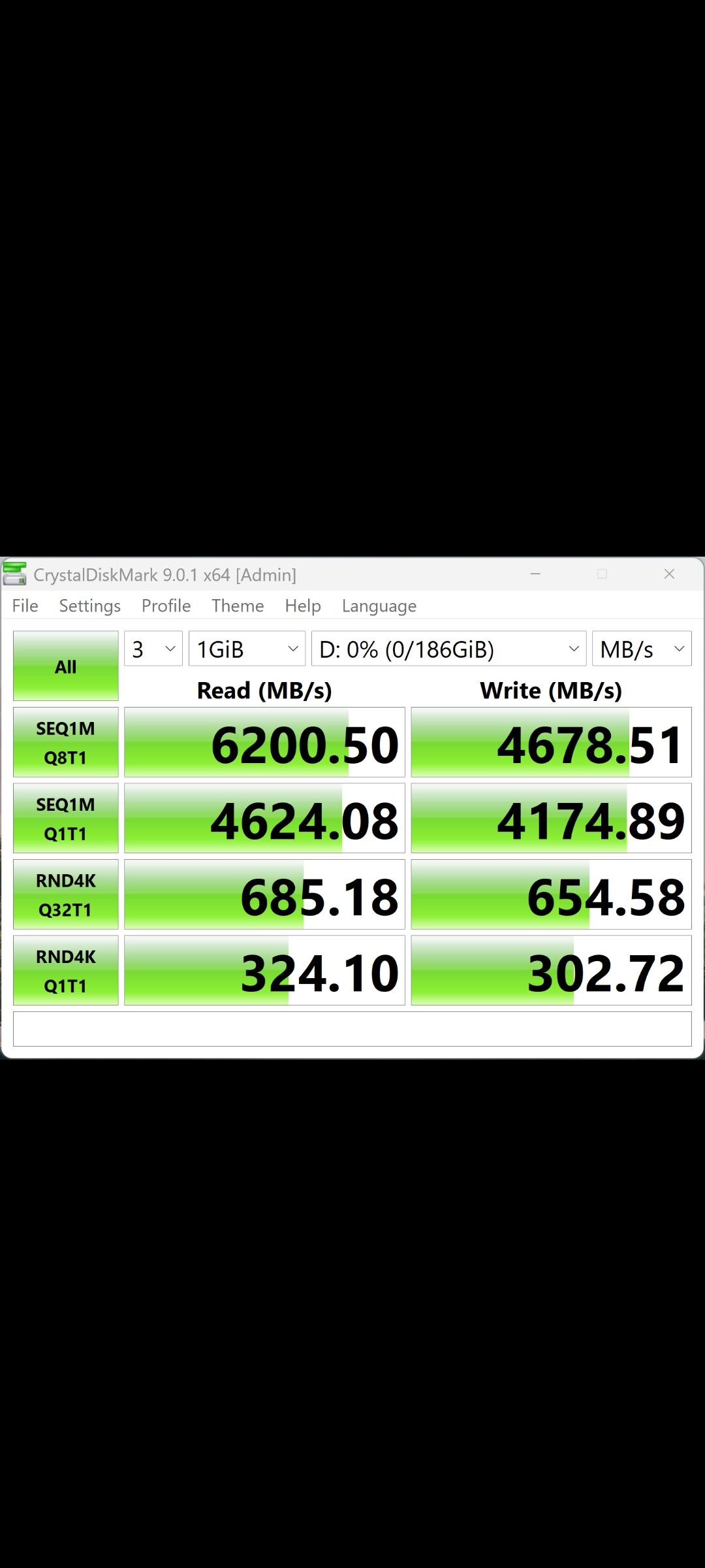

I’m interested in how you feel about this speed, is this normal for optane p5800x,I read somewhere that Intel is underperforming and that the firmware needs to be updated.
just looking if everything is set up as it should be to get the maximum out of it
Hi!
The underperformance issue got solved.
My issue was using 3 Samsung 970 Pro 1TB SSDs in RAID-0.
Though the Optane was not part of the RAID-0 array, somehow it was affected by it.
(The OS was installed on the Optane).
In order for the 3 SSDs to be seen as one large pool, some boot-start drivers had to be installed at the Windows setup.
Those drivers affected my Optane.
Later on, I’ve deleted my RAID-0 array, and when benchmarking my Optane SSD, the random transfers jumped to almost double!
