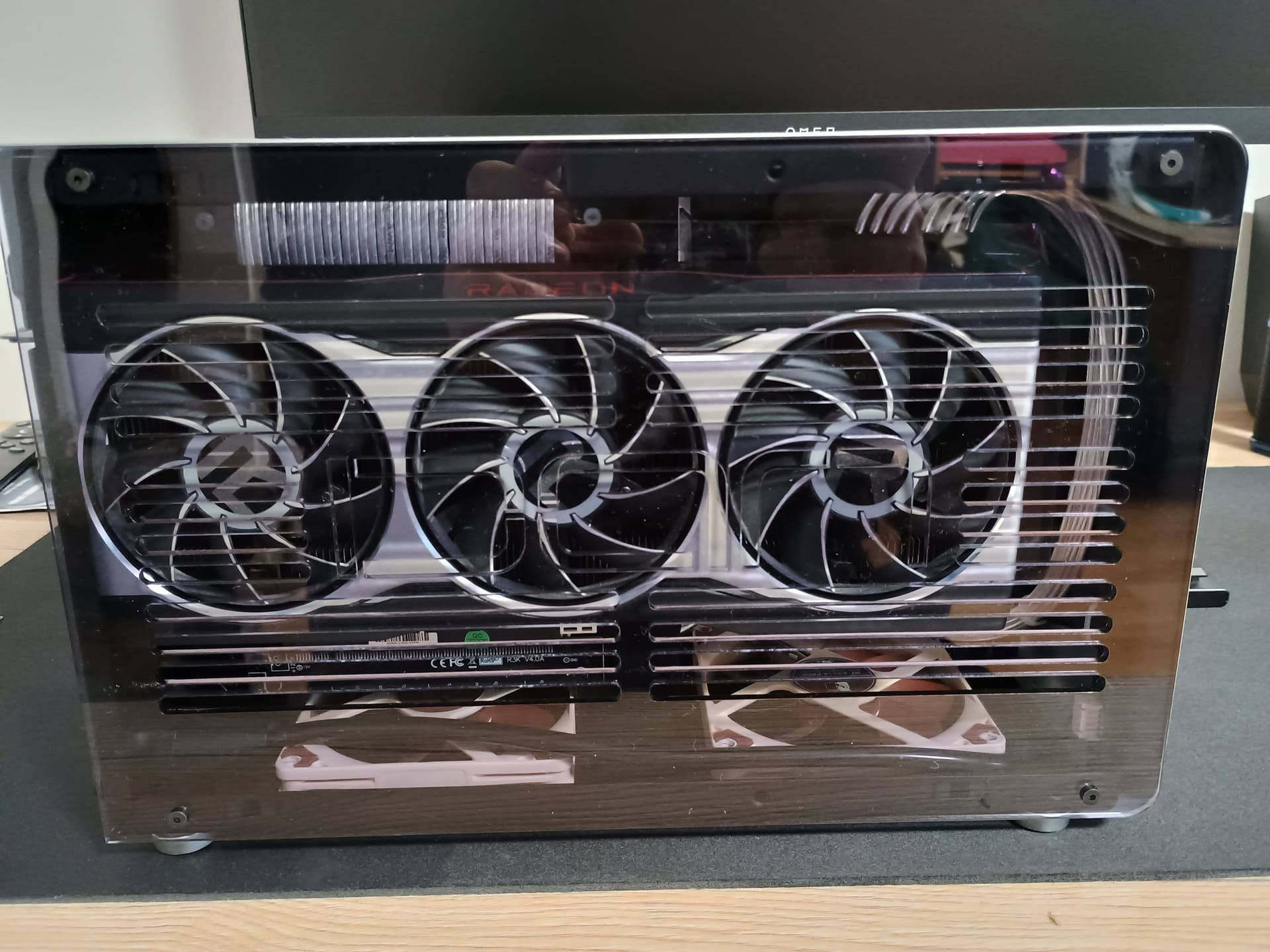

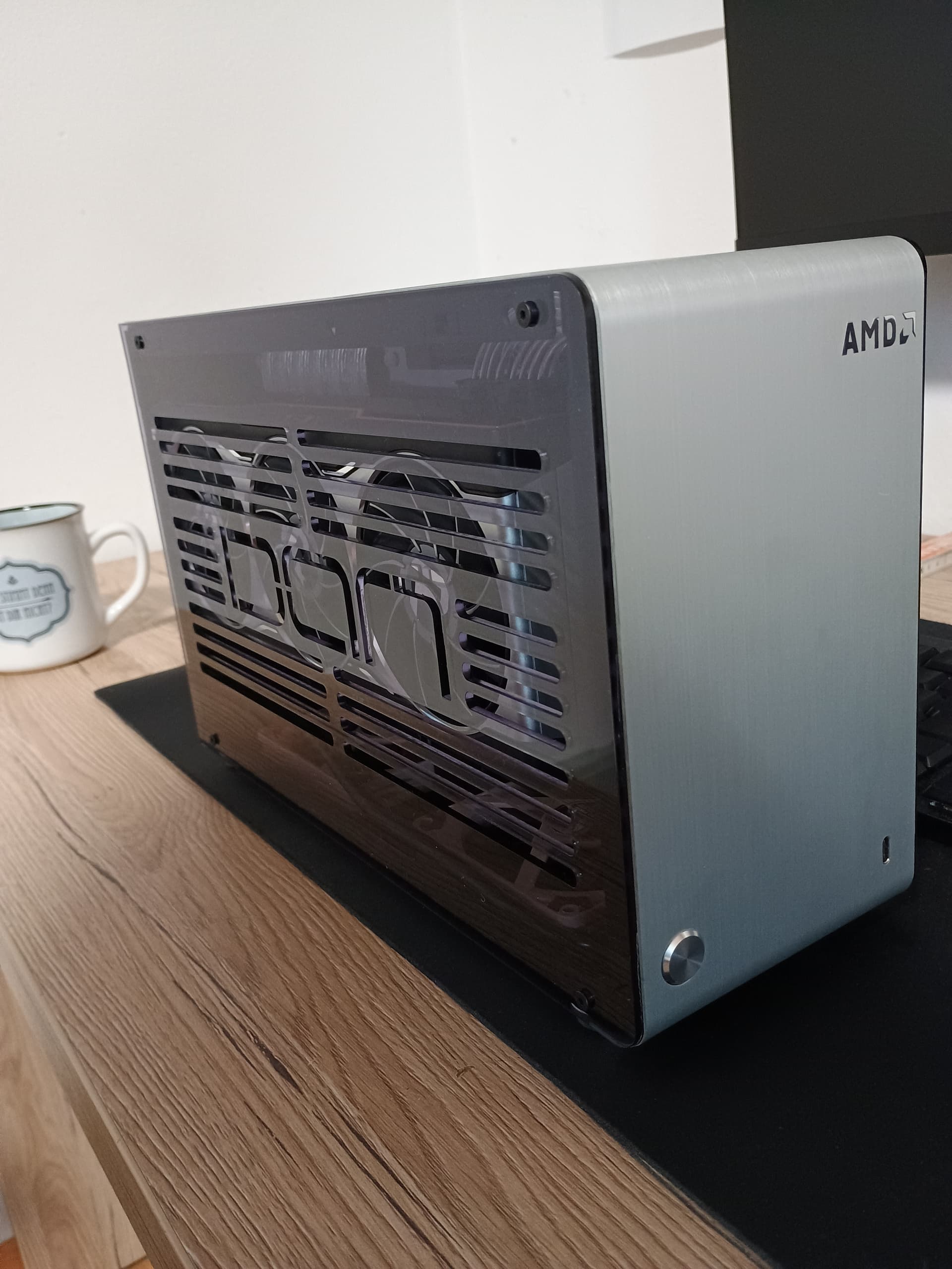

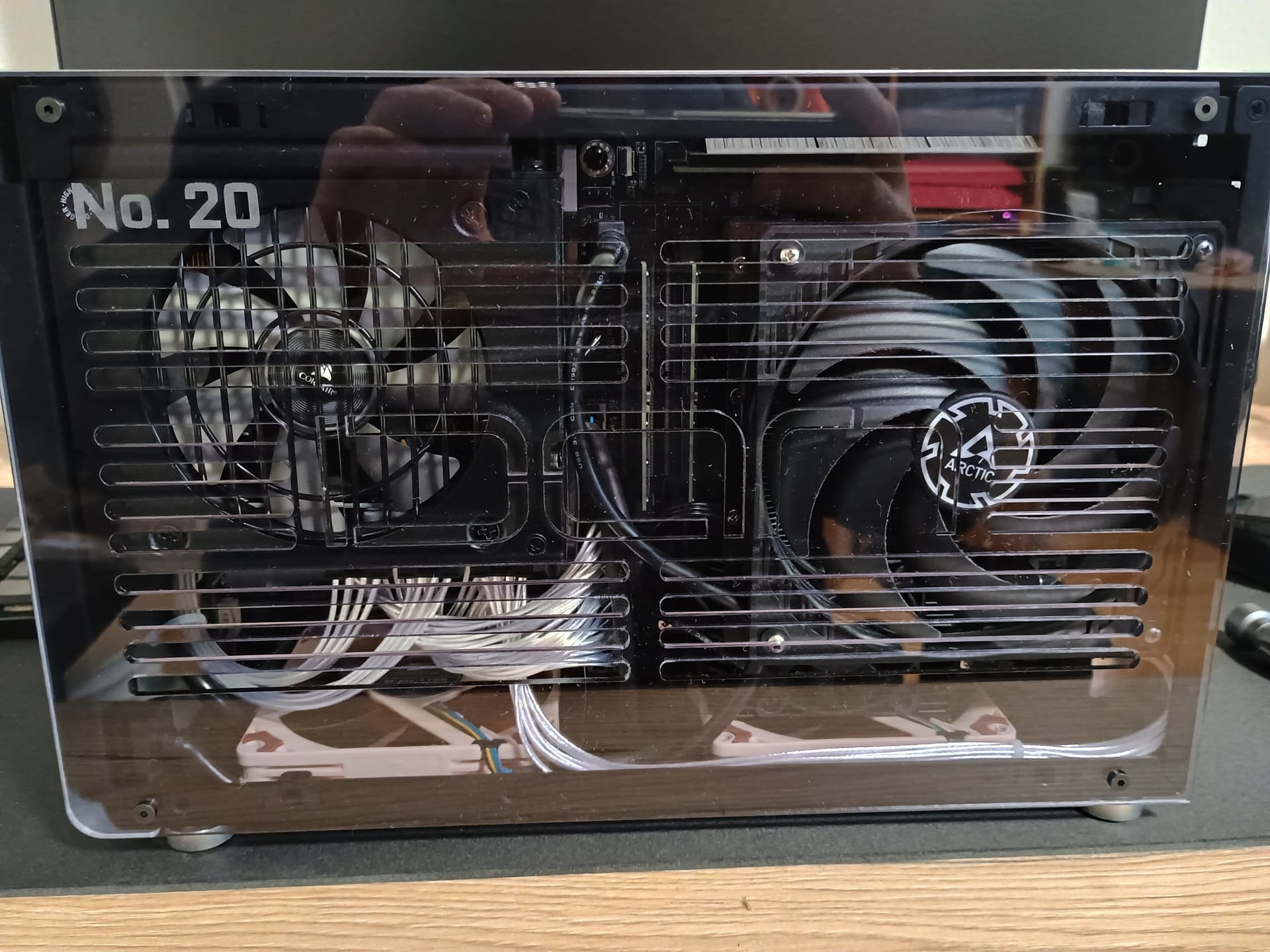

Btw my Build is finally finished. :smiling_face_with_three_hearts:
