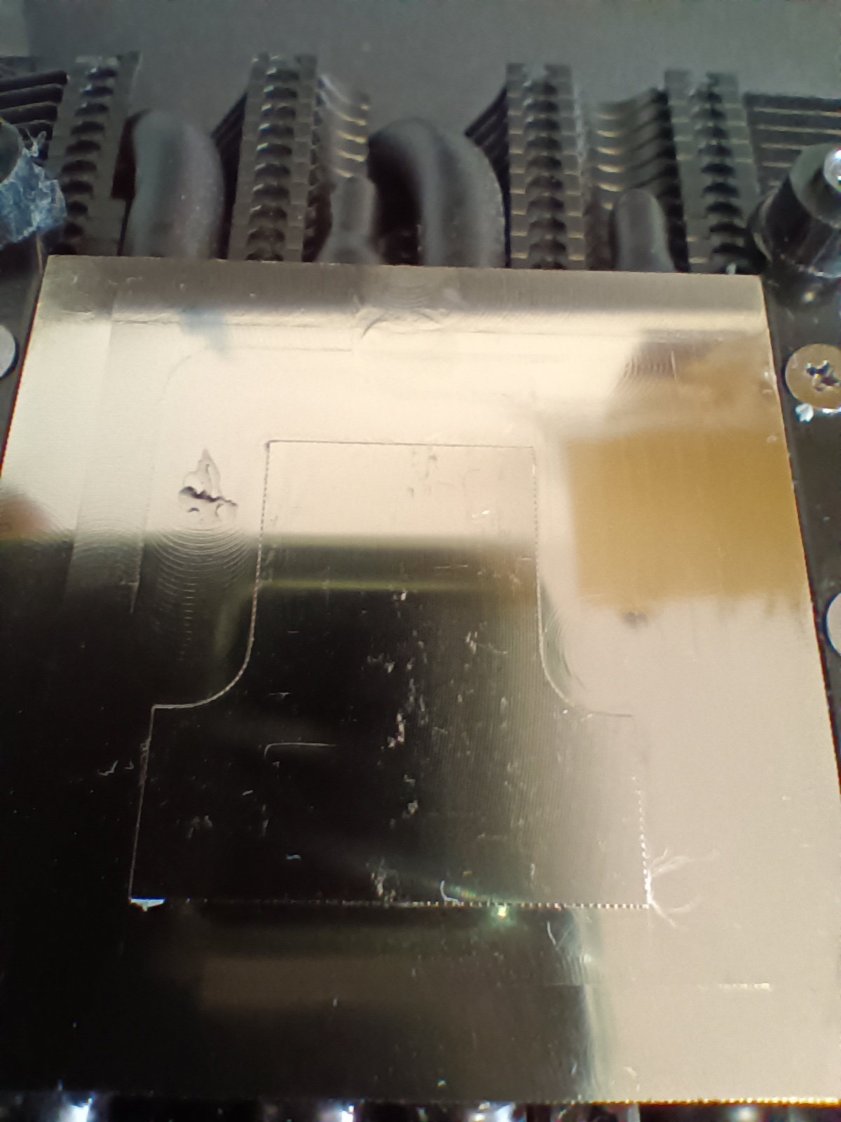

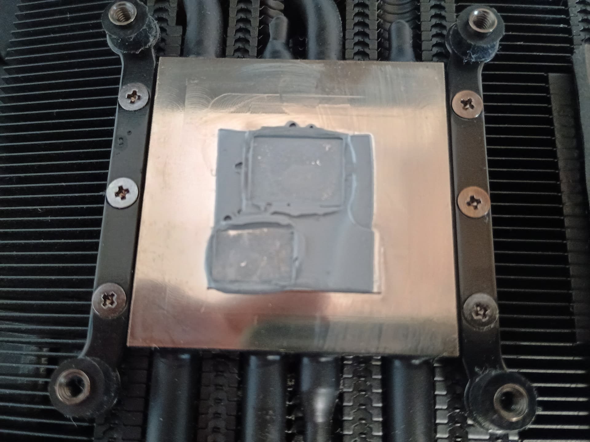

Because someone in another Thread called the TIM “Birdshit”… its actually a Phase Change Pad - thats not bad at all. Just control the Screws on the Bottom from Time to time or just apply new Locktide on em - mine had come loose and killed the good Temperatures.
