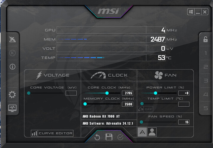

booted quickly into windows and installed MSI afterburner. Seems about the same (3 monitors; 4k, ultrawide 1080p and 1080p) as linux.
