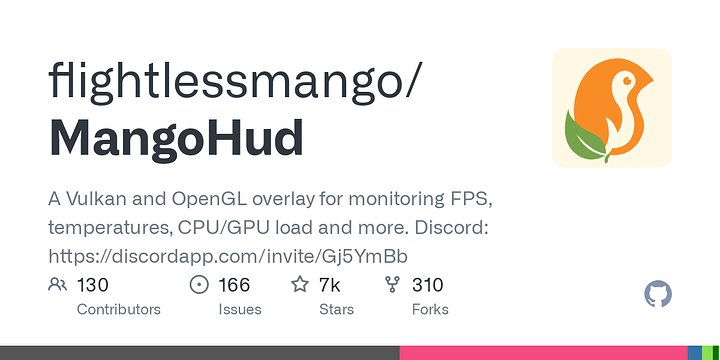

So I suggested following MangoHud configuration editing to make a profile for game you’re having issue with and cap the fps, via Mango. Set display hz to 144hz if you can (with 120 fps cap) if you can. If you can’t set your fps cap to 110-118.
Ok, I don’t know how to configure Mango. But I guess I can set the screen refresh rate to 165 and then limit fps in games to 120Hz?
Yes, that would work too. But keep in mind that fps limiters are software and thus one can be better than the other. Not saying you can’t use in-game caps but just keep in back of your mind, try experiment see which one feels smoother; MangoHud or the game’s cap. Some games don’t have a cap, others don’t allow you to turn off a cap (have to choose a fps to cap).

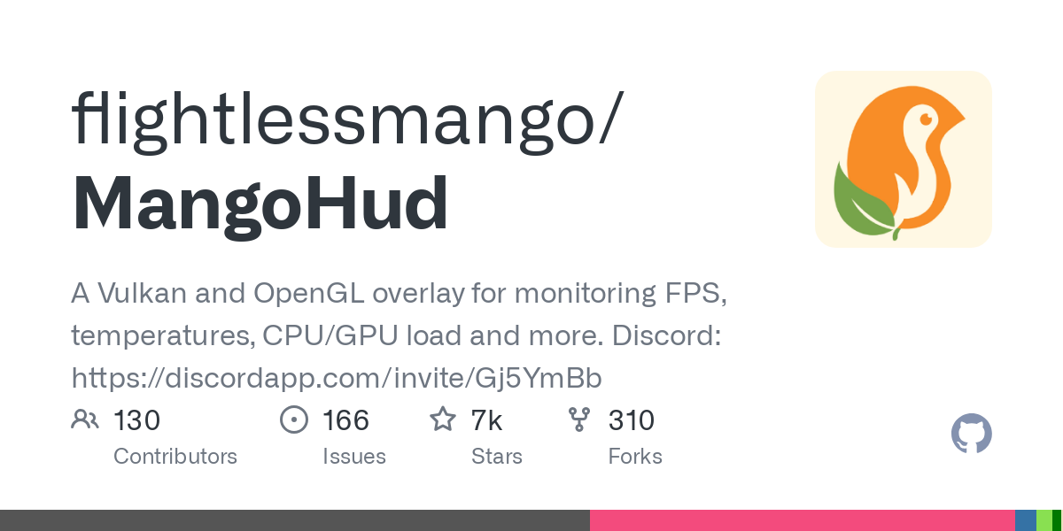

But just in case you may need to cap your fps and the game has none or a bad one. Go here to MangoHud github:
  1. Go to “Hud configuration” part
  2. Follow the #2 “Per-appication configuration” instruction
  3. If game you want to create specific MangoHud profile for is native you follow i. If it’s with WINE/Proton you follow ii.
MangoHud global and game specific (native or Proton) profiles are located at: ~/.config/MangoHud/
If you’re not familiar ~ is your user’s home location.
Try set a specific profile up, I will help you if you need.
Thank you.If Mangohud does it like rivatuner, then I would rather do it with the program. I know inquisitor martyr does not have built in fps limit.
MangoHud is supposed to be a replacement for Afterburner (including rivatuner), even though it may not have all feature sets rights now. You can log your fps and upload csv file to here and get frame time and fps graph for analysis of your hardware and game performances. MangoHud is a must. Github page has all the info on rest of features of it.
It worked. It kept the games at 120Hz even with the screen set to 165Hz and vsync off. Will test to see if I get tearing in obs recordings, still thank you.

Right, so far the FPS limiter works great, I have have a question.
There is a function that allows for multiple FPS limits. The example they give is (0,30,60) where 0 is unlimited if you don’t run vsync.
Adaptive sync counts as no vsync so if I add that example, I just get unlimited FPS…
What do I type in that FPS limit field, if possible, to have it run at 120FPS. If it can’t make that target, step down to 60FPS or even worse 30FPS?
0,30,60,120 would give toggleable options of unlimited, 30, 60, and 120 using Shift+F1 to swap between them. Not certain but you may be able to order it as 0,120,60,30 so each press from unlimited would reduce the cap.
Oh no. Man I hoped it would work like triple buffering did with WoW back in the day. It would step between 60 fps and 30 fps depending on how taxing the game was. Oh well. Thank you anyway.
