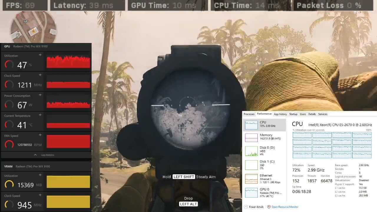

Here’s Warzone, same inadequate CPU

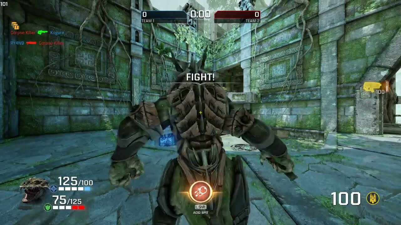

Quake Champions works out pretty well on this level of hardware.
