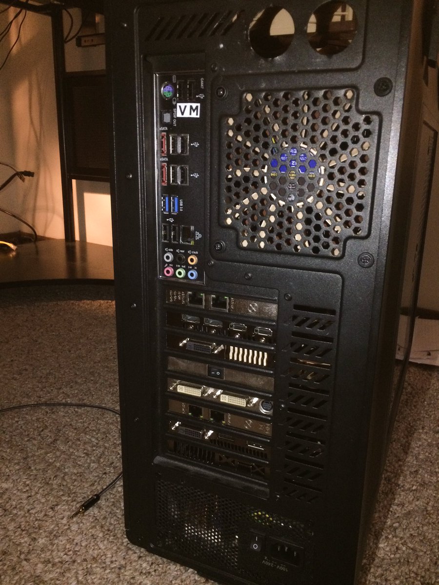

I am a developer of many things and I use a wide range of software and operating systems. I primarily use Debian as a hypervisor and often run Linux, Windows, MacOS, and occasionally more obscure operating systems as guests. I do everything from graphic design, PCB design, 3D modeling, game/operating system/software development, I compile a lot of software that takes upwards of 30 minutes on my current configuration. I also occasionally play and test games in a Windows 7 or 10 VM.
Current system:
  • CPU = 5.057 GHz AMD FX 8350. Actually 100% stable, like uptime of 3+ months and only reboot for kernel patches stable.
  • Motherboard = Gigabyte 990FXA-UD3 (crying for mercy)
  • GPU1 = Nvidia GTX 1070
  • GPU2 = Nvidia Quadro something-or-other
  • GPU3 = AMD RX 560
  • NIC1 = Intel 82576 (Ethernet card 1)
  • NIC2 = Intel 82576 (Ethernet card 1)
  • NIC3 = Intel 82576 (Ethernet card 2)
  • NIC4 = Intel 82576 (Ethernet card 2)
  • NIC5 = Realtek 8169 (onboard)
  • Audio = Realtek ALC1150 (onboard)
  • 1x Marvell 88SE9172 SATA controller (eSATA) 2x ESATA drive docks for formatting drives / installing OSes (onboard)
  • 1x AMD SATA controller 2x Samsumg 840 EVO SSDs (onboard)
  • 6x AMD USB 2.0 controllers (2x ports each) (onboard)
  • 1x VIA USB3.0 controller (4x ports) (onboard)
  • PSU = Seasonic 1000w 80+ platinum
What I require in a platform:
  • Absolute stability, random freezes or reboots due to random hardware / BIOS bugs are unacceptable.
  • Lots of PCIe connectivity, in my current machine I have 2 add in Ethernet cards and 3 graphics cards which I use vfio and a modified version of QEMU to hot plug to/from my various virtual machines.
  • A platform that can handle hot plugging PCIe cards with out power cycling them with out stability issues.
  • 8 minimum physical cores. (preferably 10+) having only 8 cores is a bit of a struggle for me, right now I have to use scripts to allocate CPU cores between the VMs based on their load and activity. I would like to be able to have more cores so I can just dedicate cores to some of my VMs and not worry about having enough left over for basic tasks.
  • Minimum of 32 GB RAM, I currently have 32 GB of 1866MHz DDR3 and its just enough, barely. This is one of the major factors for me not upgrading my platform, 32 or 64 GB or DDR4 is way to expensive.
  • Perfect or near-perfect IOMMU support /grouping, every device must have its own IOMMU group. my current motherboard is amazing for this, even devices like an Ethernet card with multiple NICs on one card have each NIC in their own IOMMU group. My current board also has each of the 7 USB controllers in separate IOMMU groups, the SATA controllers are also isolated.
  • Half decent onboard audio as I will not have any available expansion slots for a sound card and would rather not use a USB DAC.
  • Low latency virtualization, my current setup can manage 250 microseconds (0.25ms) total latency in ultra high FPS games like osu. I am using no virtualized devices, vfio passthrough for everything (NIC, GPU, USB, disk, audio, etc.) to achieve this.
  • Decent IPC, does not have to be the best but I do like to enjoy high FPS gaming from time to time and the FX 8350 is struggling a bit in new titles, it can be hard to stay above my monitor’s 90hz refresh rate. Funnily enough my Windows VM has better IPC than Windows installed on a native FX 8350 due to the staggered coremask I am using. The VM has 4 cores but each core has access to a different cache module instead of 2 cores sharing 1 module. My Windows 10 VM Cinebench r15 single core score is 130cb with this setup.
  • OS agnostic hardware control. Overclocking, fan control, etc. must be preformed by onboard hardware and configured in BIOS utility so it works not matter what OS is running. I don’t want to have to write a Linux driver to turn off the default-on RGB LEDs on a motherboard like I had to do in the past. Or the most egregious one, having to write a fan control driver because my crappy HP laptop requires a Windows only driver to control the CPU fan or it will be stuck at 10% and let the CPU overheat (facepalm)
  • Onboard internal serial header.
  • Dual onboard Intel NICs would be nice, I may be able to eliminate an add-in card then.
