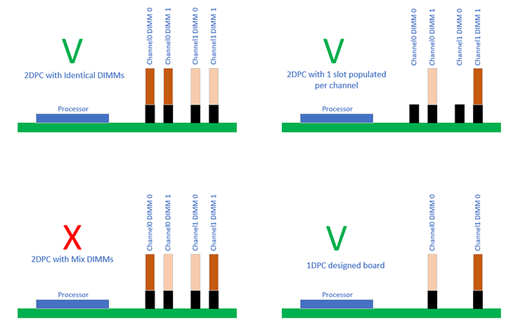

2DPC with Mixed DIMMs means two different DIMM part numbers are populated in each memory slot within a single 2DPC channel (see bottom left image).

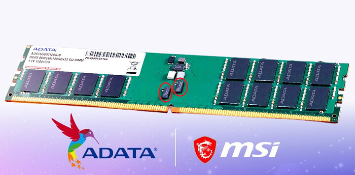

Looking at the poster for it, it would seem they are doing something unique. I see two separate CKDs on the DIMM which is unusual:
I also got the impression these might be designed to only work in 1DPC as well, even though they didn’t explicitly say it… still might be a boon for people with 1SPC boards that want to run 256GB at as high of a frequency as possible.
