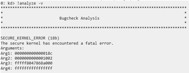

  • Windows crashes with 0x18B - SECURE_KERNEL_ERROR- However, that’s not the true reason. The actual reason lies on Arg1:
  • There was a crash because of 0x18C - HYPERGUARD_VIOLATION. In particular Arg2 states that this crash was due to HYPERGUARD_VIOLATION_PAGE_HASH_MISMATCH_1002_IMAGE_win32k.sys.

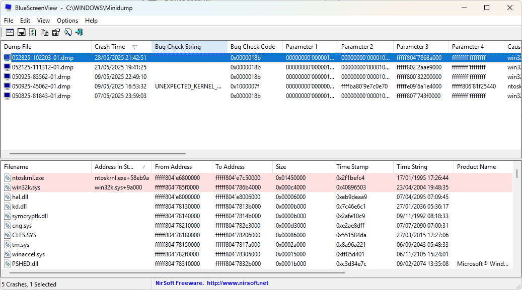

  • Just like BlueScreenView reported - there was corruption on the memory loaded from win32k.sys and that’s what caused the crash. However, what is actually causing it?

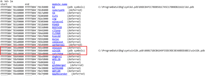

  • Looking at the contiguous memory section tells me nothing, as these belong to other Windows drivers:

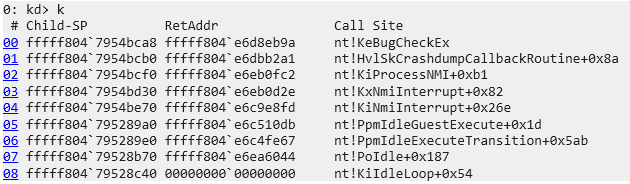

  • But what about the stack? It just states that it crashed while being Idle.

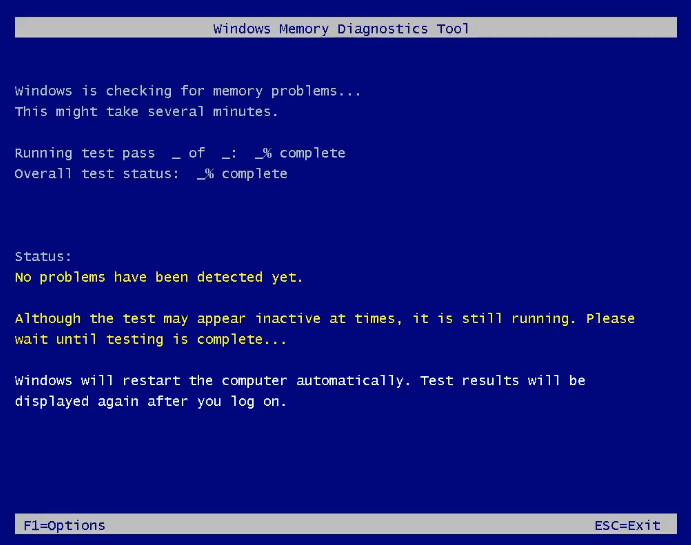

Running Windows Memory Diagnostics and boy I think the RAM is not good:
This is the first time ever I’ve seen the tool displaying something too egregious like this.
Swapped the memory banks around and now it’s failing quicker! :slight_smile: I am so glad I doubled down on a new set of RAM banks yesterday.
