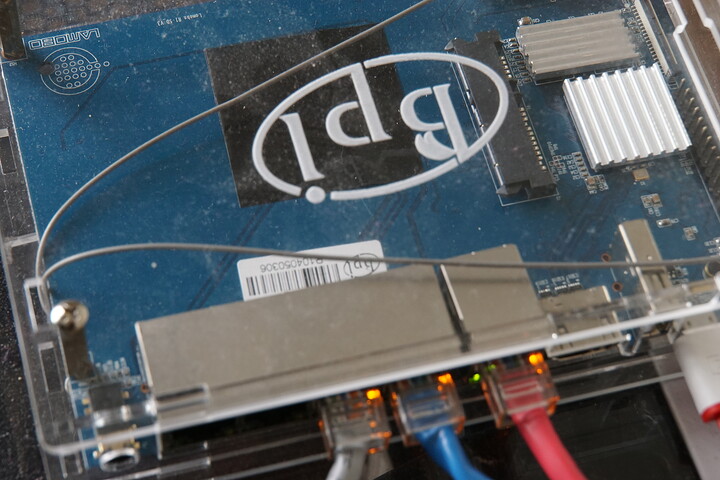

I separate out mine, Netgear APs and a custom router; old Intel Atom I bought off eBay forever ago (had to figure out how to install Linux on it using only a serial port interface).
Any modern mini-pc should work if you’re comfortable setting up all your iptables rules manually. I’ve used the following for ~2 decades and they still work perfectly (rules are half way down the page):
IPv6 took some work, but it was still doable, and it’s neat understanding at a low level how routers and firewalls actually work:
