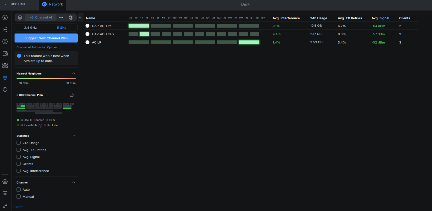

unifi has channel AI that can auto-scan and optimize
Indeed it does.
I am not including Unifi among my “consumer devices”. Unifi is much better than the consumer stuff. Not quite as good as the likes of Ruckus, but still an order of magnitude better than the consumer routers of the world.
