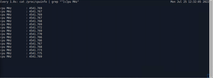

Here is the literal screenshot of the CPU frequency in MHz as reported by the command watch -n1 "cat /proc/cpuinfo | grep \"^[c]pu MHz\"".
Notice that you have to go to the second decimal place before you’d find a difference, thereby providing the data and the evidence that does not support the statement you made above.
That does not appear to be true in my case.
If your statement were true, then you should expect to see a discrepancy in the CPU clock speeds due to the turbo boost behaviour of the processor, but said discrepancy in CPU clock speed is wholly absent from the picture above.

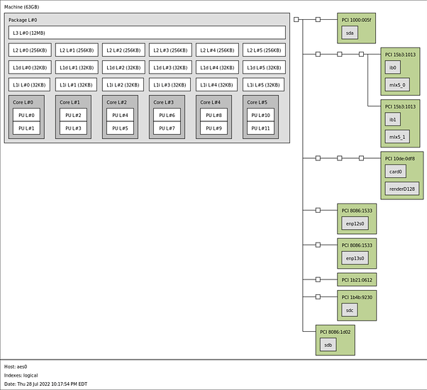

Below shows the output of lstopo -l with the output written to a png file for my 5950X (I re-enabled SMT for this picture, and then turned SMT back off afterwards):
Note the logical groupings of the logical processors.
(And for reference, here is the output of lstopo -l for an Intel Core i7 4930K:
Again, note the logical arrangement of the cores.

As I’ve said before, I enabled SMT to generate the lstopo picture which shows the logical layout, which conforms to the AMD technical documentation/specification, as published, by AMD.

And yet, the output from lstopo from my 5950X system (where I purposely enabled SMT to be able to take the picture, and then turned SMT back off again so that I can run my simulation), LITERALLY tell you how the APIC ID/CPUID is assigned LOGICALLY (as explained to you by the linux man page itself, and also from the OpenMPI FAQ page re: hwloc.)
The lstopo output tells you that core16-core31 is NOT the virtualised core and yet, you REFUSE to accept the ACTUAL data which EXPLICITLY shows and proves that your statement is wrong.
