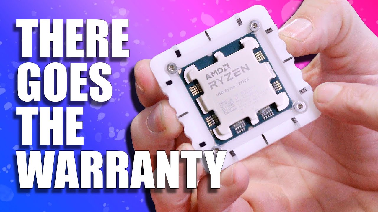

Ryzen 7000 is really hot because they made the IHS dumbass thick to maintain cooler compat, which means higher temps
You can delid, or sand down the IHS a bit to improve thermals
