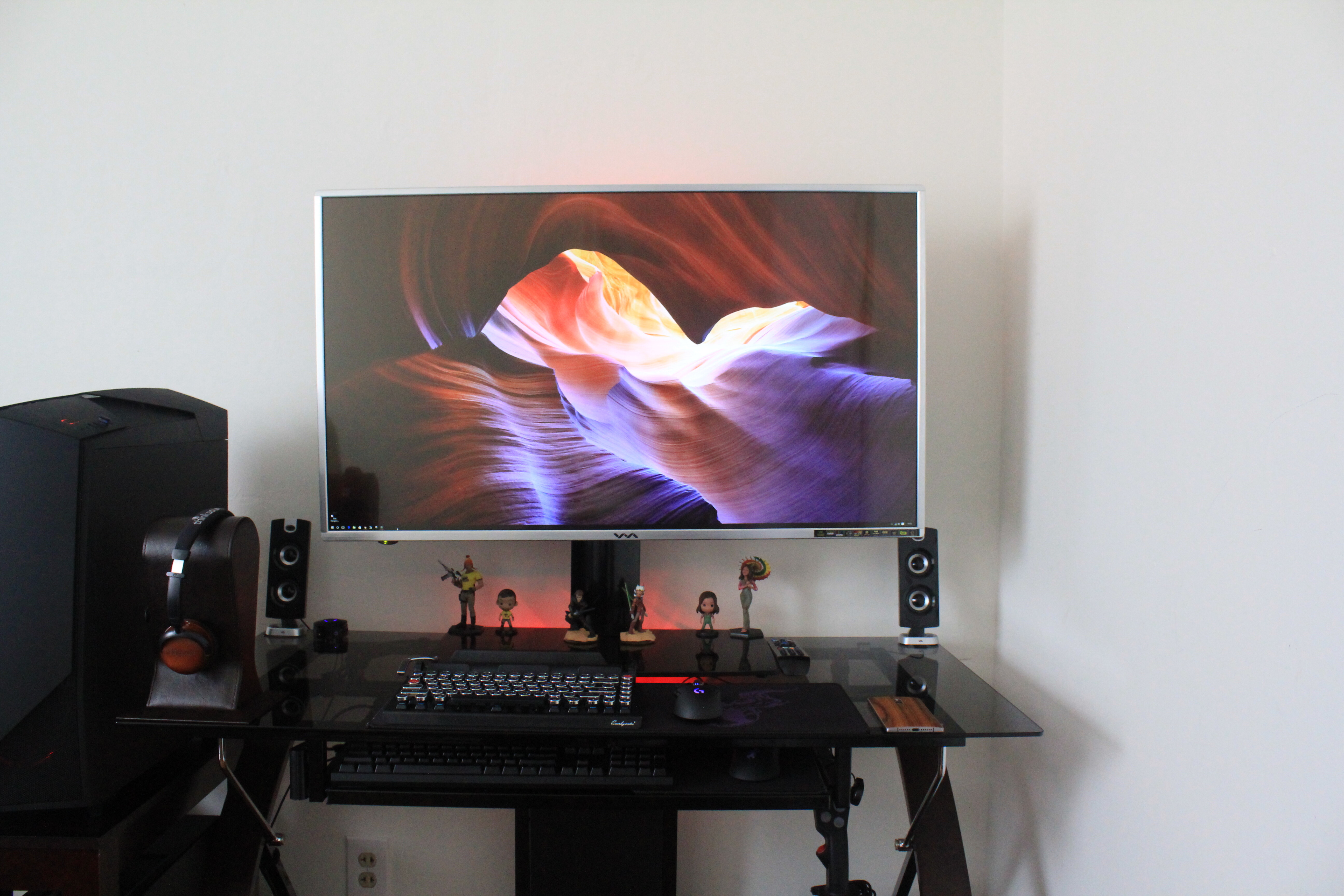

I know, this is a really trivial matter but the one thing that bugs me about my UHD430 is the logo on the bezel being off-center from the separate stand that I bought for it. Now to be fair, it might be the stand's positioning in relation to the logo, but my ex imparted her brand of OCD on me so it's one of the first things I see. :-P
I plan on removing that logo once I get my review stuff together but until I do, it's glaring right at me lol:-P

My final setup:
If you have any questions regarding the monitor, feel free to ask them and I will try my best to reply.
